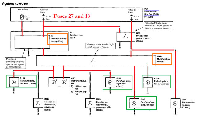

The truck listed above is a super duty. has no brake lights or rear turn signals. Is there any way you could help with a wiring diagram for this? This way i can trace down the wires and hopefully locate the issue. Please and thank you.

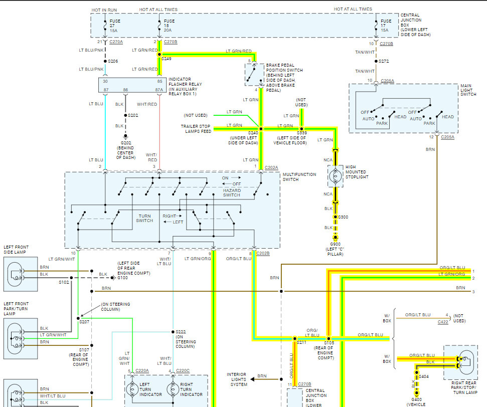

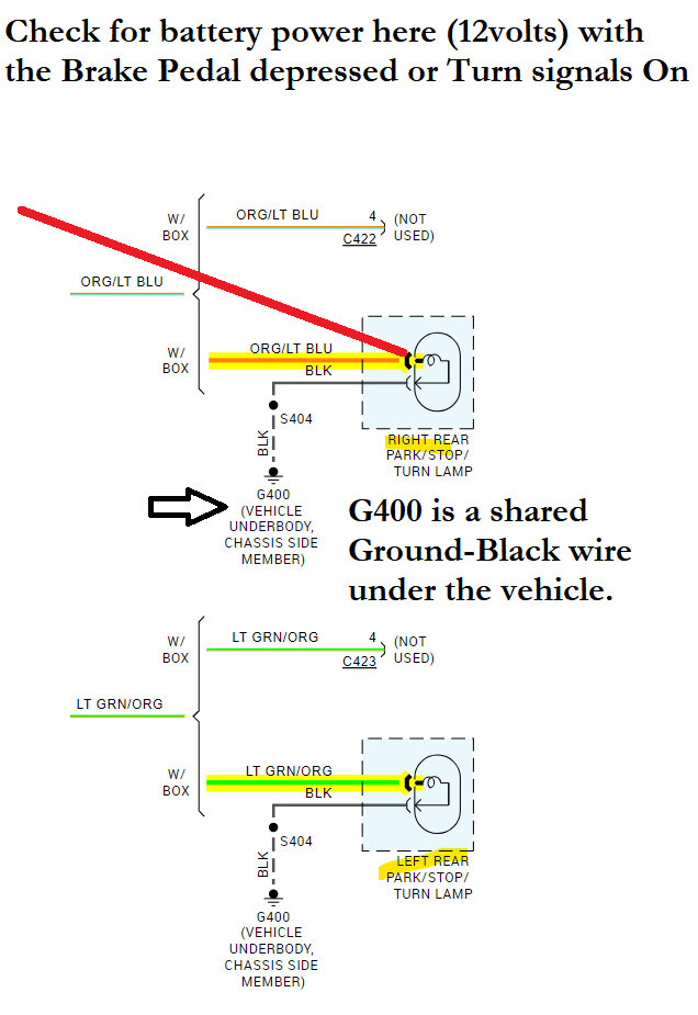

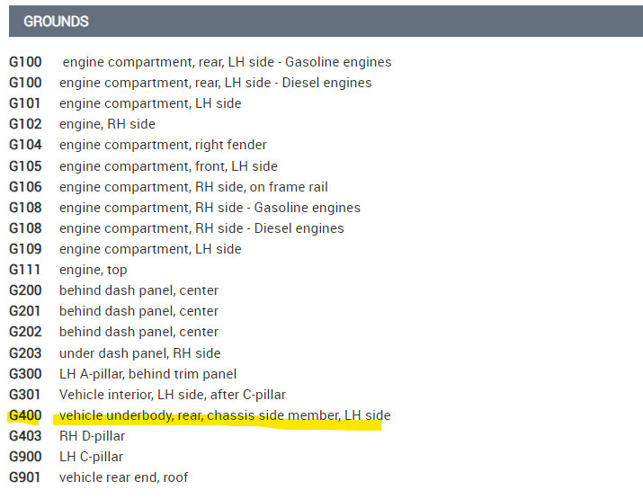

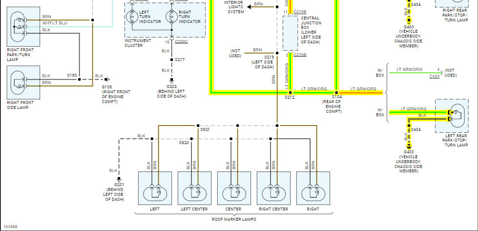

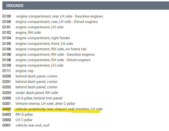

Hello, sorry for the delay, have you been able to check for power back at the Brake Lamp sockets? The Brake lamps and Turn signals share a Ground, G400, which looks to include the side marker lamps in the rear, are those working?
There are a couple variations on design, but they basically work the same, Power for the Brake lamp circuit comes through the Brake pedal switch, it then branches off to the 3rd brake lamp (high center lamp) and also to the Multifunction Switch which is for Turn Signals, Hazards and the Brake Lamp power normally goes through the switch when there are no Turn Signals or Hazards on. If the Turn signals are On, power comes from the Indicator Flasher Relay. and is sent out on the same wires to the rear Park/Stop/Turn Lamps.
So, if the Center High 3rd Brake lamp works but the other right and left do not, the issue can be a bad Ground in the rear. An issue with the multifunction switch or wiring in between.
So, checking for power at the Brake lamp socket is a first check. If there's power there, then it's a Ground issue, if not then it's an issue with the wiring or switch.

This is the basic operation of how power travels the rear lamps, for Stop/Turn lamps.
