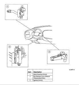

Hi mistero, Welcome to 2carpros and TY for the donation There's no adjustment the combo switch has to be replaced
https://images.2carpros.com/forum/automotive_pictures/12900_combo_switch_ford_1.jpg

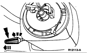

Removal Remove the ignition switch lock cylinder. NOTE: The steering wheel has been removed for clarity.

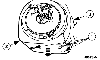

Remove the upper and lower steering column shrouds. 1 Remove the screws. 2 Remove the lower steering column shroud. 3 Remove the upper steering column shroud.

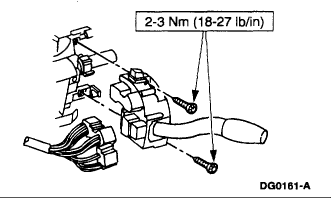

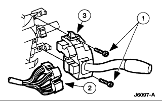

Remove the multi-function switch. 1 Remove the screws. 2 Disconnect the electrical connectors. 3 Remove the multi-function switch. Installation
https://images.2carpros.com/forum/automotive_pictures/12900_f4_1.gif
To install, reverse the removal procedure.
