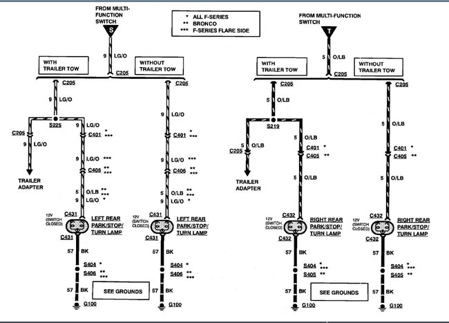

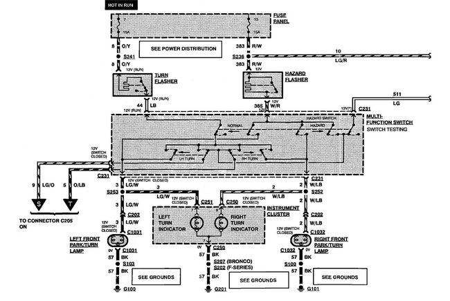

I have no brake lights, turn signals or hazard lights FRONT OR REAR. The parking lights DO work front and rear. The turn signal switch, flasher unit and ignition switch have been replaced and all fuses and bulbs have been tested. The dash indicator bulbs also do not flash or come on and stay on like if a bulb was out. Nothing. I do have power too the hazard switch, and like I say, it has been replaced. Bulbs are all good. HELP!! I have no wiring diagram. Any ideas would help me TONS!!! Thank you so much!!!!

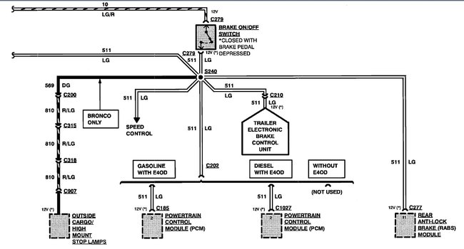

Lets start with checking the brake lights. At brake switch, check if you have battery voltage at Light Green/Red wire. If yes, disconnect the connector and use a jumper to bridge across the terminals. If brake lights comes on, the brake switch is bad.

Wiring diagrams fro the turn signal circuit are attached below
