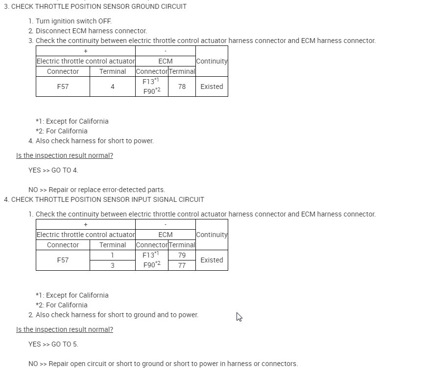

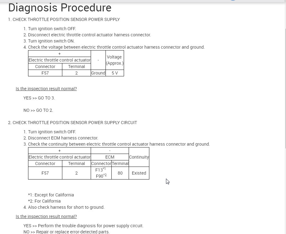

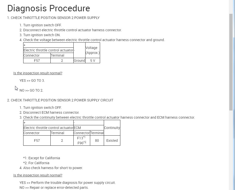

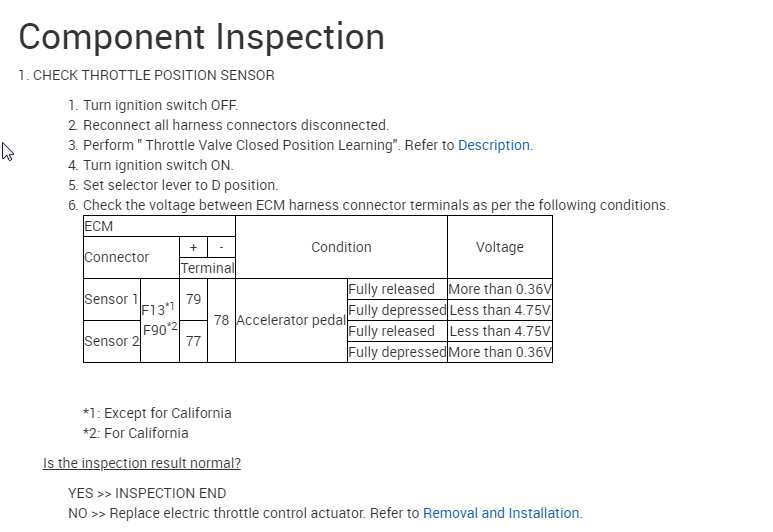

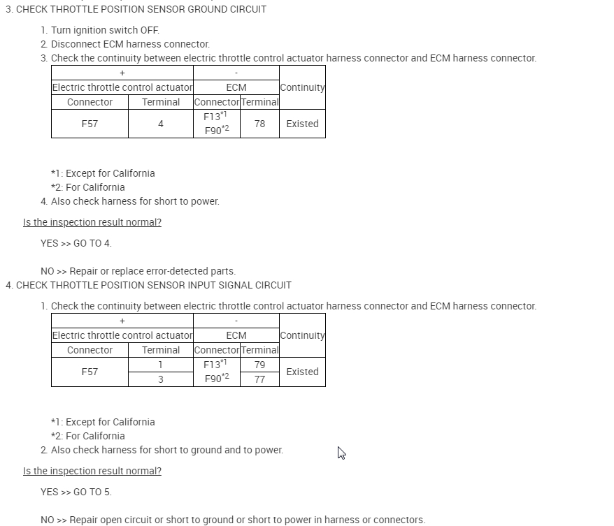

My car sounds fine when I start it. But the check engine light and trac light are on. Switches From P and Rand D just fine. But when you try to accelerate the rpm won't hit 2,500 no matter how much I push the pedal. It doesn't jerk or make any unusual sounds.
Aug 5, 2019 at 10:04 PM

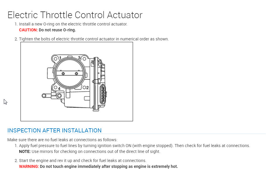

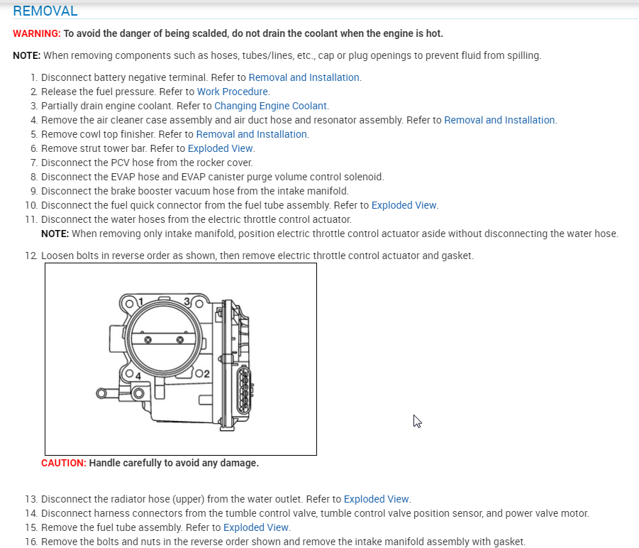

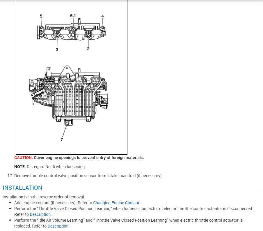

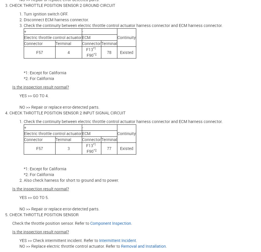

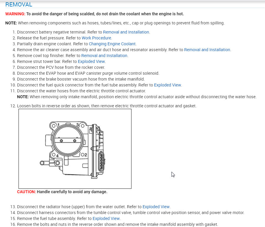

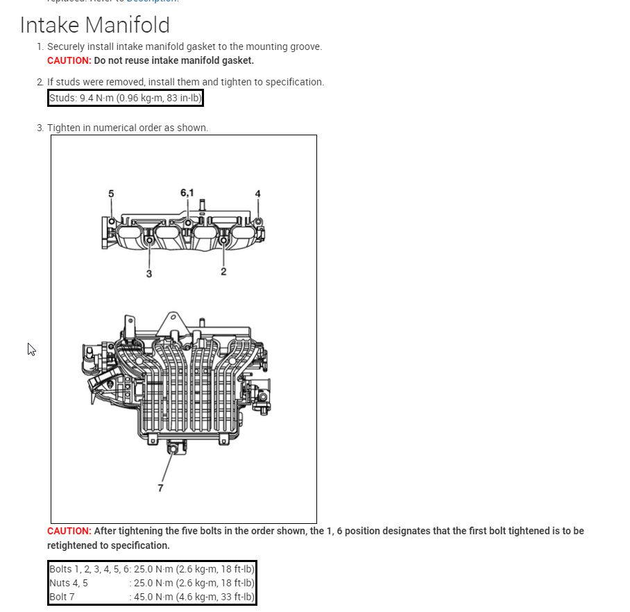

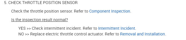

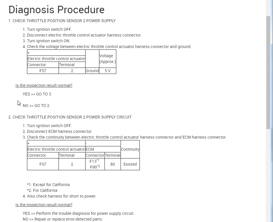

These codes are for your throttle position sensors. You may just need to replace the throttle body which has the sensors included. I attached the tests and procedure on how to do this.
Please let me know if you have questions.
