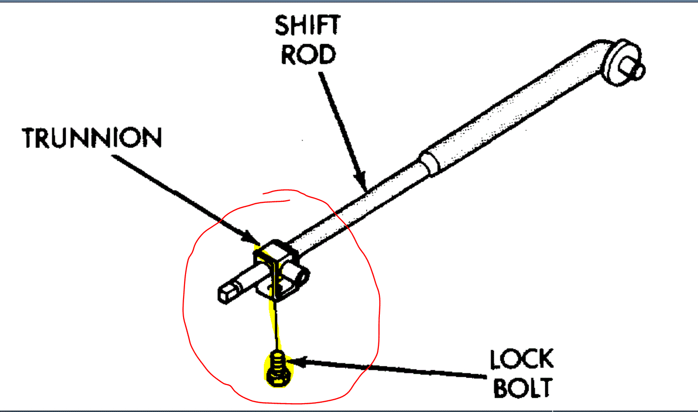

There is an adjuster on the shift linkage. Are you certain the bolt that sets it after adjustment isn't loose or allowing the linkage not to fully move the shift lever on the transfer case? Have someone shift the transfer case through the different selections while you watch to see if there is an issue with the adjuster. If the bolt is loose, it will allow the shift rod to extend and retract, so it may not fully be going into 4wd. (See pic 1)
Also, the transfer case itself doesn't rely on vacuum.
Let me know what you find.
See pic below.

The tag on the transfer case says ND231 HD. I have checked the linkage and had other people check it as well, the bolt is tight, and it moves the shift lever on the transfer case through its full range of motion. I have even disconnected the linkage and moved the shift lever on the transfer case directly with the same results, no power to the front axles and I confirm there are no noises coming from the transfer case. What if the nylon pads on the shift forks have broken off, could that be a possibility? When I replaced the front axle actuator and linkage it did work fine at first but then just stopped working. I have not been off roading with it just used the 4WD for snowy days here.

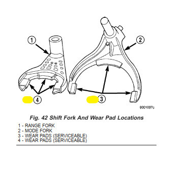

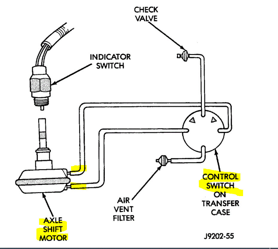

Now, a front-axle disconnect system is used to achieve two-wheel-drive mode. The axle disconnect vacuum motor is actuated by a vacuum switch on the transfer case. The switch is operated by the transfer case range rod. Are you certain that it isn't stuck in 2wd at the switch? You indicated the front axle is working properly, correct? See pic 1 below. I realize you have a vacuum, but it should change at the supply hoses at the axle actuator when you go from 2 to 4wd. Is that happening?

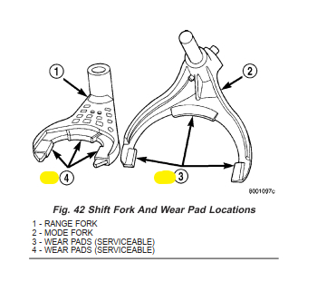

Also, which nylon shift forks are you referring to? Do you mean the ones in the transfer case? See pic 1. If that failed, you would feel little or loose restriction when shifting it. I would think that anything mechanical in the transfer case would be making noise in some way.
See pic below.

I have not had a chance to check the vacuum lines, it has been too cold to be laying out in the snow. I would assume though that they are working fine seeing as my front axles do lock and the 4WD indicator lamp does light up, which means the actuator is working correctly. The pads I mentioned are the one on the shift forks themselves, made out of nylon/Teflon? or something like that. The wear pads I believe they are called. If they are worn out or broken could that be a cause? (see pic).
Jan 20, 2022 at 10:28 AM
  • 110,244 POSTS
If they are no longer connected to the gear packs, yes that would prevent the engagement. If they are bad, you should see evidence in the fluid when draining it. Have you drained the fluid yet?

Hello again. Well, I finally fixed my 4WD. The issue was the 4WD Vacuum Actuator. The shaft seal of the actuator failed and so the whole actuator filled up with gear oil. The shaft still moved enough to engage the switch to illuminate the dash light but just not far enough to get the collar to lock the axles together. The gear oil prevented it from moving a complete distance. So, the good news is that I do not have to open up the transfer case :) but the actuator was not cheap either. :( Just wanted to let you know and thank you for all your help on this issue. I really appreciate it. Have a great day.
