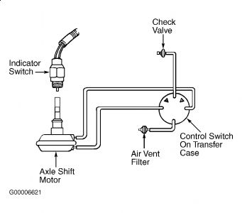

2CARPRO JACK
  • 11,533 POSTS
Heres the vacuum diagram for the t-case controls.Be sure it is all hooked up properly
https://images.2carpros.com/forum/automotive_pictures/1639_dodge1_2.jpg

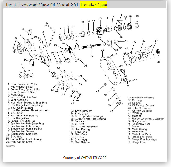

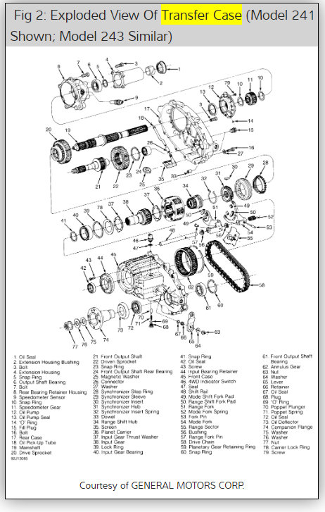

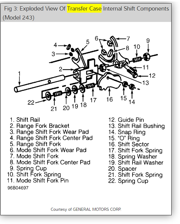

  • 54,837 POSTS
It sounds like the shift fork bushings have worn not moving the fork completely. here is an exploded diagram so you can see what I am talking about. I would see if you can manually move the shift arms to see if you can get it to work. Check out the diagrams (below). Please let us know what you find. We are interested to see what it is.
May 11, 2021 at 12:28 PM (Merged)

Thanks so much for the insight, much appreciate it. That does make sense. Just to be clear, are we talking about the mode fork, part number 49 or the range fork, part number 53 in the first image, 231 transfer case? I would guess the mode fork but want to be sure. I will tearing it apart this weekend and will let you know the results. Thanks again.
  • 54,837 POSTS
When you have it apart look at both forks I would replace all plastic ride retainers if they look worn or brittle. Can you please shoot a quick video with your phone so we can see what's going on, that would be great. You can upload it here with your response.

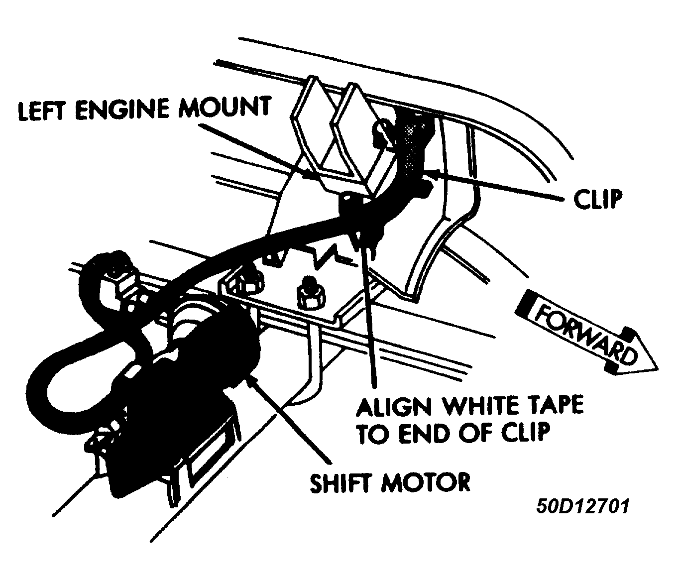

I have a 1998 dodge ram 1500 4x4. Has 5.2 in it automatic.the 4wd isn't working but the front drive shaft spins. Also, it don't seem to have the power it should. I've replaced the plugs, cap,and button and its still the same. It seems to miss bad when it goes uphill.
  • 75,992 POSTS
Is the light indicating at 4WD? Scan the TCM/Computer for code/s if any present post them-
Check vacuum at axle shift motor
AXLE SHIFT MOTOR FUNCTIONAL TEST
Raise and support the vehicle. Disconnect the vacuum harness from the axle shift motor and connect a vacuum pump to the vacuum shift motor front port. See Fig. 2 .
Apply 15 in. Hg (51 kPa) of vacuum to the front port and rotate left front wheel to fully disengage the inner and intermediate axle shafts (i.e., shift to two-wheel drive operation).
The shift motor should maintain the vacuum applied to the front port for a minimum of 30 seconds. If the motor does not maintain the vacuum, replace it. If the motor does maintain the vacuum, proceed to the next step.
Disconnect the vacuum pump from the vacuum shift motor front port. Connect the vacuum pump to the vacuum shift motor rear port, cap the port for the 4WD indicator lamp switch, apply 15 in. Hg (51 kPa) of vacuum to the rear port.
The shift motor should maintain the vacuum applied to the rear port for a minimum of 30 seconds. If the shift motor does not maintain the vacuum, replace it. See AXLE SHIFT MOTOR under REMOVAL & INSTALLATION. If the motor does maintain the vacuum, proceed to the next step.
Remove the cap from the port for the 4WD indicator lamp switch. If vacuum was present, the shift motor is functioning normally. If vacuum was not present, go to next step.
Apply 15 in. Hg (51 kPa) of vacuum to the shift motor rear port. Rotate the left front wheel as necessary and ensure that the inner and intermediate axle shafts are completely engaged. The axles must be completely engaged (i.e., shifted to 4WD operation) to open the port for the 4WD indicator lamp switch.
Determine if vacuum is present at the port for the 4WD indicator lamp switch again. If vacuum was present at the port, the shift motor is functioning normally. If vacuum was not present at the port, replace the shift motor. See AXLE SHIFT MOTOR under REMOVAL & INSTALLATION.
Connect the vacuum harness to the shift motor. See VACUUM HOSE ROUTING . Remove the supports and lower the vehicle.

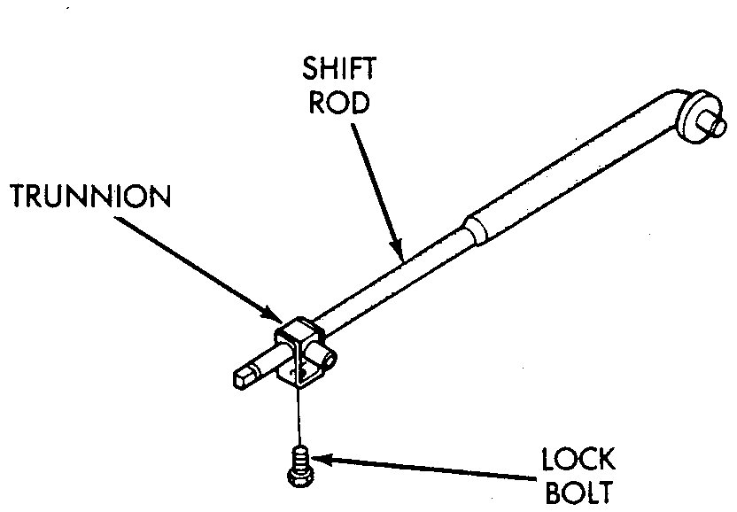

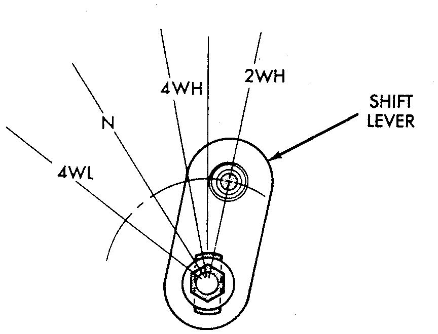

Most often, the shift linkage between the shifter and the transfer case either comes apart or comes loose and goes out of adjustment. That is where I would recommend you start.
Park on a level surface, place the parking brake on, place the vehicle in park, and block the wheels so the vehicle can't move. Craw under the vehicle and locate the transfer case. Locate the linkage (see picture 1) and conform that it hasn't come disconnected on either end (held in with a plastic clip on both ends) and make sure the adjuster bolt didn't come loose allowing the linkage to move without changing the transfer case shift lever.
If you find the linkage has come off, you can purchase just the plastic clips or you can purchase the entire linkage aftermarket.
Here are the adjustment directions:
______________________________________________________
ADJUSTMENTS
1. Move shift lever into 2H position.
2. Raise vehicle.
3. Loosen shift rod lock bolt at trunnion.
4. Check shift rod fit in trunnion. Be sure rod does not bind in trunnion.
5. Verify that transfer case shift lever is in 2H position.
6. Tighten shift rod lock bolt to 10 Nm (90 inch lbs.) torque.
7. Lower vehicle.
8. Check shift linkage operation. Be sure transfer case shifts into and operates properly in all ranges.

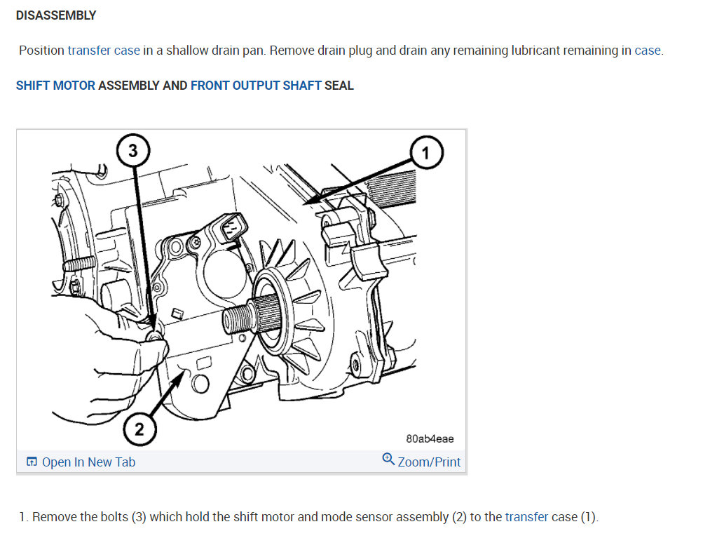

the transfer case actuator motor should fix the problem here is a diagram below to show you how to replace it.

Hi, I own a 1997 Dodge Ram 1500 W/ a 5.9l 360 and a dana 44 axle. My problem is the 4 Wheel drive will not engage, the transfer case engages and the front drive shaft spins but the wheels do not. i just replaced my actuator or "automatic vacuum shifter" cause all the signs pointed to this. it did not seem to work i still do not have 4 Wheel Drive. the only other thing me or anyone i know can come up with is somehow the vacuum lines are plugged with mud or something any suggestions??
May 11, 2021 at 12:31 PM (Merged)
  • 110,194 POSTS
Yes the vacuum lines could be a problem. It may not be getting any vacuum from the engine. Also, is there a vacuum resivour (black plastic ball) under the truck? Make sure vacuum is getting to it too. Does the truck still have the small hard plastic vacuum lines that regular hose plug into? If so, check in the engine compartment. Many times I've seen the plastic melt near manifold or crack.
Let me know what you find.
DODGEFAN2008
ok, ill check that out. thanks for the tip
DODGEFAN2008
4 wheel drive is fixed, the line was plugged like originally thought and was not getting vaccum. thanks for your help.

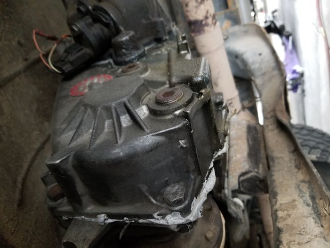

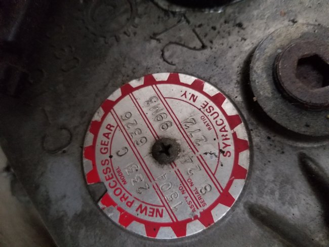

WRIGSCOT
Okay, so I just purchased the truck listed above 1500 SLT. We did a test drive around a few blocks and everything seemed fine so I bought it. Rookie mistake, I did not take it on the highway. Later I did just that and found it to be shaking and not wanting to get up to speed without shaking more. After I get where I am going I notice a small leak coming from the transfer case. Then I start really questioning the fact that I just picked it up for $2,000.00 and now I think I am seeing why. It is stuck in four wheel drive, it does not even try to engage two wheel drive. Also, on a whim I just looked up the transfer case model (233c) and find that it is for a Chevrolet according to Google, and to top the cake it appears that a liquid gasket was used and that is why it is leaking now.
Will this transfer case actually work for my truck and just needs a real gasket? Or do I need to find another transfer case? I do not have too much money and currently laid off until work starts backup after the holidays so hopefully someone has a easy answer that is not dreadfully expensive. I am not going to hold my hopes up too much for the cheap solution but cannot hurt to have a glimmer, lol.

WRIGSCOT
Here are few pictures of what I am talking about, hope it is of more help.
May 11, 2021 at 12:32 PM (Merged)
CARADIODOC
  • 34,321 POSTS
Let me put some of your fears to rest. A Chevrolet transfer case will not bolt up to a Chrysler transmission. The mounts are different too. The round label shows "New Process". That is actually the name of the company that manufactured the transfer case. They make parts for a number of car and truck manufacturers, so it is not uncommon to find internal parts that interchange from one vehicle to another.
As a point of interest, GM manufacturers roughly 80 percent of the parts they use in their vehicles, and they often sell them to other manufacturers. A good example is the MAP sensor and automatic idle speed motor used on your truck. Those come from GM. Chrysler, on the other hand, buys about 80 percent of the parts they use and they make the other 20 percent. They can shop for the best price, and when one supplier cannot keep up production or has a quality problem, they can go to a different supplier. That is why we used to find three or four different manufacturers for half shafts on 1980's front-wheel-drive cars. The shafts from any of the suppliers interchanged on the cars, but parts to repair a half shaft were different. A lot of rear drum brake parts are the same too between GM and Chrysler. Chrysler's turn signal switches in the mid 1990's had three part numbers printed on them. One was Chrysler's, one was Toyota's, and one was for someone else.
The liquid gasket you found could be original. RTV, (room-temperature vulcanizing) sealants have been around since at least the mid 1980's. It was first used on rear differential covers. Now you will find it on engine oil pans, transmission pans and rear covers, and valve covers. The problem with cork or fiber gaskets is that too many of us think that if tight is good, tighter is better. In fact, over-tightening pan bolts often leads to splitting the new gasket, and a leak.
Chrysler has two RTV gasket sealers that I am very familiar with. The first one is black. It cures a little more rubbery and is pretty easy to scrape off, but it has one major problem. It will not bond and seal through a film of oil or transmission fluid. Both sealing surfaces must be perfectly clean and dry. This is a problem for do-it-yourselfers with the older A604 front-wheel-drive four-speed transmissions in cars and minivans. When you do a fluid and filter change, fluid will still be running out of one area even if you let it sit overnight or for 24 hours. My coworkers each had their own preferred method of overcoming that, but my favorite was to reach up into a little well and splash my finger around to get the fluid out. After that, it takes a good minute for that well to fill up again before the fluid runs over and resumes running down onto the flange. I had the pan cleaned up already, and the bead of sealant applied. That extra one minute was plenty of time to spray the flange clean again with Brake Parts Cleaner, wipe it off, and slap the pan in place and get the bolts started. Typing that explanation takes a real lot more time than actually doing the job. The point is, that black sealant works just fine as long as both surfaces are clean and dry.
Chrysler also has a gray sealant that will bond and seal through a light film of oil or transmission fluid, but you still want to try to have dry surfaces. If you happen to overlook a little fluid running onto a sealing surface, you most likely will not have a leak with this gray sealer. It does cure a little harder, and it takes more elbow grease to scrape it off next time. Without going into all the gory details about when my mother ran over a chunk of metal, let me share that I used this gray sealer to build up a patch for the 3" by 4" hole in the side of the gas tank. That "temporary" repair lasted for over 23 years before the rest of the tank rusted out, and never developed a leak.
With both of these sealers, once the pan or cover is bolted tight, you can pour in the fluid right away. You do not have to wait for it to cure first. One more thing to watch for is when you take the bolts out, look for a blob of that sealer on the end by the threads. This is not a problem with factory-applied sealant, but when the rest of us put it on, we tend to put on too much, and some can ooze into the bolt holes. That can make a bolt feel tight when it really is not tight enough to do its clamping yet.
That sealant in your second photo is definitely not a factory job. Being smeared all over like that is not a sign of a professional's work either.
