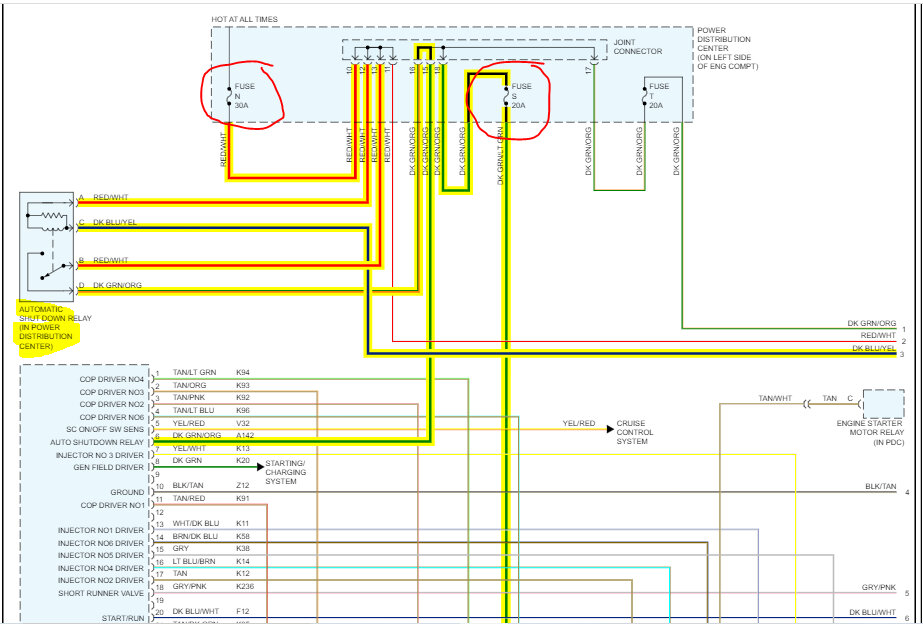

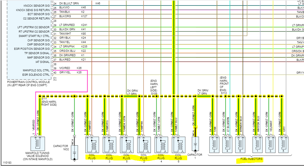

There are a few things we need to check. First, I attached a portion of the wiring schematic below, so you have a reference. I highlighted the wires that are relevant.
First, remove the ASD relay and inspect it for damage. If there is a different relay with the same part number, switch them to see if that fixes the issue.

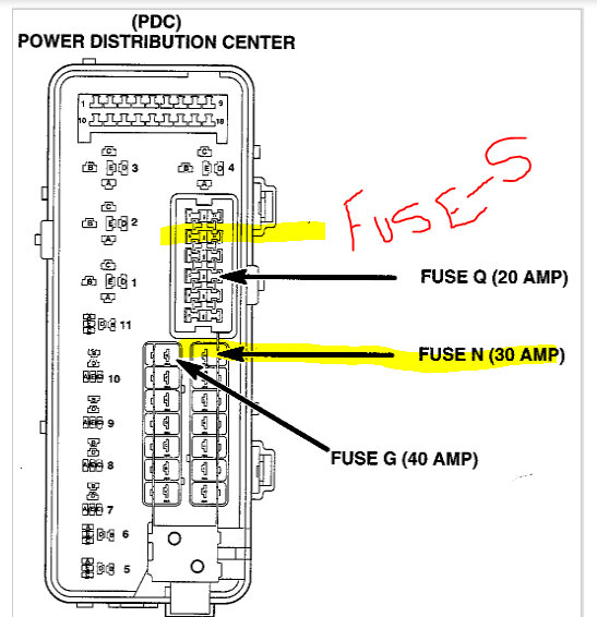

If it doesn't, there are two fuses I need you to check in the under-hood power distribution center. Both of these fuses need to be good for power to reach the coils and injectors. They are fuses S and N. See pic below. Confirm there is power to and from them. Here is a link you may find helpful. Also, note that fuse S will only receive power with the key on. Fuse N should have power at all times.
If the fuses are good and switching the relay didn't change anything, go back to the relay and remove it. On the relay, the pins will be identified by numbers. The primary side will be numbers 85 and 86. The secondary side will be 30 and 87. With the relay removed, take a test light and probe one of the connector pins at a time. One should have power regardless of the ignition key position. There should be a second that should have power with the key in the run position. Check that for me. (note) one pin will be on the primary side and the other will be on the secondary side. Take note of the number on the relay that correlates with the connector pins with power for future testing.

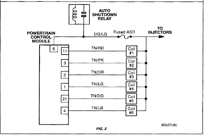

See pics below. I highlighted wires that are related. Pic 3 shows fuses N and S. Sorry about the childlike handwriting. I can't do it on a computer. LOL

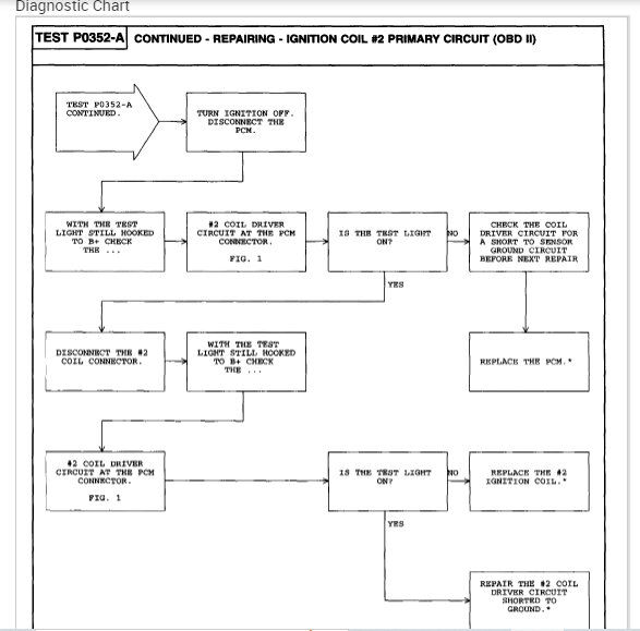

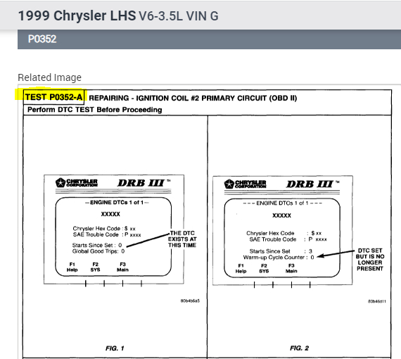

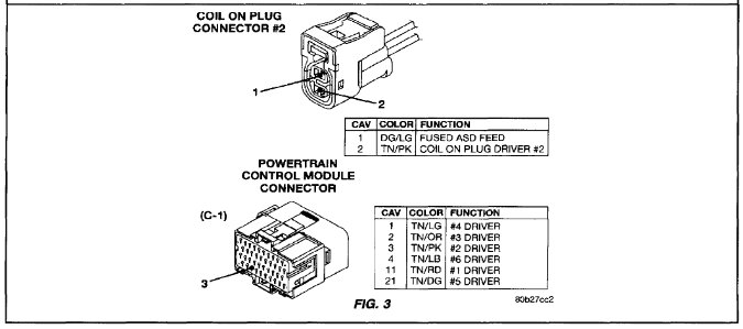

Hi Kevin,

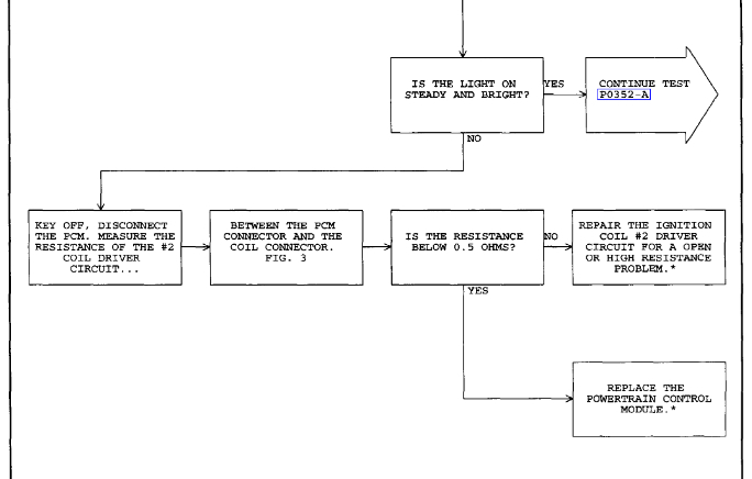

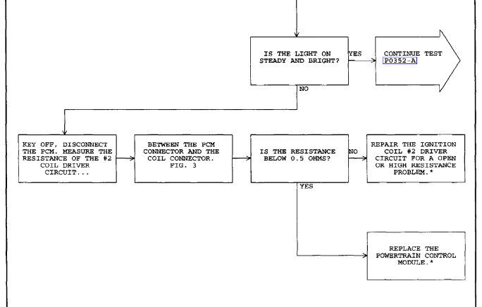

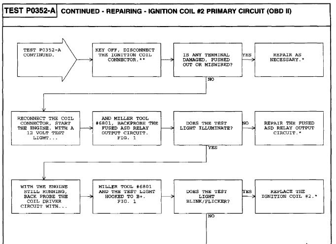

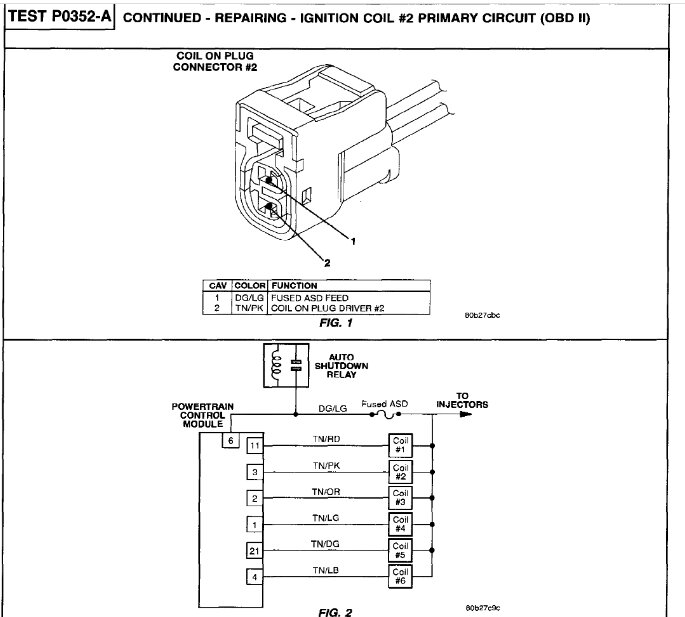

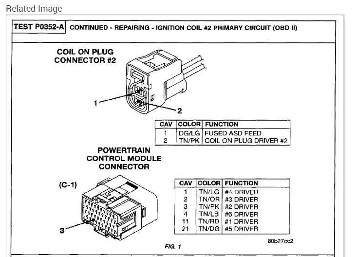

The voltages you provided are very low. If you are checking the voltage for the coils and injectors, they should have battery voltage.

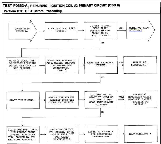

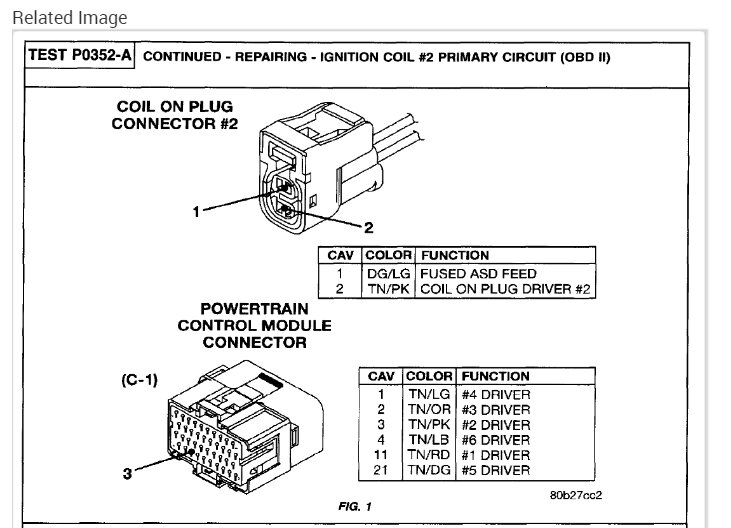

Take a look below. I attached the diagnostics for the P0352 which is specific to the ignition coil 2 primary circuit. Take a look through them and let me know if you are comfortable performing the tests.
Aug 9, 2023 at 3:13 PM

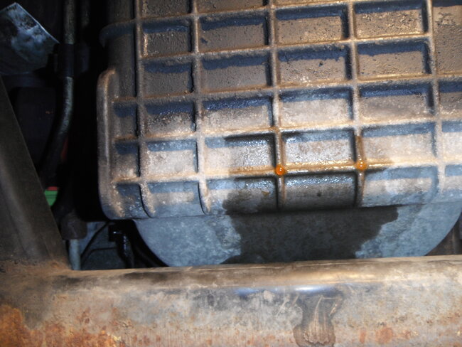

Chry 1999 LHS 3.5L v6. Have this leak. This vehicle uses that pink coolant. That is the oil pan. Do not see any line leaks. Water pump gasket? Any guidance would be awesome! Thank you, Kevin
Aug 15, 2023 at 6:39 AM
  • 110,241 POSTS
Kevin, welcome back.
Yep, I would say the water pump. However, I have a favor to ask. We try to keep the posts specific to one topic, so they are more helpful to others. Is it possible for you to copy your new question and paste it to a new post?
