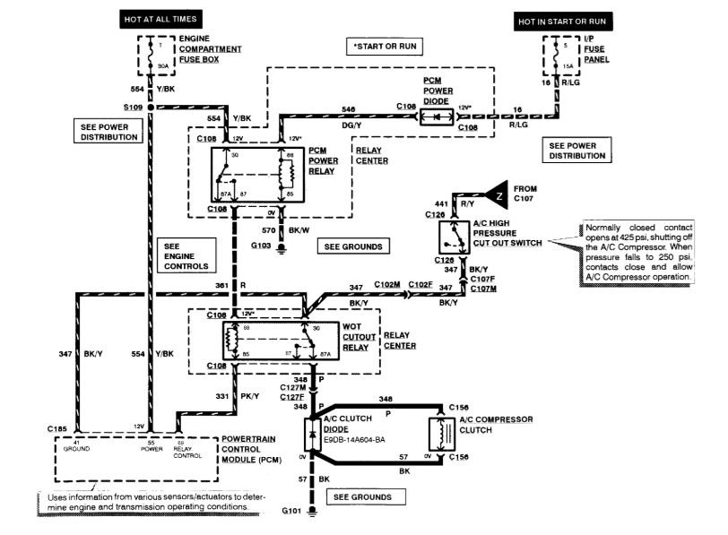

A/C not cooling. I did jump relay and A/C system came on. There is no power at pin 30 at the relay to turn the A/C clutch on. I jumped the A/C clutch cycling pressure switch by unplugging the switch and shorted the wires together, but that did nothing. It seems like a fuse, but I cannot find a blown fuse. Do you know which fuses should be checked. No twelve volts at A/C cutout relay.

The power for pin 30 comes from the high side pressure switch. You need to verify voltage at the high side pressure switch.
May 16, 2018 at 2:24 AM

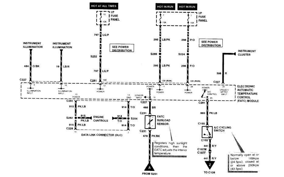

Thanks for the information. My Haynes manual did not have that diagram. I did find the high pressure switch, but had no power there or at the low pressure switch or pin 30. Any guidance would be helpful.

It is fed from the control head to the clutch cycling switch and then to the high side pressure switch.
Diagram attached.

Thank you for your help. I have fixed the control head. http://www.lincolnsonline.com/tech/00261.html. At this website I soldered the exact pin on the circuit board they show in the picture, which is a pin of a relay on that board. Very easy. reassembled and the A/C began working again. It has been working fine for several days now. Very interesting and simple fix.

The hyperlink does not take you directly to the page as it should, but if people look under the ( 5 TC EATC Module repair link) the page appears and there are pictures. My 1997 EATC module was made the same. It de-solders itself from the heat going through the power side of the relay over time.
