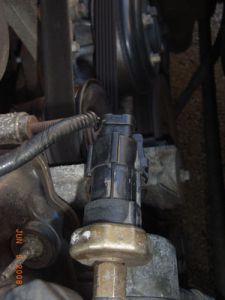

Air Conditioning problem
2000 Lincoln Town Car V8 Two Wheel Drive Automatic 95000 miles
checked air con compressor low and high pressure switch, relays, fuses and self diagnostic on dash.
gas full and checked by air con specalist.
no codes
you can by pass the compressor to make it work so i now thats ok
any help would be appricated.

Is it getting signal through the cycling switch (low side)? If pressures are good, then it is electrical,need to find out where the signal stops. Do you have a trigger signal at the relay from the PCM? Does the relay have power ? Is the ground good at the compressor?

DARRENCO1
  • 10 POSTS
thanks for quick reply i have just checked power to pcm fine and relay and switches, earth good at compressor

Is it passing the power through the cycling switch (low side)when a/c is on?

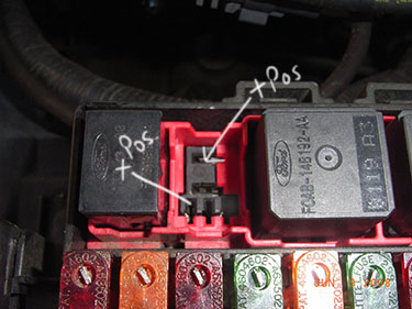

DARRENCO1
  • 10 POSTS
im getting positives at this relay removed
https://images.2carpros.com/forum/automotive_pictures/75566_R0013890_1.jpg
https://images.2carpros.com/forum/automotive_pictures/75566_R0013892_1.jpg
13 v through b/w wire on low presure switch

2CARPRO JACK

2CARPRO JACK
  • 11,533 POSTS
The relay shoul dhave power at 1 more spade with engine running, then th elast one3 should ground when a/c turned on (signal from PCM) the signal wire is orange/ lt blue

DARRENCO1
  • 10 POSTS
power on two terminals only with air con on or off cartier edition lincoln

2CARPRO JACK
  • 11,533 POSTS
did you test for ground at the orange/lt blue when a/c is on? (one of the other spades at the relay)

DARRENCO1
  • 10 POSTS
hi im getting red/black +
biege /cream earth
orange/black+
orange/dark blue earth constant
nothing seems to change air con on or off when reading from under pcm engine on
