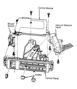

I have trouble getting into air conditioning mode. It wants to stay in heater mode no mater what the temperature is. This is the situation:
!. The vertical lever (Hi, Lo, Auto) works fine.
2. The top Horizontal lever (Thermostat- Temperature gauge) works fine.
3. The bottom horizontal lever ( Air, Heat, Vent, etc.)does NOT work fine. It wants to stay in heat mode. You can "play" with the lever and sometimes get the air conditioner on. If you leave the lever alone, it will stay in air conditioning mode, but if you turn it off or move it to vent or heat it takes a lot of messing with to get it back into air conditioning mode. When you are playing with the lever, and even if you don't touch it, you can hear a noise like a "flapper door" is trying to stay open or closed. I'm guessing something like a pencil has gotten into the system and is messing up the lever controls. The thing is I don't even know where to start to locate and remove the obstruction if that is the problem.
What are your suggestions on the situation?
Thanks,
Butch
Jul 13, 2020 at 6:41 AM (Merged)
DOCFIXIT
  • 18,828 POSTS
Hi Suspect fault in vacuum select valve see diagram
https://images.2carpros.com/forum/automotive_pictures/198357_Graphic_504.jpg
if it does not direct vacuum to correct servo then mode selection is not possible. Do you hear like a hissing sound sometimes from control unit? Need to remove and inspect unit can be replaced no need to replace entire controler. Let me know Thanks for donate
