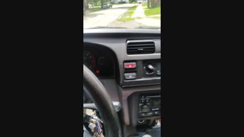

Yeah, I will send you one. I just dropped a brand new MAF sensor in it. No change.
Car runs well at idle. A little miss in it. Really acts up going down the road.
Video in a few minutes.
Put a code reader on it. Multiple misfires on multiple cylinders. Coil pack. And fuel issues according to what came up.
Cannot really hear what it is doing in the video. But it has a slight miss at idle. Going down the road it backfires and sputters badly. The new MAF sensor is helping it maintain speed, but it still pops and sputters. Does not quit running at idle or stop lights.
Going to check the injectors next.

Thanks for the video, are the spark plugs OEM? They must be one of the following spark plugs:
NGK Single Platinum Tipped
Standard Type FR5AP-10
Cold Type FR6AP-10
Hot Type FR4AP-10
NGK Double Platinum Tipped
Standard Type PFR5G-11
Cold Type PFR6G-11
Hot Type PFR4G-11
Any other spark plug will cause a misfire, also did you replace the plug wires with OEM as well? Also when you did the distributor did you replace the ignition coil?

The plugs are the NGK single platinum suggested for the car.
I did not replace the ignition coil.
A have new wires to put on. Will get them today.

I took the distributor apart. Cleaned the magnets in the ignition module. The sputtering and backfiring stopped.
Now, it idles at 11k. Closer to 15 when cold. Doing the new wires today. We will see. The spark from the old ones is yellow. Hoping the ECM is just trying to compensate for poor fire.
