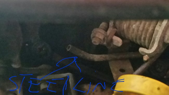

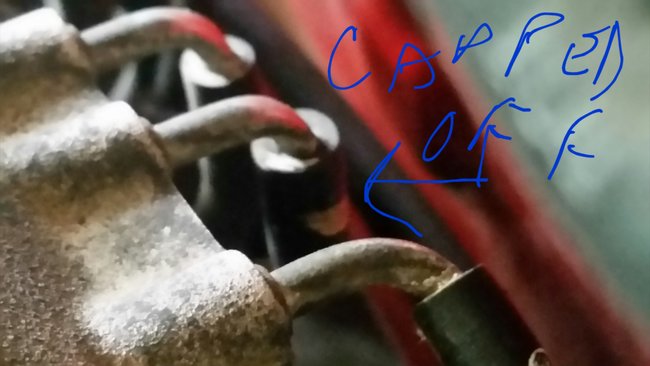

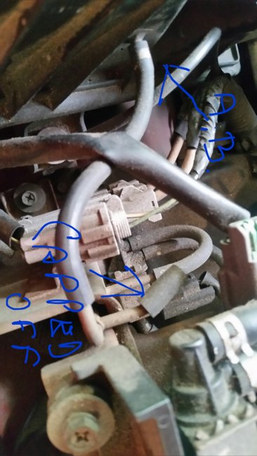

SHANNON DEYOUNG
  • 11 POSTS
I found a vacuum line has been taken off and capped at both the air box where the filter is and on the back of the engine drivers side.
The car ran well before the distributor bearing went out though.
Well, replaced it. Did not fix the issue.
