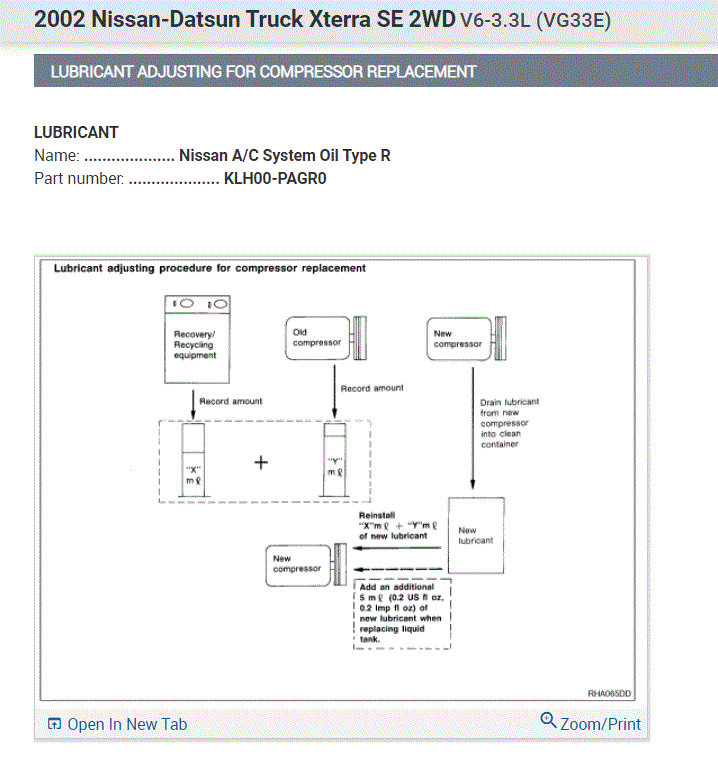

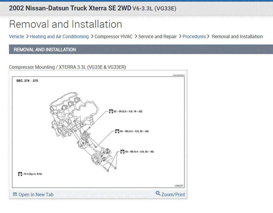

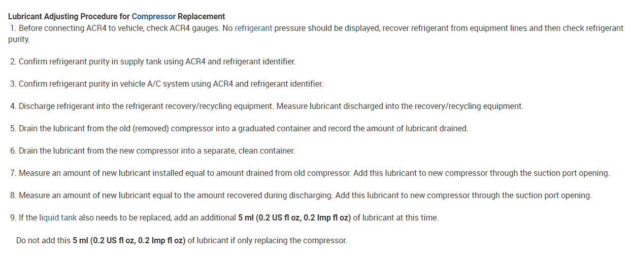

If you look at the attachments below, they provide the directions specific to your vehicle for compressor replacement and adjusting lubricant for compressor replacement.
