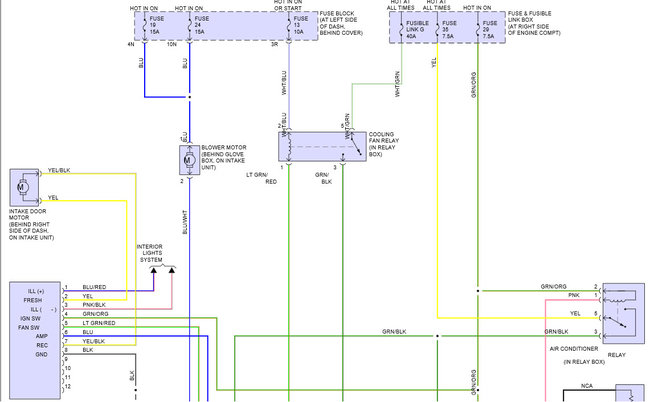

Would you send me diagram on PDF to check my air conditioners connectors? no start A/C that happened the machine was repair and at the last the air does not turn on. thanks so much.r egards from México.

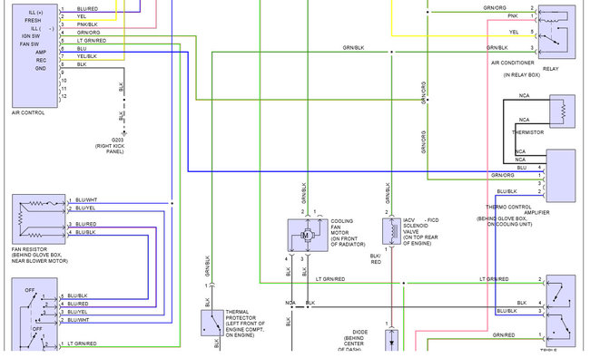

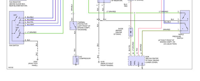

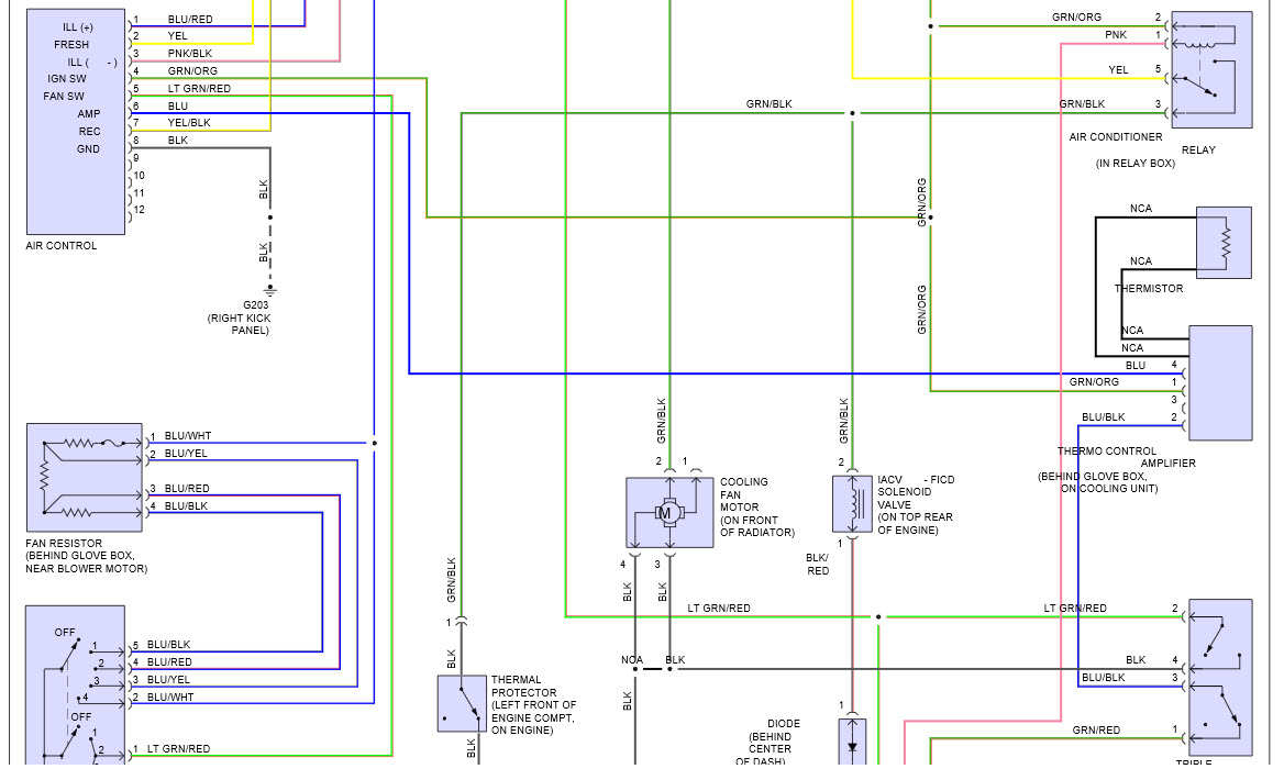

everything we send is in jpg. see pictures. also, this should be scanned for codes to see what is wrong with it. if it is automatic temperature where you set temperature it is mandatory to scan for codes with a professional scanner.
