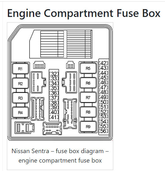

Yes, if you are manually putting fuel into the engine and it runs you are getting spark. If the fuel pressure seems to be satisfactory you might be having a sporadic fuel delivery issue. I would suggest checking the fuel pump relay-fuse first. It is in location number 48. I've attached a picture below from the under hood fuse box in your car. Here is a tutorial showing how to test a relay:
Let us know what you find and we'll go from there. Hope this helps and thanks again for using 2CarPros.

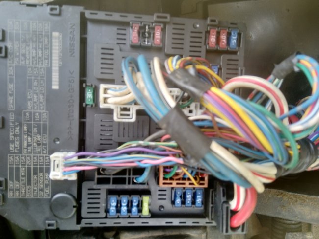

Thanks for the response so far, mine looks like (in the attached picture) in the engine compartment, but from the label the fuse and relay looks okay. And by the way I notice that when I disconnect the fuel hose from fuel pump outlet (single hose) with ignition "on" fuel won't pump out until I crank the engine that's when fuel flows out. please is that normal?

No, that is not normal. Even when you just turn the key in the 'on' position the fuel pump should prime for at least 2-3 seconds to prepare for you to crank and start the engine. Hope this helps and thanks for using 2CarPros.

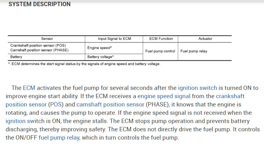

There is a problem by not having the fuel pump prime for the 2-3 seconds when you just turn the key 'on'. This would cause the issue of you having to crank the engine over so many times to start. Is this the original fuel pump or do you know when it's been replaced? Also, The ECM- engine control module is what controls this function for the pre start prime and also controls the fuel system functions. I've attached a system description picture below. Hope this helps and thanks again for using 2CarPros.
Danny-
