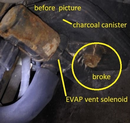

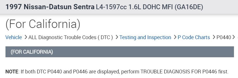

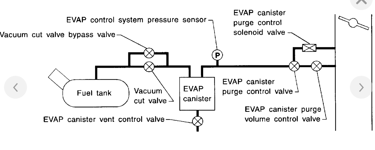

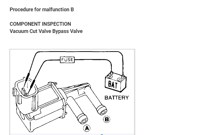

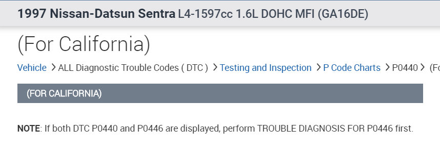

My car is giving P0440 and P0446 MIL codes together, which means large EVAP leak. I cleared the ECM codes, but they keep coming back after a while.
The car runs fine, starts fine, no issues otherwise.
I read this can be caused by the following:
Bad gas cap, intake manifold hairline crack, bad hose, cracked charcoal canister, EVAP vent control valve solenoid not closing properly, bad EVAP canister purge valve.
I checked the usual suspects and I'm down to 3 possibilities, the charcoal canister, the EVAP vent valve/solenoid, the EVAP purge valve/solenoid.
YouTube doesn't have any videos for replacing the canister or the vent valve for this model.
What could be causing this issue? What tests to perform to narrow down possibilities? Which item should I replace first? Is there any way to fix the parts other than buying brand new replacements?

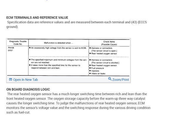

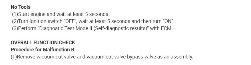

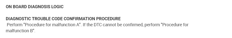

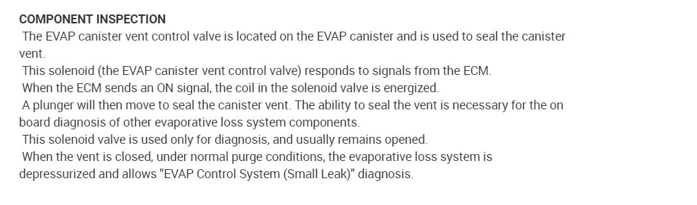

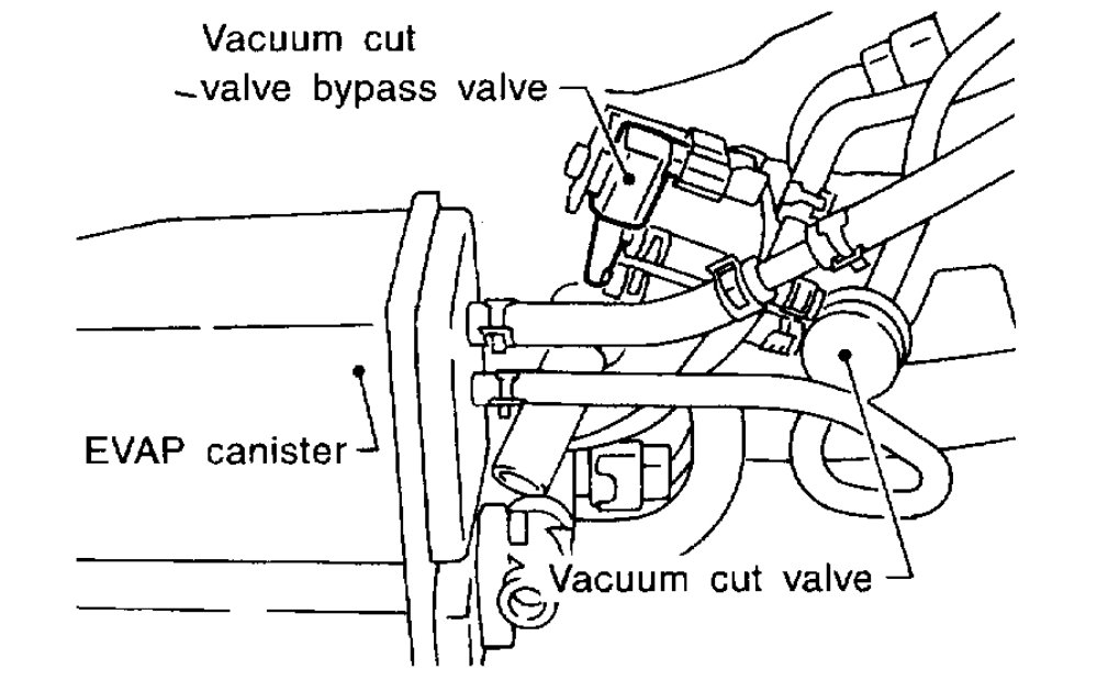

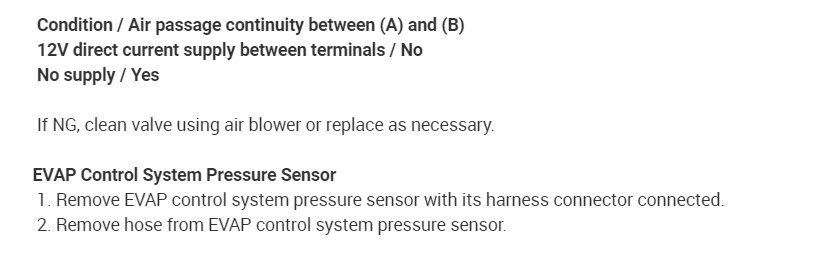

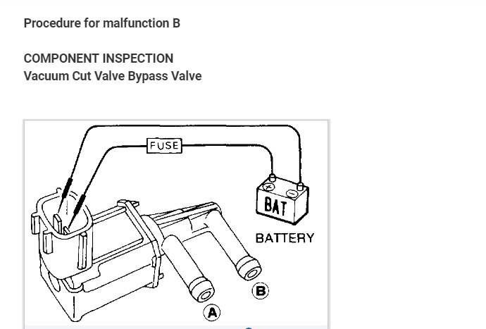

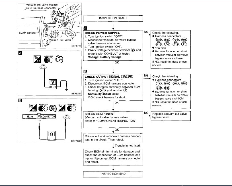

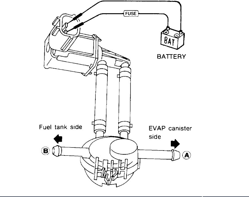

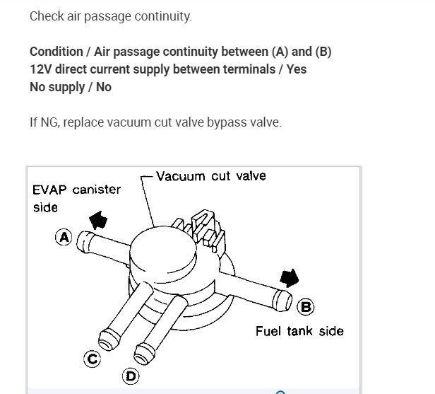

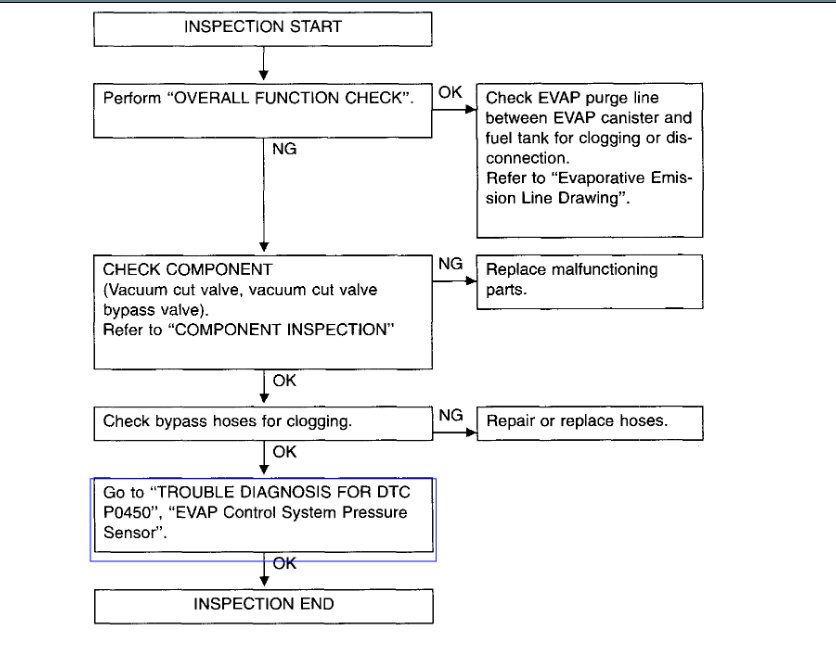

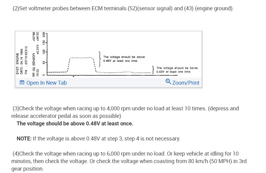

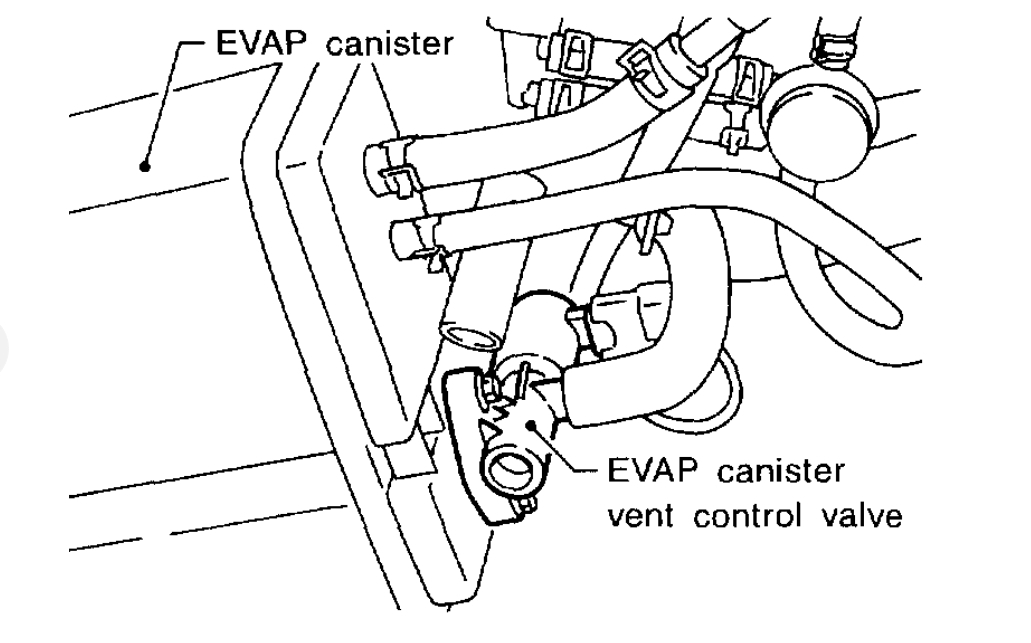

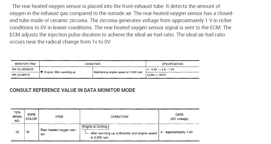

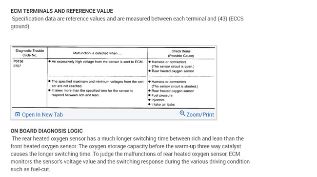

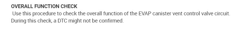

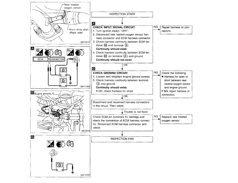

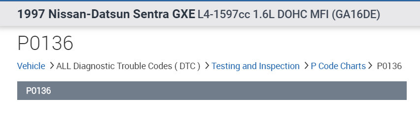

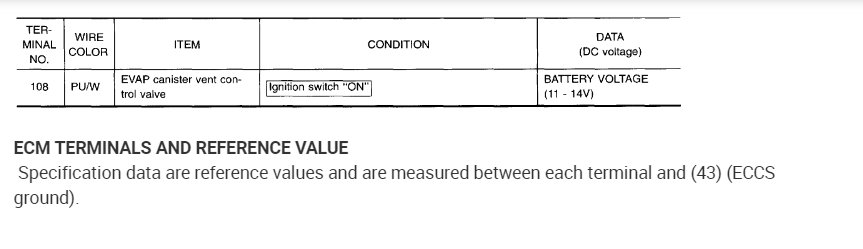

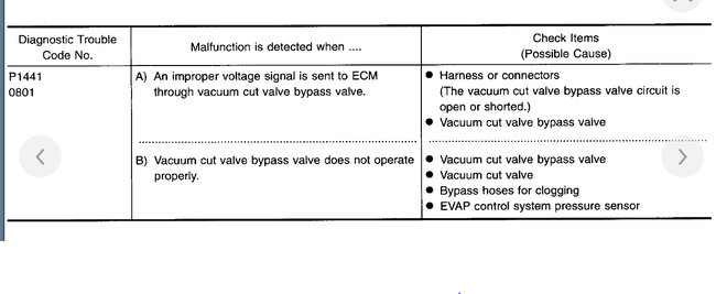

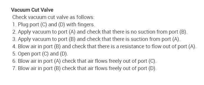

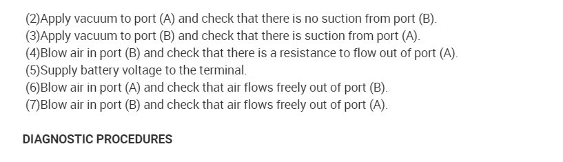

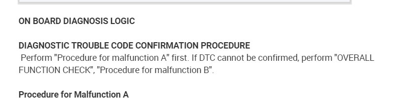

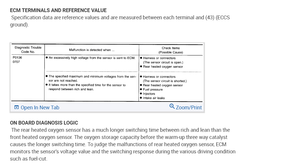

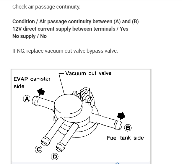

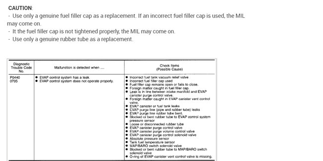

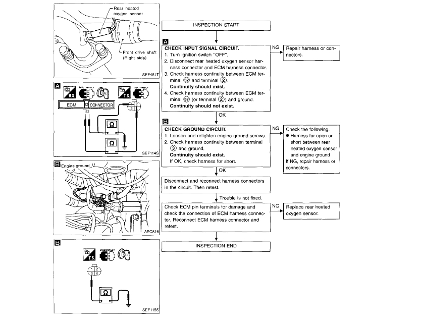

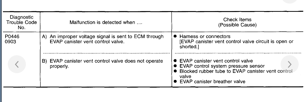

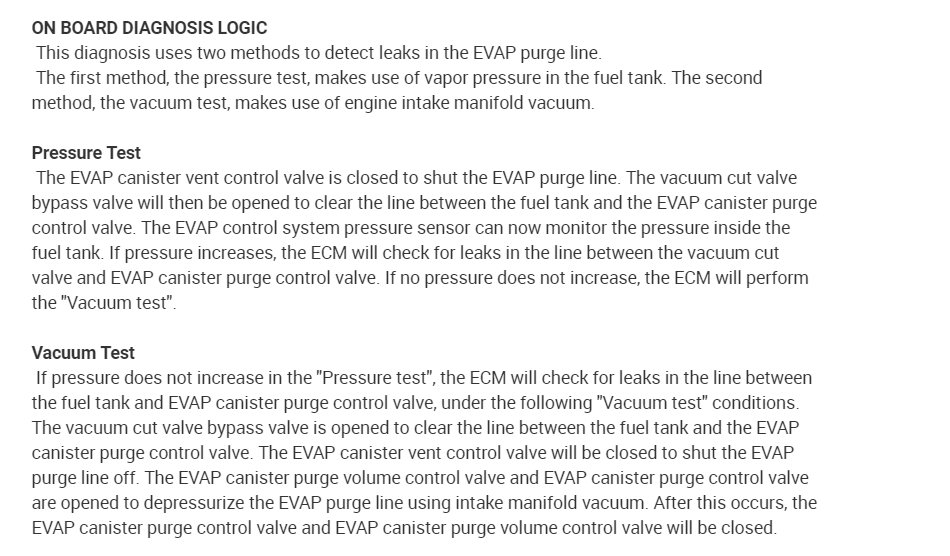

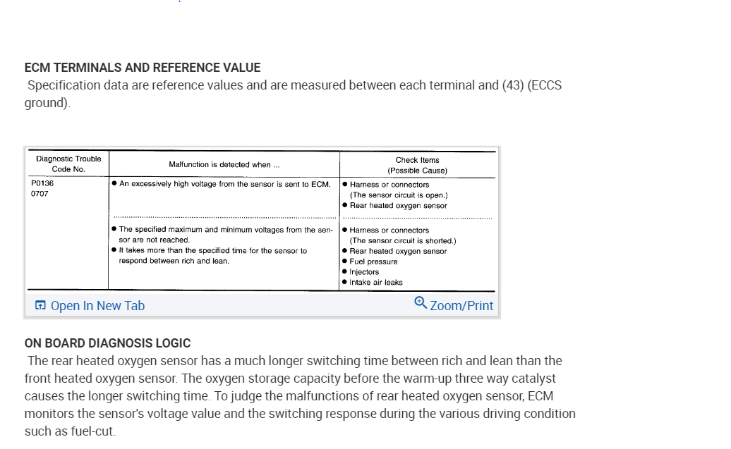

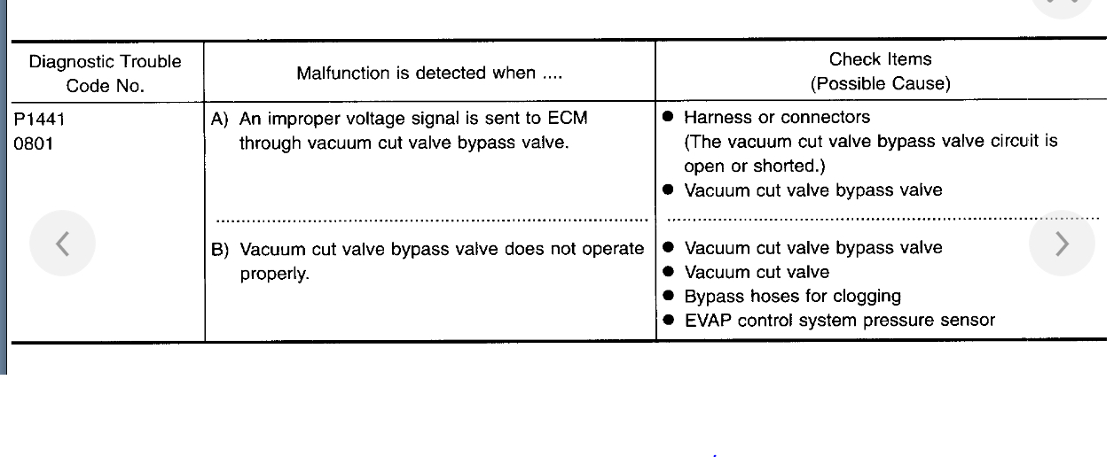

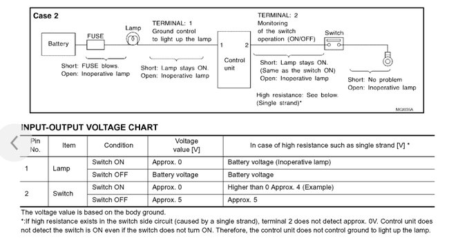

In the diagrams down below I have included the factory diagnostic troubleshooting guide for DTC P0446 for your vehicle. The instructions call for doing this DTC first. In order to go through this guide correctly you will need to have a vacuum pump, a multimeter, and a scan tool with PID capabilities. Please go through this guide and get back to us with what you are able to find out.

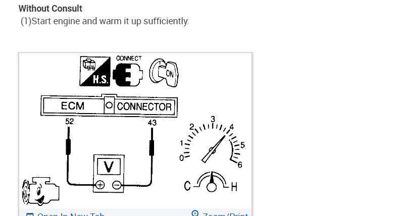

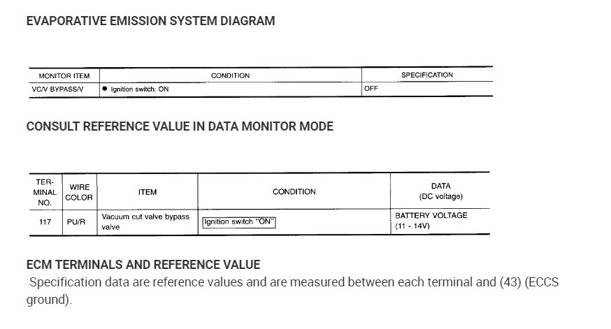

Your help is greatly appreciated. I have several questions.
1. Thanks for the 14 images. Which test should I perform first, the vent valve(solenoid) test or the pressure sensor test?

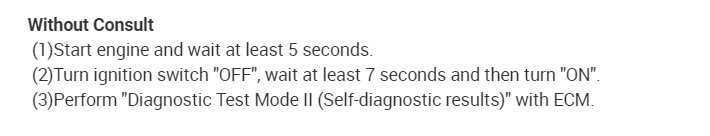

2. What does the 'without consult' photo (2nd row, 2nd photo) mean?
3. What does NG' mean?

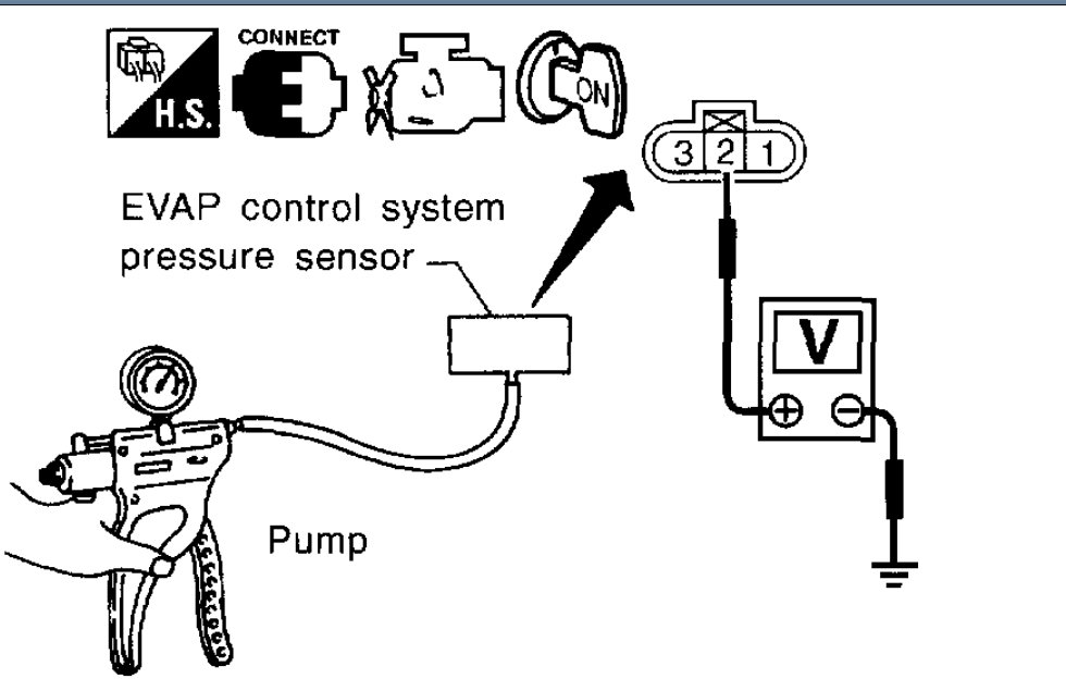

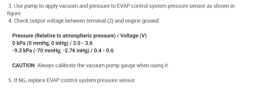

4. I am handy with a multi-meter and I also have a Bluetooth DTC scan-tool with PID capabilities. You mentioned I need a DTC tool with PID. Is that just for finding the actual DTC codes? If yes, I already found the codes and they are P0440 and P0446 together. If not, please explain.
5. When it says "ignition switch on", I will not crank or start the engine first, right?
6. Where is the EVAP control system pressure sensor located?
7. I don’t have a vacuum pump. Can I attach a pipe and blow and suck air?
8. I checked the fuse bank located at bottom-left of the steering. There was no fuse for the EVAP system. Do these EVAP solenoids have fuses? Where are they located? Can it be a fuse issue?

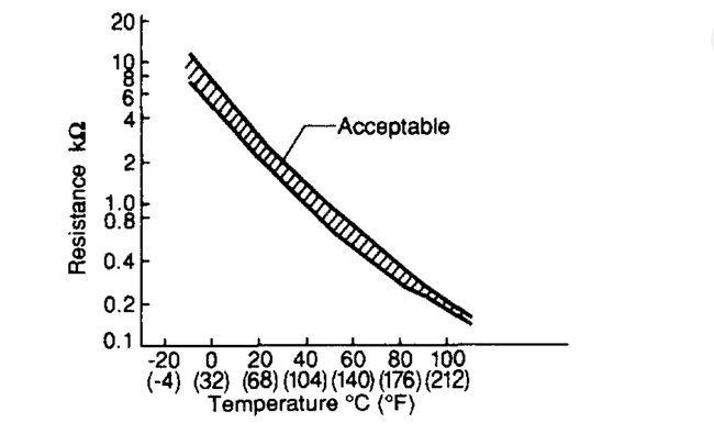

9. What is the proper resistance in ohms for the vent solenoid coil and the pressure sensor?
Aug 2, 2019 at 7:26 AM
SCGRANTURISMO
  • 4,897 POSTS

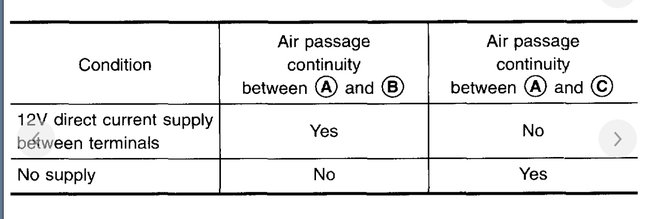

Hello again,
1) Diagram #8 gives you the order to test in.
2) Consult is the name that Nissan gave to it's factory version of a scan tool that is used by their technicians at the dealership.
3) Negative or No Go, take your pick.
4) No. It is for accessing the EVAP Monitor information and turning the Monitors ON/OFF.
5) No, that is "start", in this case on is "RUN", the position right before "start".
6) On the left rear underside of your vehicle.
7) No. They are available for just a refundable deposit at parts stores like AutoZone. You have to have a gauge for measurement, which the vacuum pump does.
8) No. Power and Ground provided by the Power-train Control Module(PCM).
9) I do not have the information available at this time. The coil just uses electricity provided by the PCM to move a plunger back and forth to allow vapor gases to pass. The more electricity the more plunger movement, so resistance here would be very low. The pressure sensor is probably different, but, like I said, I do not have that information available right now.
Thanks,
Alex

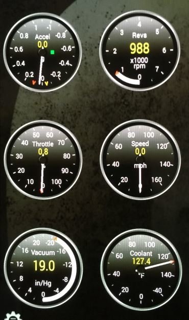

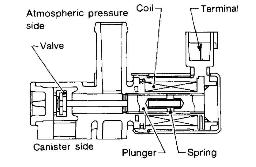

I am using the Torque Pro app on my Android as the scan-tool to read the OBD information using Bluetooth. I am not sure whether the Torque Pro app can send/receive commands for turning on/off EVAP monitors.
I did some testing as you suggested and I think I found the issue.

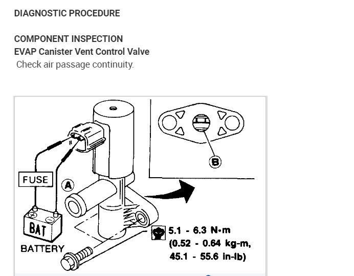

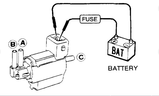

When the key is on/run position (engine not started) I get 11.2 to 11.6 volt at the EVAP vent valve solenoid, so the wire harness is good.
The solenoid coil shows around 11.5 ohms resistance, but does not make any sound when energized.
I connected the solenoid to a regular 9 volt battery and then a 12 volt car battery but I did not hear any ticking sound of the plunger moving/closing/opening in either case. Shouldn't there be an audible tick sound from the plunger when energized?
Is there any way to repair the vent valve solenoid?

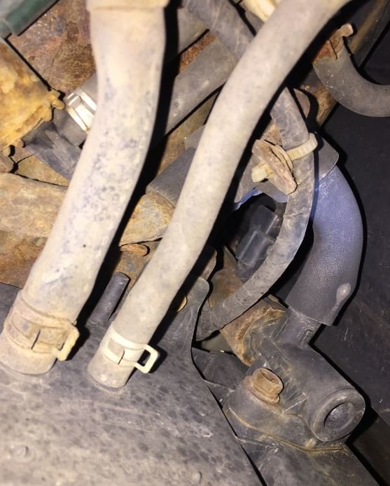

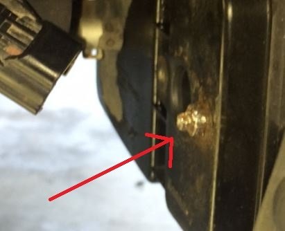

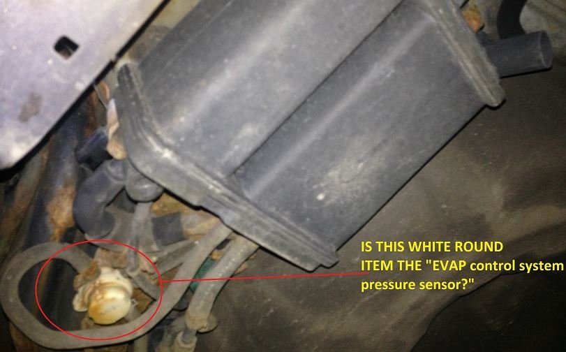

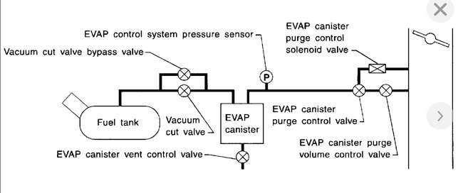

Please see the photo and let me know if that is the EVAP control system pressure sensor.

Hello again,
Yes. The Vent Valve Solenoid should either be off or on and when energized you should here a click. The best thing to do here is just replace the solenoid. If you want to double check just to make sure. run a voltage drop test on the circuit. This is the preferred way to check electrical circuits and will tell you where the bad segment of the circuit is with amazing clarity, revealing damaged segments you would never be able to find running continuity tests with the multi-meter in Ohms (Resistance) setting. Please go through the guide and get back to us with what you are able to figure out.

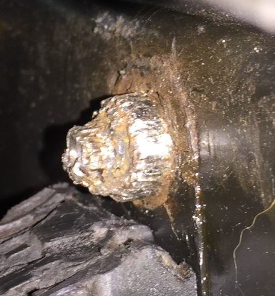

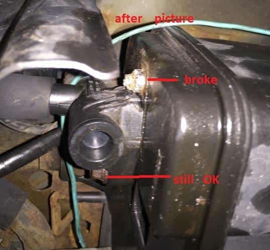

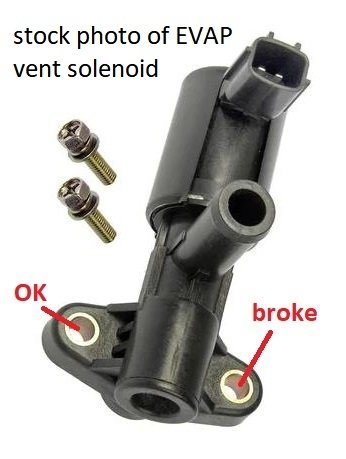

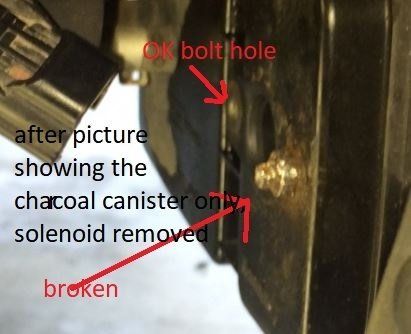

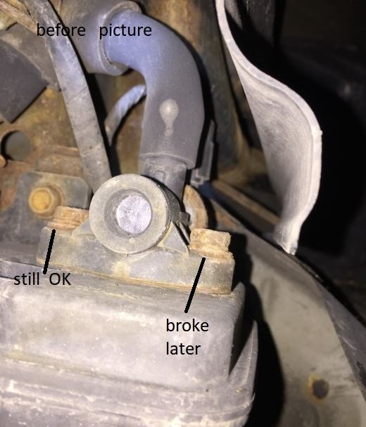

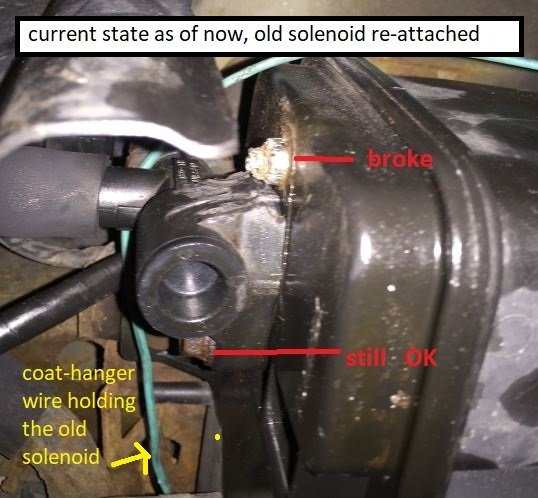

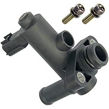

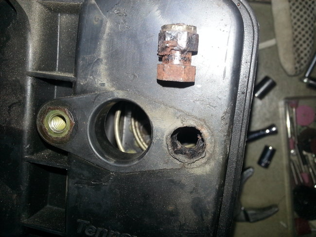

One of the bolt's head snapped. I was able to remove the EVAP vent solenoid but the broken bolt's anchor which is embedded inside the charcoal canister also broke and now rotating freely and I cannot remove it. A photo is attached. Any suggestions?
Aug 3, 2019 at 9:51 AM
SCGRANTURISMO
  • 4,897 POSTS
Hello again,
If it were me, I would get a Dremmel tool, and wearing safety glasses with side shields, I would grind the head of the bolt off. That way I could pull the charcoal canister off, and then extract the bolt shank and replace the bolt with a new one when I went to reinstall the charcoal canister. Please keep us informed.

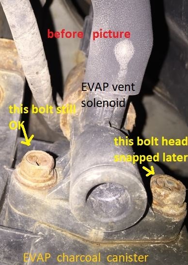

The bolt shank won't come off that way because I think there is a captive nut on the other side. And the captive nut has broken free from its moorings. The whole thing now rotates freely. Here is a close-up of the bolt with broken head and shank and free from moorings.
Aug 3, 2019 at 11:00 AM
YOURMINKY
  • 106 POSTS

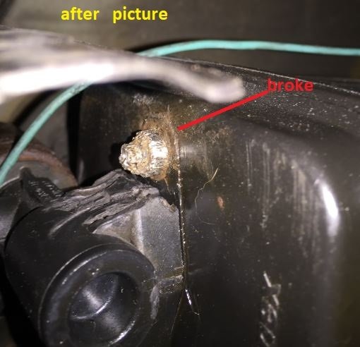

I am thinking about either using a Dremmel tool and cut off the broken shaft with the captive nut attached or yank it out. Which one do you suggest?

Here are bunch of photos with clear descriptions that may help understand the situation.

I understand what is going on. If the whole bolt rotates around and it is broken on the side of the head, you should be able to just pull the whole bolt through the hole on the charcoal canister. If that isn't possible, then i would grind the head of the broken bolt off with a Dremmel tool and a grinding wheel. Once the head of the bolt is off the EVAP Vent Solenoid should come right off, then you can see whats going on with the shank and address it better because you will better access to it. Please keep us informed.

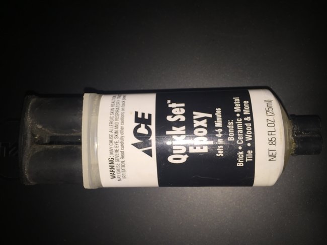

Can you please recommend the type of RTV and JB Plastic Weld I should buy? I went to the store today and there were dozens of options. People recommended the quick set JB Weld epoxy or superglue gel with baking soda. I have plastic cement, will it work in this case?

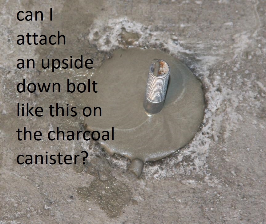

Should I insert an upside-down bolt in the cavity where the captive nut would go (please see the stock photo below) and use it as a post to attach the solenoid with another nut Or use a regular captive nut and put a glob of JB Weld around it like it used to be?
Aug 6, 2019 at 10:44 AM

There is no real wrong answer here. If it were me, I would take out broken piece and put a bolt in, JB Weld it with regular two part epoxy JB Weld and use a matching nut to fasten everything down. In the end though, all you are doing is fastening down the solenoid. Remember, there is more than one way to skin a cat. As long as the solenoid gets fastened to the canister, then that was the right way to do it. As far as the RTV goes, really any of them will work on this application. I would go ahead and use the black, just because all of parts you are working with, the charcoal canister and the solenoid are black as well. Please keep us informed.

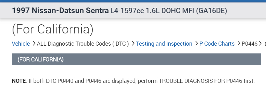

The old car's exhaust is making loud noise as of tonight. It is very rusty and there is a big hole in the tailpipe in the front side - the part that comes out of the engine. The car is not accelerating properly anymore. Shaking when trying to go faster. It is giving 3 total fault codes now. P0440, P0136 and P1441.
Aug 6, 2019 at 1:47 PM
SCGRANTURISMO
  • 4,897 POSTS
Hello again,
Okay, so DTC P0440 we know is an EVAP leak, and that is getting fixed. So let's take a look at the other two DTC's, and see what we got. In the diagrams down below I have included the factory diagnostic troubleshooting guides for DTC's P0136 and P1441. The exhaust manifold just unbolts. The bolts are usually rusty and baked in place, and can be a bear to break loose. Get a can of PB Blaster or WD40 and soak the bolts liberally and let soak overnight before attempting to break them loose. Go through these guides and get back to us with what you are able to find out.

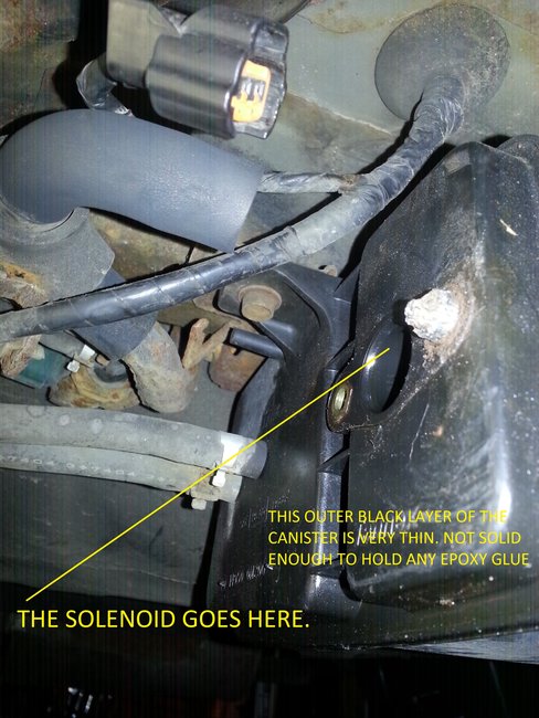

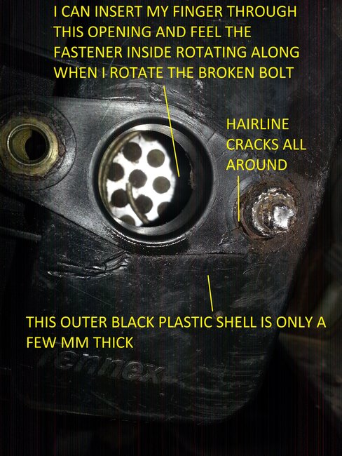

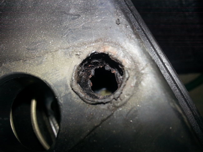

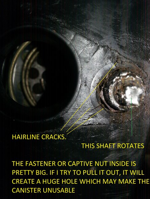

I tried removing the broken bolt shaft tonight but wasn't successful. I found out that the outer black plastic shell of the canister is very thin and not solid behind the broken bolt shaft. It is probably a little bit thicker than a credit card. There is no way it will hold enough JB Weld that is strong enough for a bolt or a captive nut. If I try to cut the broken shaft with a Dremmel tool, it will probably cut through the canister's thin plastic skin. A few photos are attached.
I can insert my finger through the solenoid hole and feel the huge fastener that is inside and behind the black plastic outer shell. The fastener which was previously mentioned as the captive nut, rotates along with the shaft. I cannot pull out the broken bolt shaft because the fastener inside the canister is huge, 4 to 6 times larger than the diameter of the broken bolt. There are hairline cracks on the thin plastic all around the broken bolt.
1. How do I remove the broken bolt shaft?
2. How do I fasten the new solenoid since the JB Weld method we discussed won't work?
3. How do I make the canister air-tight?
Aug 9, 2019 at 4:09 PM

Okay, so there are a couple of options here. JB Weld actually makes a product that is made specifically for plastic. Also at your local auto parts store you can get black sealant in a tube manufactured by Permatex that is basically black liquid rubber that will harden into rubber in about 15 minutes. Either one of these products will work, but the JB Weld will be more permanent of a fix. The bolt is more tricky. I am not sure exactly what you have going on. Is the shank sticking out where you could put the solenoid on and then tighten a nut?

The collar/spacer and the broken bolt shaft and the inside captive nut all rotate together. I need to remove them and replace and make everything air tight.
Aug 11, 2019 at 12:37 AM
SCGRANTURISMO
  • 4,897 POSTS
Hello again,
Okay, so how far out does the broken bolt shank stick out where the solenoid is fastened onto the charcoal canister?
Thanks,
Alex
2CarPros
Aug 11, 2019 at 7:52 AM
YOURMINKY
  • 106 POSTS
Photos are attached. I just removed the broken bolt shaft, collar/spacer and the captive nut.
Heating up a new captive nut and placing it in the cavity may not be a good option because it may not be an air tight solution as air may leak through the captive nut's threading, is there a way to make the new captive nut threading air tight?
Upside down bolt post is a good solution but how do I get the huge bolt head inside through the round cavity?
Do I need to test the canister for air tightness before re-attaching?
People are telling me crazy glue and baking soda may be a better solution to patch the hairline cracks and re-attaching the captive nut or upside down bolt, what do you think?

Plumbers tape or silicone tape has been used to make threads watertight for years, if water can't get through neither will air. Also RTV spread on on the threads of a fastener will also do an excellent job. RTV or silicone sealant is an excellent choice for sealing, but remember, there is no wrong answer here. In the end as long as it is sealed, that is what we are trying to achieve here. Remember, if it's sealed, then whatever you chose to do was the right answer. Please get back to us with how it turns out.

Bad luck, the replacement new solenoid is not holding a vacuum. I tested by energizing the solenoid with a car battery and then sucking air through the solenoid. The old solenoid holds a vacuum far better than the new one.
The silicone RTV sealants are thick and probably will not sip into the hairline cracks. I am also afraid it will also create a slight bulge if I spread a thin layer over the hairline cracks which will make the solenoid uneven against the canister. That's where super glue will probably work better because it flows like water and get inside the cracks easily. You have not recommended super glue so far. Is super glue not recommended for this purpose? Photos of adhesives I have are attached.
Aug 11, 2019 at 2:06 PM

Super Glue will work fine. Remember, all's you are doing is getting the charcoal canister to seal. There is no wrong answer here. I think Super Glue is a great idea and if I am ever in this position, might be my first choice, now. Sealing is very important with the solenoid. Please keep us informed.

All of the JB Weld items Walmart and Farm and Fleet had said, "works on some plastic." I was not sure what kind of plastic the canister is made from so I Bought some Permatex crazy glue. They did not have the JB Weld Liquid Rubber that works on plastic in stock.

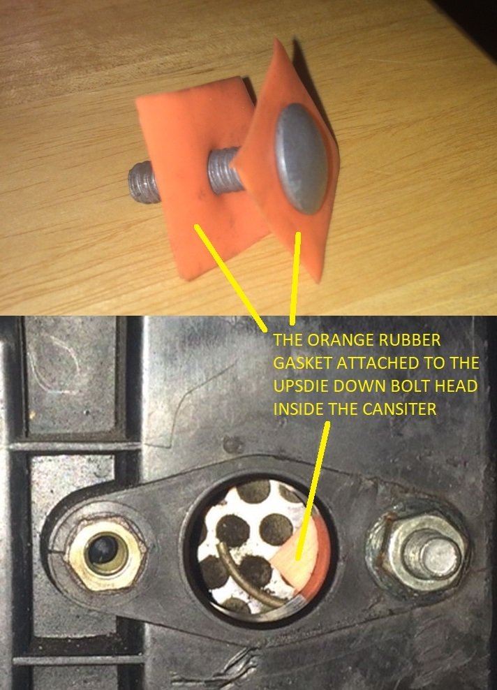

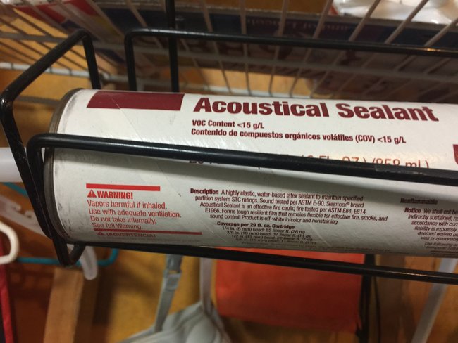

I tried putting 2 rubber gaskets on the upside down bolt and tried to add 2 part JB Weld. The clearing between the post and the canister wall was so small and the JB Weld was so thick that I ended up putting a lot on the bolt thread and ruining it. I have new bolts. Is epoxy the best solution here?
I was thinking about using the orange rubber washers in the photo as a bolt head sealant inside the canister and then drip either thin epoxy or super glue from the top. Are those rubber washers a good idea or just go with bare metal upside down bolt head inside the canister?

I tried to seal the canister bolt hole with my own 2 ply orange rubber gasket and attached a nut on top as shown in the photos from earlier today. JB Weld method did not work, too thick for the tiny opening, just wasted a bolt.
As I mentioned on Sunday, the new solenoid is defective and not holding a vacuum when energized. I bought it online. The new-new replacement will arrive on Thursday.
After spraying with PB Blaster, transmission fluid and cleaning up with Brake Cleaner, the old solenoid now holds a vacuum, by mouth-air-sucking test.
The muffler shop welded back the exhaust pipe. Last night I patched the remaining hole with exhaust cement. All exhaust and O2 sensor related faults P0136, P1441, P0446 are gone.
So, I mounted the old solenoid with one bolt, sealed the other hole with my double orange rubber gaskets (see photo above). After driving for a hundred miles and several stops, the Torque Pro OBD2 app now shows only one of the the original fault code that is P0440. The car finally completed the EGR System test per Torque OBD2 reader which it could not complete for many weeks due to the fault codes.
When I opened the gas cap a few minutes ago, a whole bunch of air hissed and rushed inside the gas can, so my home made orange sealant gasket was holding a vacuum. Is that a correct assumption?
Waiting for your comment before doing the super glue fix.

Hello again,
The super glue method sounds good to me. Also have you tried clearing DTC P0440 with yet? You should do this after you repair the leak where the solenoid bolt goes. For your reference I have also included the factory diagnostic troubleshooting guide for DTC P0440 in the diagrams down below for you. But it definitely sounds like you are doing a great job so far. Please keep us informed.
