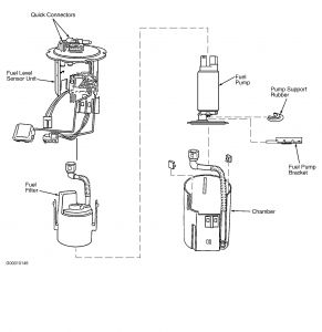

Hi!
I replaced my fuel pump. after I replaced it the check engine light came on the codes that it showed were PO181 and PO183. So, I called up the Nissan dealership and talked to the repair guys there. They said it can only be a bad pump and I should replace it again. So I did. As soon as, I replaced the pump the same codes keep coming up. So I don't think it's the pump. So my question is. Is there something else I need to replace when replacing the fuel pump?
Thank you!
Sep 23, 2010 at 11:31 AM
DOCFIXIT
  • 18,828 POSTS
Was pump an O.E.M or aftermarket? if aftermarket did it come as complete assembly? with FTT ? see diagram
https://images.2carpros.com/forum/automotive_pictures/198357_Graphic_620.jpg
181 and 183 faulty fuel temp and fuel level sensors
Sep 23, 2010 at 2:06 PM
IPASAL083
I believe it's an aftermarket pump. I ordered it from NAPA. The only thing that I got was the pump by itself nothing else came along with.
Sep 26, 2010 at 12:38 AM
DOCFIXIT
  • 18,828 POSTS
Codes will stay till FTT is repaired or replaced

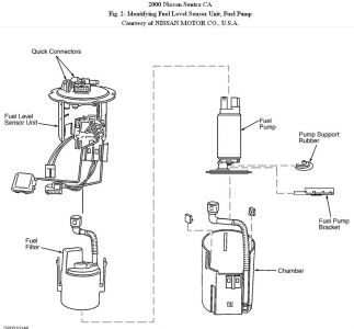

How do you replace the fuel pump and filter?
Aug 8, 2020 at 12:45 PM (Merged)
KHLOW2008
  • 41,814 POSTS
Hi freakdogslim, Here are the procedures. FUEL PUMP, FUEL LEVEL SENSOR & FUEL FILTER -
https://images.2carpros.com/forum/automotive_pictures/192750_FuelPump00SentraFig02_1.jpg
Removal & Installation 1. Release fuel pressure. Remove access cover located under rear seat. Disconnect fuel hoses and electrical connector. Remove fuel pump assembly screws. Remove fuel pump assembly from fuel tank. 2. Using a screwdriver, disengage clips holding fuel pump assembly to chamber, in order shown in illustration. See Fig. 3. Disengage fuel tank temperature sensor wiring harness. Disengage clips holding fuel level sensor to chamber. Pull fuel level sensor upward. 3. Disconnect fuel pump harness connector. Disconnect hoses from fuel level sensor unit. Pull fuel level sensor unit upward and out of chamber. Disengage locking tabs holding fuel filter into chamber. 4. Pull fuel filter out of chamber. Using a screwdriver, remove fuel pump bracket. Pull fuel pump out of fuel filter. To install, reverse removal procedure. Tighten bolts to specification.
https://images.2carpros.com/forum/automotive_pictures/192750_FuelPump00SentraFig03_1.jpg

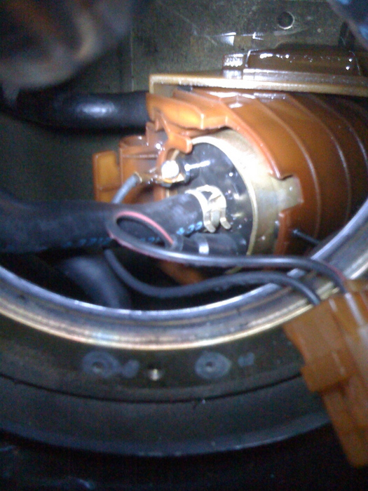

KA9VTO
I was replacing the fuel pump Assembly and I found a o-ring laying and not sure where it goes,and is there only one? Aprox 7/16ths across
BMRFIXIT
  • 19,053 POSTS
Is it a big o ring it goes between the pump module and fuel tank
https://images.2carpros.com/forum/automotive_pictures/99387_sentra_1.jpg
KA9VTO
No its not the big one at the opening this one is about 7/16ths across
BMRFIXIT
  • 19,053 POSTS
I cannot locate any other o rings
is it a rubber o ring
I would check the quick connector if had it fallen put of it
i should have two inside of it
KA9VTO
yes its rubber, I do not see any o-rings inside of the connector lines would both lines take one or just the one from the pump?????? as I stated I only found one o-ring
BMRFIXIT
  • 19,053 POSTS
I’m trying to recall how or if any small o ring is in the fuel pump module
and I cant come up with any thing else
is it possible its an extra part that some one put it in the box by mistake

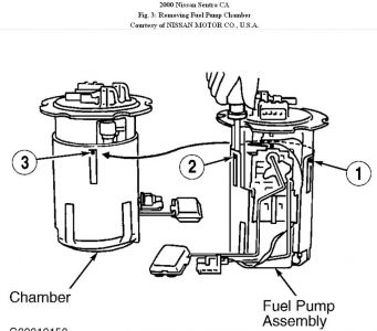

DRNUKE
I have gotten down to the fuel pump in a 1996 Nissan Sentra, but cannot find the clip that releases the assembly. I have taken out the float and can access the pump, but cannot seem to release it to remove it. Any suggestions? A picture would be great.
Thanks.
Aug 8, 2020 at 12:46 PM (Merged)

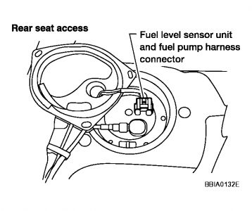

  • 75,992 POSTS
REMOVAL
1.Release fuel pressure.
2.Remove inspection hole cover located under the rear seat.
3.Disconnect fuel supply tube, return tube and electrical connectors.
4.Remove the six screws.
5.Disconnect fuel tubes and connector, then remove fuel gauge assembly.
6.Remove fuel pump with chamber.
*Pull up the front of the chamber.
*Slide chamber forward.
7.Remove fuel pump from chamber.
INSTALLATION
To install, reverse the removal procedure.
CAUTION:
*Tighten bolts to specified torque.
2.0 - 2.5 Nm (0.20 - 0.26 kg-m, 17.4 - 22.6 in-lb)
*Always replace O-ring with a new one.
*After installation, run engine and check for leaks at connections.
DRNUKE
Thanks rasmataz. I've tried this but with no luck. The chamber is held in place by something. I'm afraid to use too much force for fear of snapping something off. The attached photo is what I am looking at - "front" is on the left.
DRNUKE
I was able to get it out there is a clip at the top, on the rear end of the chamber.
Thanks again.
