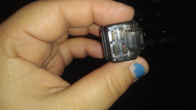

I will check into that. also, about a year and a half ago I was going to the mall and I went to turn my truck off and it still was running and I could completely remove the key. I drove to my friend's house and we worked on it for several hours turns out then it was the ignition switch relay. I move the relay around and checked under where the ignition switch was and it worked just fine, until now. where the car at first was cranking but not popping off now it is not even turning over like if it had a drained battery.

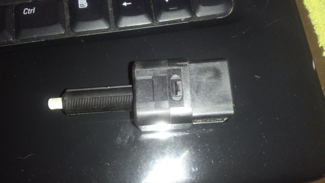

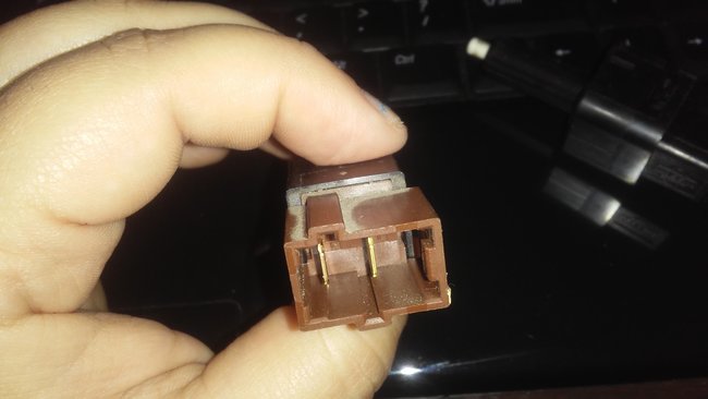

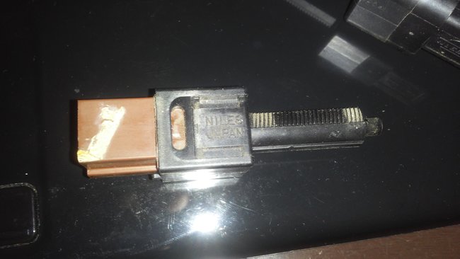

MIKE H R
  • 3,094 POSTS
There is a switch on the brake pedal arm that controls that locking mechanism.
Apr 1, 2018 at 12:35 AM
CIARA VANLANDINGHAM
  • 25 POSTS

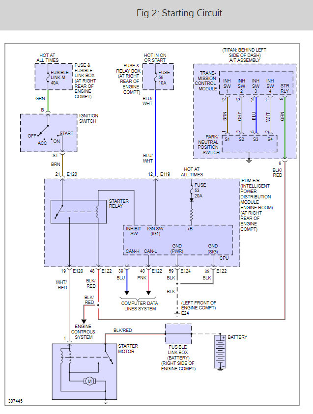

This is what I found.
Apr 1, 2018 at 4:19 AM
  • 55,412 POSTS

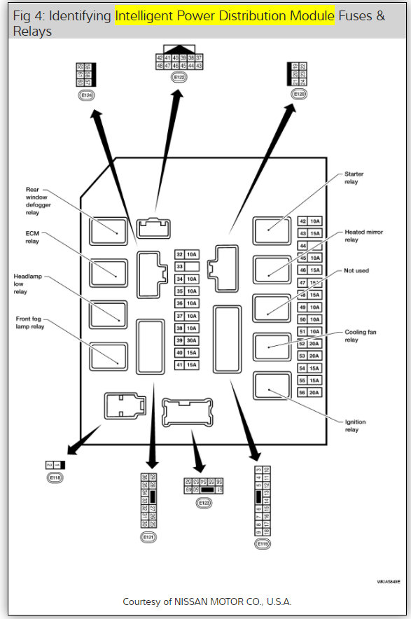

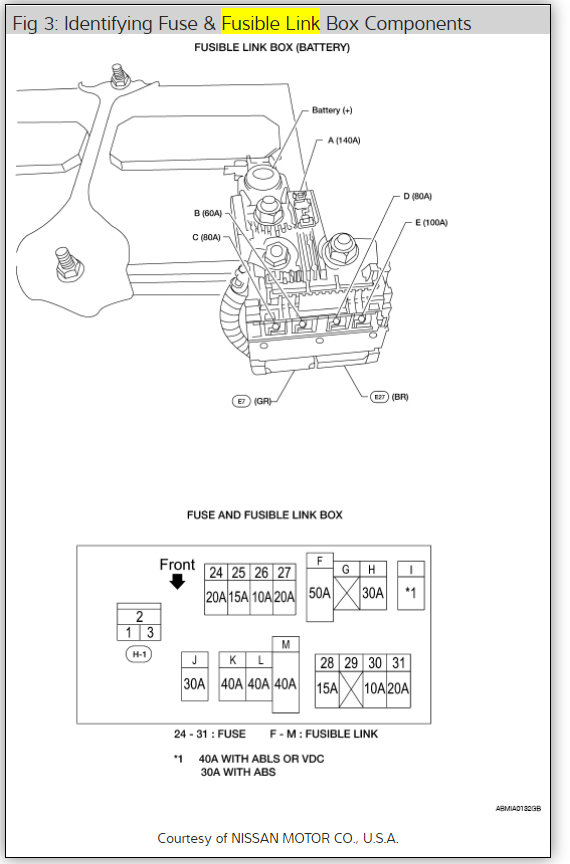

The transmission range sensor is located at the transmission. Here is a wiring diagram and a guide so you can test to see where you are losing power. The range sensor is on the transmission where the link cable connects.
There is a starter relay I would check as well.
Here is the starter relay location (below).
Please run down these guides and report back

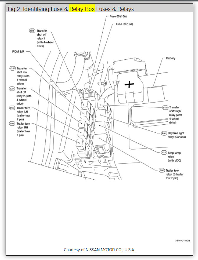

  • 55,412 POSTS

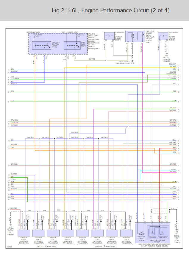

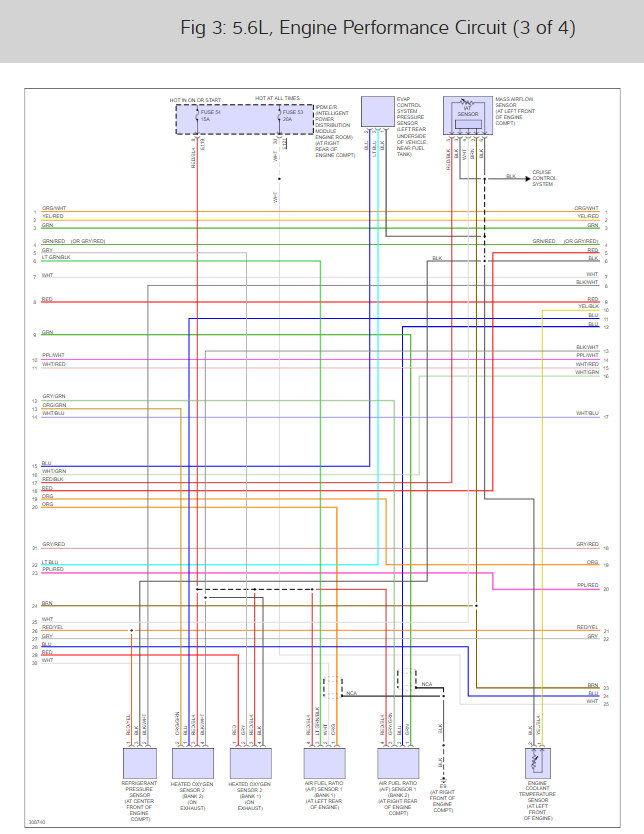

Good then it sounds like you have a fuel pump relay or you lost power to the relay. Here are the engine and fuel pump wiring diagrams so we can test for power. The fuel pump relay is located in the IPDM under the hood.
Apr 16, 2018 at 2:42 AM

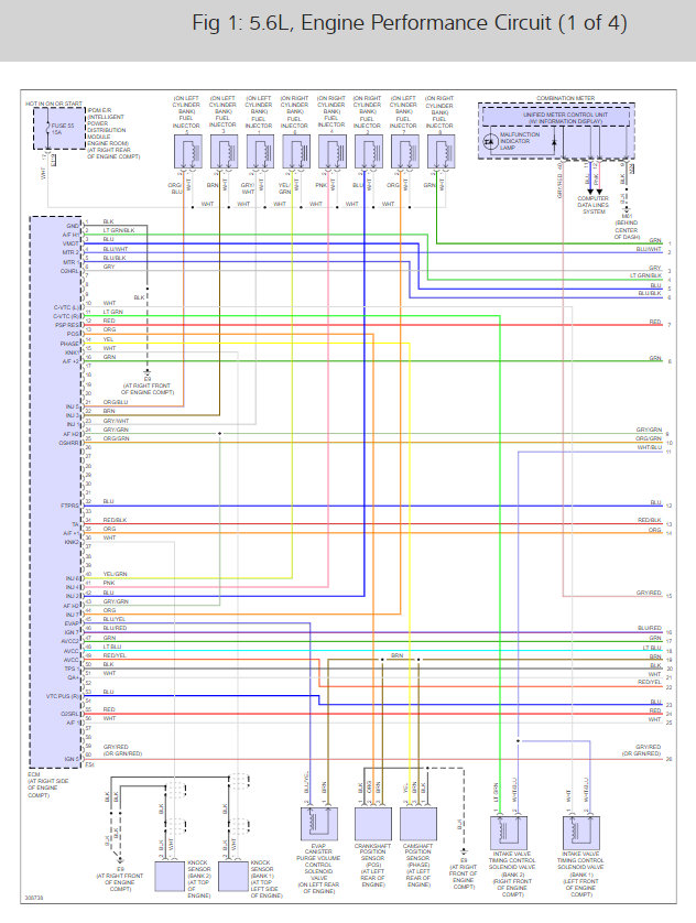

  • 55,412 POSTS
I have an idea can you please check the ignition for spark?
Here is a guide please check toward the bottom:
I am thinking the crankshaft sensor could be out which will cause the fuel pump relay not to come on.

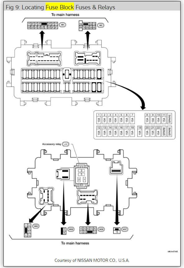

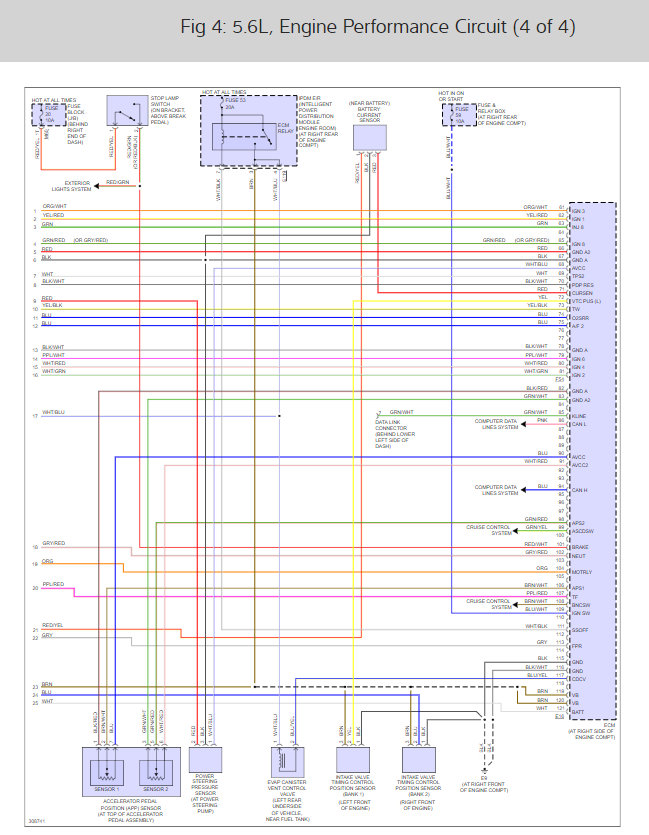

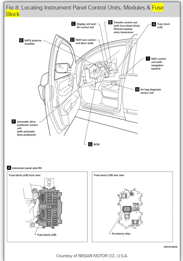

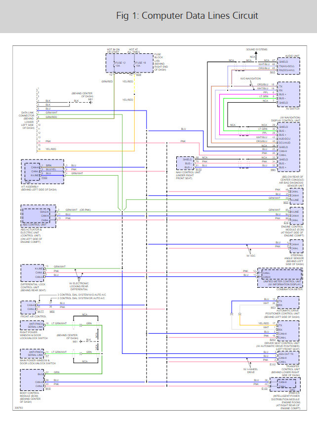

Okay, we are getting closer. When you run the codes did any come up? Also, lets check the fuses #12 and #19 to see if they have power with the key on?
Here is a wiring diagram to help you see how the ALDL is wired
Check out the diagrams (below). Please run this test and get back to us.

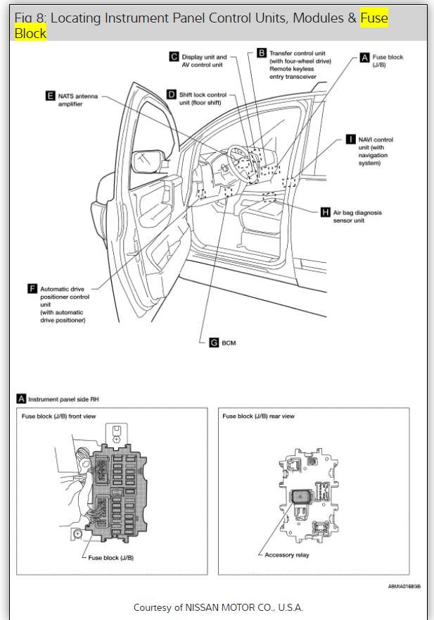

  • 55,412 POSTS
Did you check the fuses #12 and #19 with the key on to see if they have power?
May 17, 2018 at 3:14 AM
CIARA VANLANDINGHAM
  • 25 POSTS
I am trying to find them.
May 17, 2018 at 3:15 AM

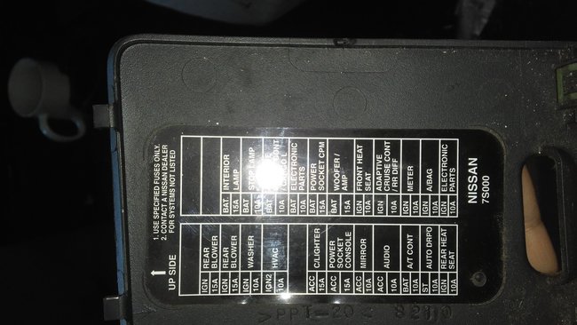

  • 55,412 POSTS
There are in the under dash fuse panel check out the fuse location and ID in the post on the previous page.
May 17, 2018 at 3:22 AM

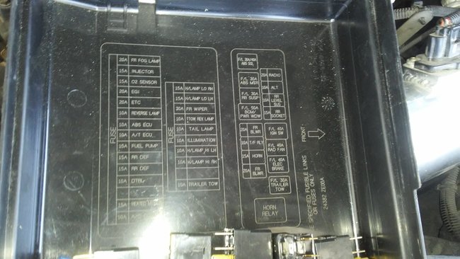

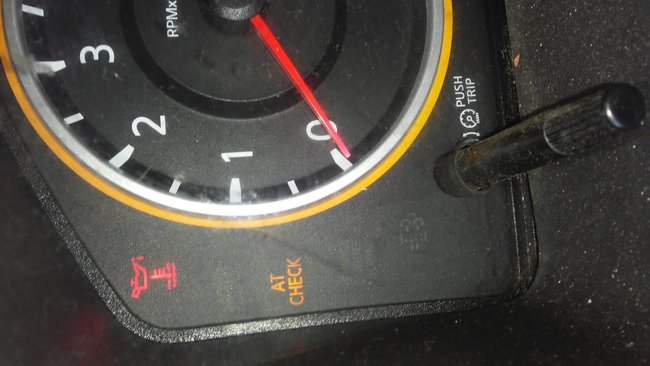

CIARA VANLANDINGHAM
  • 25 POSTS
Okay, I checked those two fuses and they were fine, I am sending you a diagram of what my fuse panel looks like and also I never noticed this before but when I went to start the truck after this sign flashed saying at engine and then it went away.
May 17, 2018 at 3:53 AM
CIARA VANLANDINGHAM
  • 25 POSTS
These are the images.
May 17, 2018 at 4:00 AM

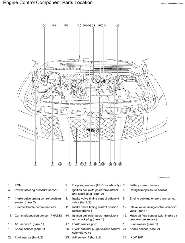

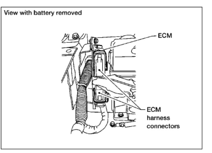

  • 55,412 POSTS
Was this truck in a flood by chance? It sounds like the PCM is bad. I would do a pin to pin check on the wiring and then try a new PCM a shop may need to program it for you. I would try a used one to see what happens you can get one from a wrecking yard.
May 18, 2018 at 2:29 AM
CIARA VANLANDINGHAM
  • 25 POSTS
Never flooded. What PCM?
May 18, 2018 at 2:41 AM
  • 55,412 POSTS

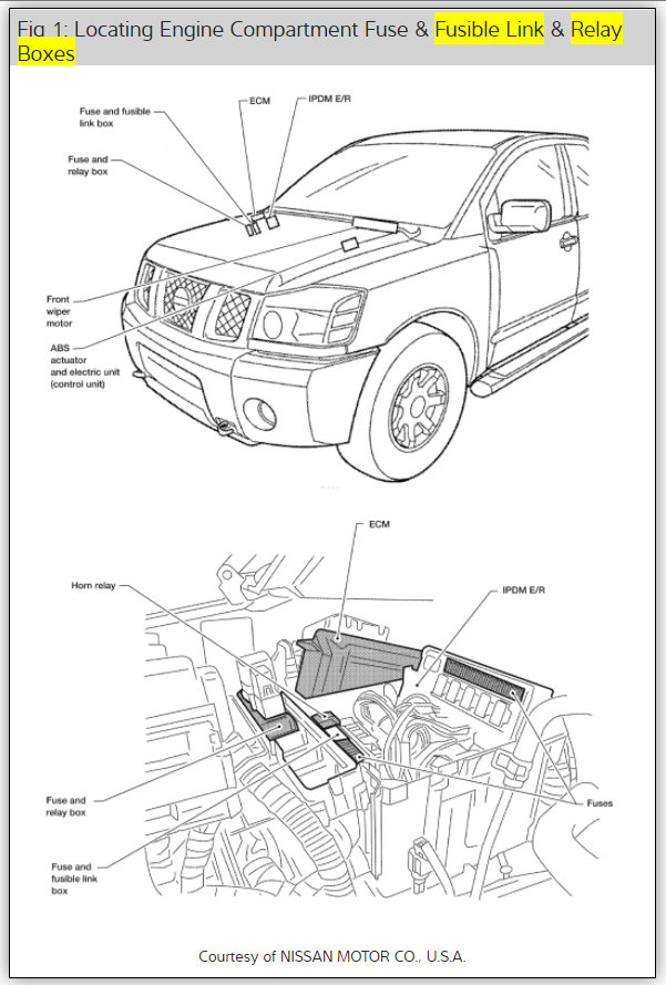

The PCM (ECM same thing ) is the engine computer. Here is the location.
May 18, 2018 at 2:55 AM
