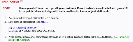

After driving from cold engine for about 10 minutes, while in Drive and stopped, I can't get the gear shift into Reverse or Park. The gear shift only moves between N, D-S, and L.
I let the car sit over night, but the problem persists.
This happened once before several weeks ago, but it apparently fixed itself after 20 minutes or so.

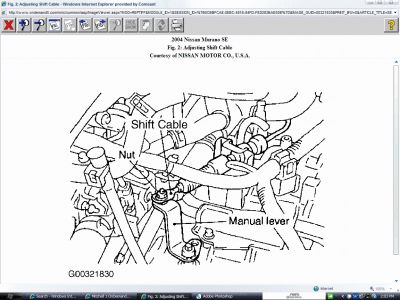

I think you got luck once before! I think you need to adjust the shift cable, here's a diagram, and instuctions...
https://images.2carpros.com/forum/automotive_pictures/62217_Muranoshift1_copy_1.jpg
https://images.2carpros.com/forum/automotive_pictures/62217_Muranoshift_1.jpg
https://images.2carpros.com/forum/automotive_pictures/62217_30961_mitchell_2_64.jpg
