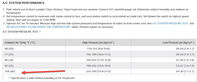

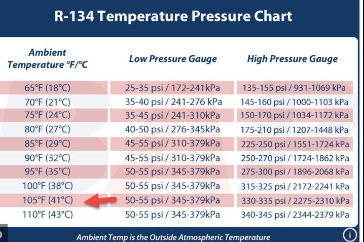

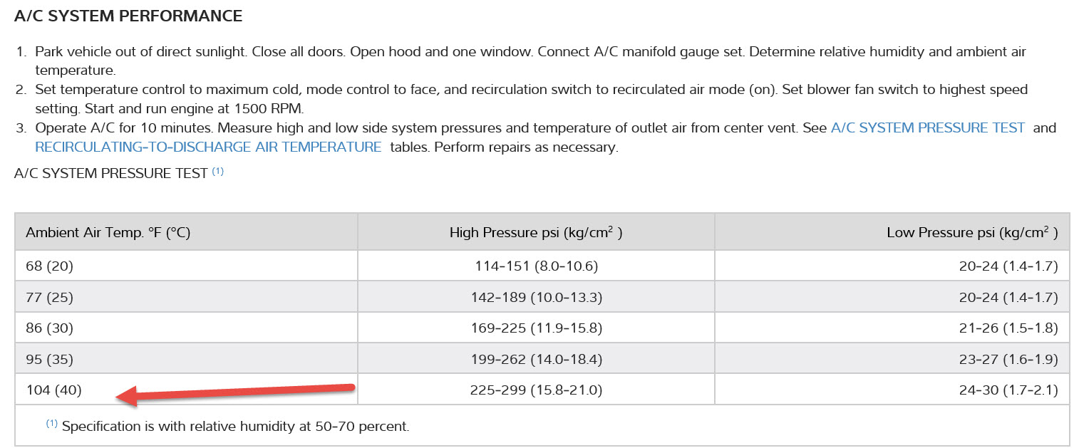

Your compressor may be on the way out see temp/pressure chart low side is ok but high side is to low should be higher. See pressure charts you might try letting a little Freon out as it may have to much in system.

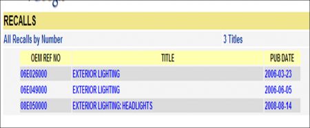

Also, it looks like you may have some recalls on your vehicle. The dealer may fix these for free. Please contact the dealer service department, give them the VIN number of your car and have them check on these to see if they apply to you.
https://www.2carpros.com/forum/automotive_pictures/248015_Recalls_11.jpg

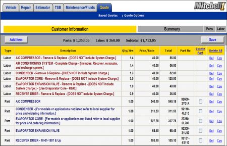

The AC. . ..wow. . .. . .. . .. . .. . ..I would say about $2000. . .. . .. . .. . .if all is bad. . ..the quote is below on what we figure.
https://www.2carpros.com/forum/automotive_pictures/248015_Quote_3.jpg
It also depends on what is wrong. . ..the only way to find out for sure is if you have someone test it and they tell you. . .. . .. . ...if the compressor shelled. . ..then you can bet you need to pretty much replace it all. . .. . .. . .. . .. . .. . .

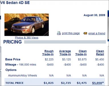

Also I have attached what the car should cost you. . .. . .. . .. . .. . .but condition is a big factor.
https://www.2carpros.com/forum/automotive_pictures/248015_Picture4_26.jpg
