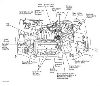

KRAZY_STUD2008
my 1998 nissan maxima is hard to start and engine light is on.just had a used engine put in.code comes up 1335.what does that mean?
Jan 9, 2020 at 3:48 AM (Merged)
DOCFIXIT
  • 18,828 POSTS
Code is for Crankshaft Position Sensor located near crankshaft by oil pan.
https://images.2carpros.com/forum/automotive_pictures/198357_Graphic_98.jpg
