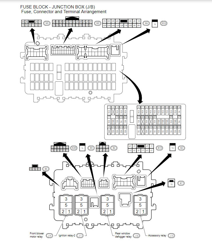

My air conditioner is not working?
2019 NISSAN ALTIMA
6,965 MILES • 2.0L • 4 CYL • 2WD • AUTOMATIC
ALEX LOZANO
I recently bought this car from an auction. The only issue with car was that the bumper was sunk in a little bit, but no damage to the radiator or A/C compressor or any other A/C component, my question is were can i locate the fuse to the A/C or relays. My guess is that it could be something electrical.
Jul 15, 2019 at 7:26 PM
STEVE W.
  • 15,200 POSTS

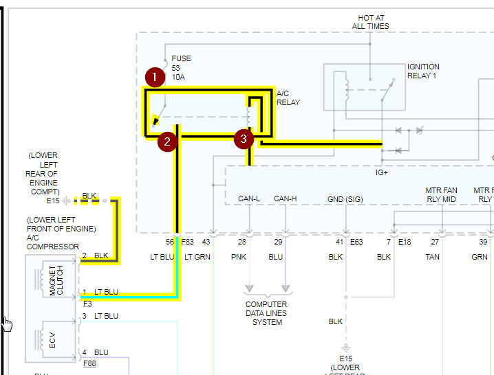

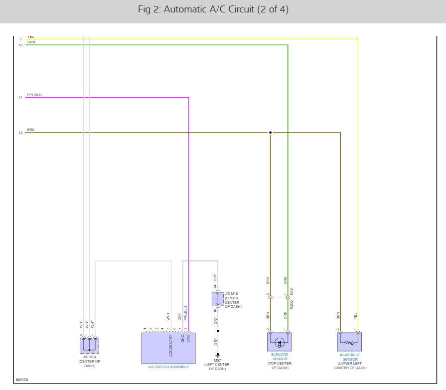

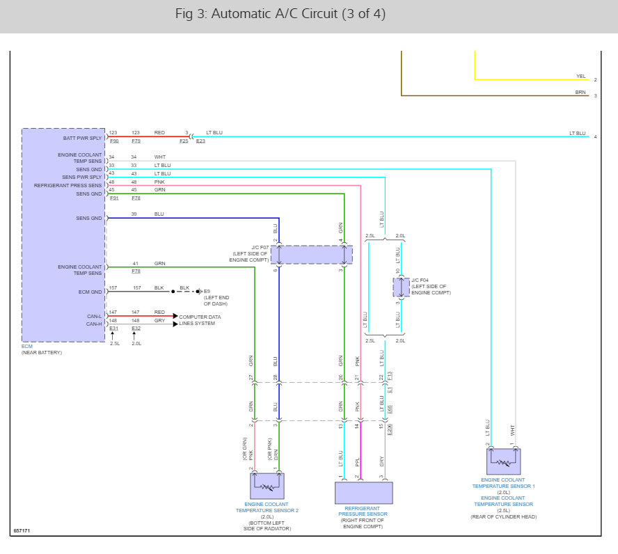

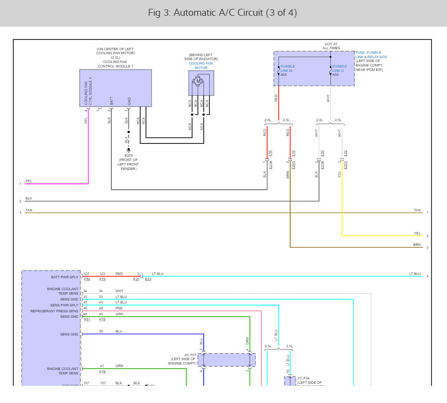

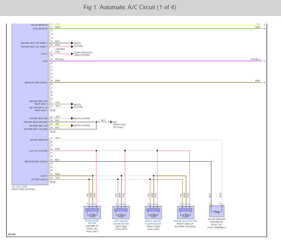

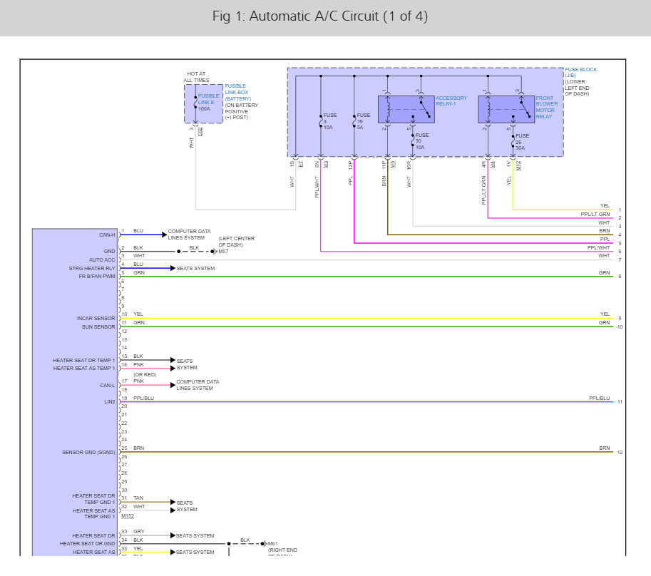

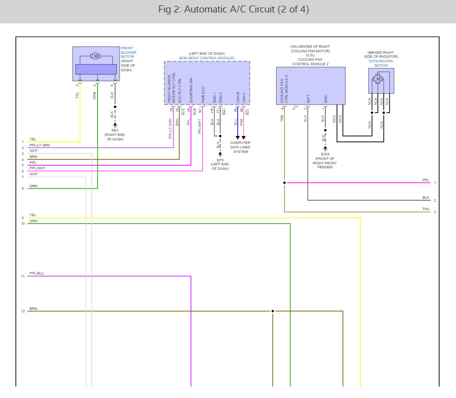

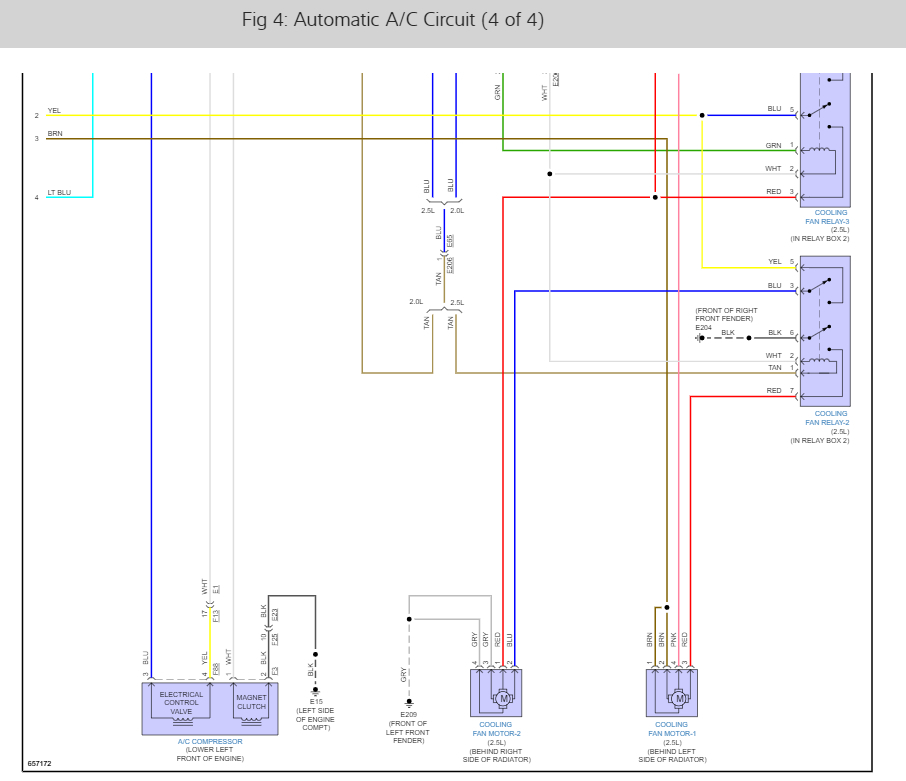

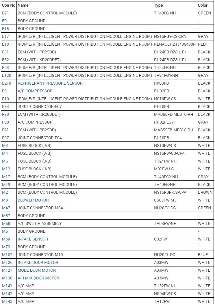

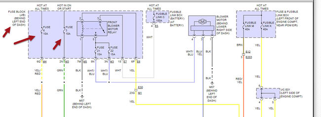

this does sound like a fuse is blown here is a guide to help check them with the fuse location in the diagrams below. On the left side of the dash check fuse # 3, 19 and 26.
Here are the fuse location and I have also included the AC wiring diagrams so you can see how the system works. Check out the diagrams (Below). Let us know what happens and please upload pictures or videos of the problem.
Jul 15, 2019 at 7:57 PM

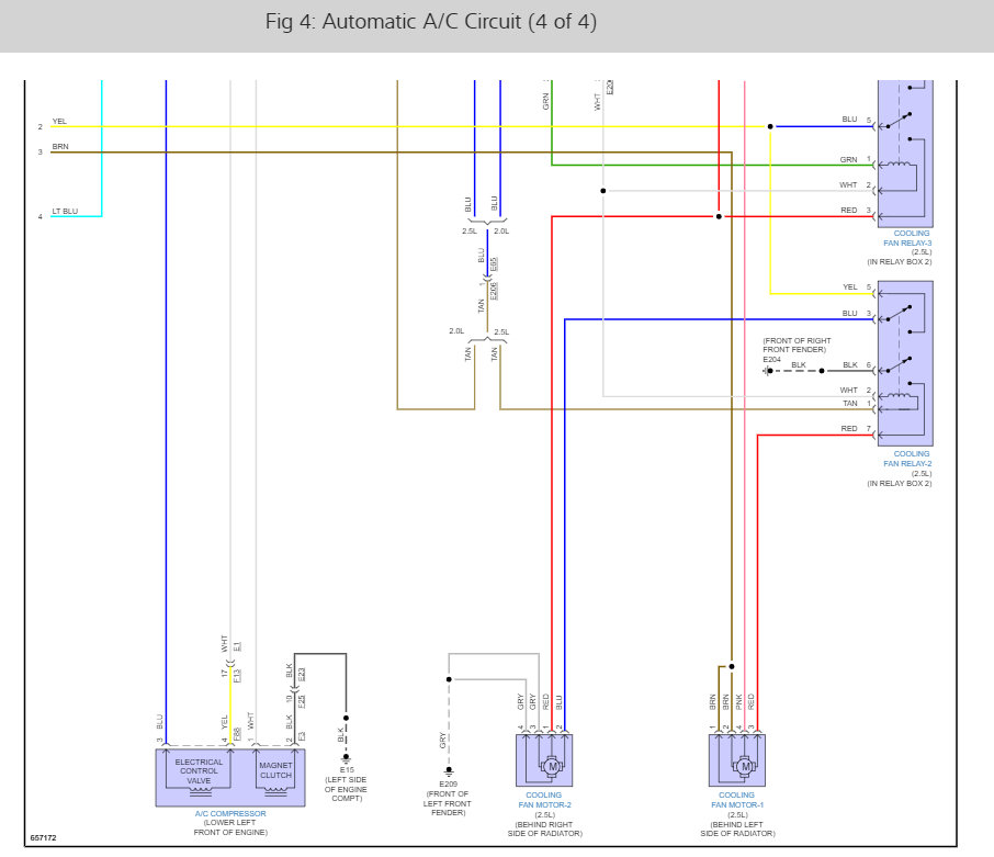

Well step one would be to actually put a gauge on the system to see if there is a charge in it. Could be that they evacuated the system, or that there was a leak in the system.
However, let's assume they didn't this system uses a throttling valve compressor with a magnetic clutch. Power wise there are two fuses fuse # 44 a 10 amp is in the fuse box under the hood. It only controls the valve in the compressor. Fuse # 30 sends power to the AC switch from the accessory relay, both of those are in the junction box in the dash. Other than the compressor and the pressure sensor (part of the condenser in the front of the car) the rest of the pieces are internal to the ECM and BCM. Does the rest of the heating system work? The doors all seem to be okay and you can select hot/cold and defrost, dash, floor? That would show that fuse 30 and the accessory relay are working.
To test the AC clutch you just need to disconnect the plug from the magnet coil and use two leads connected to the battery to apply voltage to the terminals. If the clutch activates it is OK.
The pressure sensor does both low and high pressure but there are no specs listed in how to test it. Every test they show requires a OEM level scan tool.

BLAINE1072
I found the blown fuse # 19 all fixed thank you.

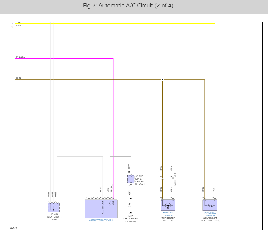

JURIS BERGS
The air conditioner in my wife's car cools the cabin only when set on manual and not auto. A local air conditioner shop wants to replace the compressor, which I'm hesitant to do because the same shop previously wanted to replace the compressor in my 2005 Mercedes-Benz E320 after the compressor had already been replaced by a European car specialist a few months earlier. Upon taking this car back to the European car specialist, it was determined that just a recharge was needed in spite of the fact that the air conditioner shop said that no recharge was needed. Thus, I no longer trust the opinion of the air conditioner shop.
The air conditioner control in the car listed above appears to be functioning normally except for the air blowing cold only when the system is set on manual.
May 25, 2021 at 11:24 AM (Merged)
STEVE W.
  • 15,200 POSTS

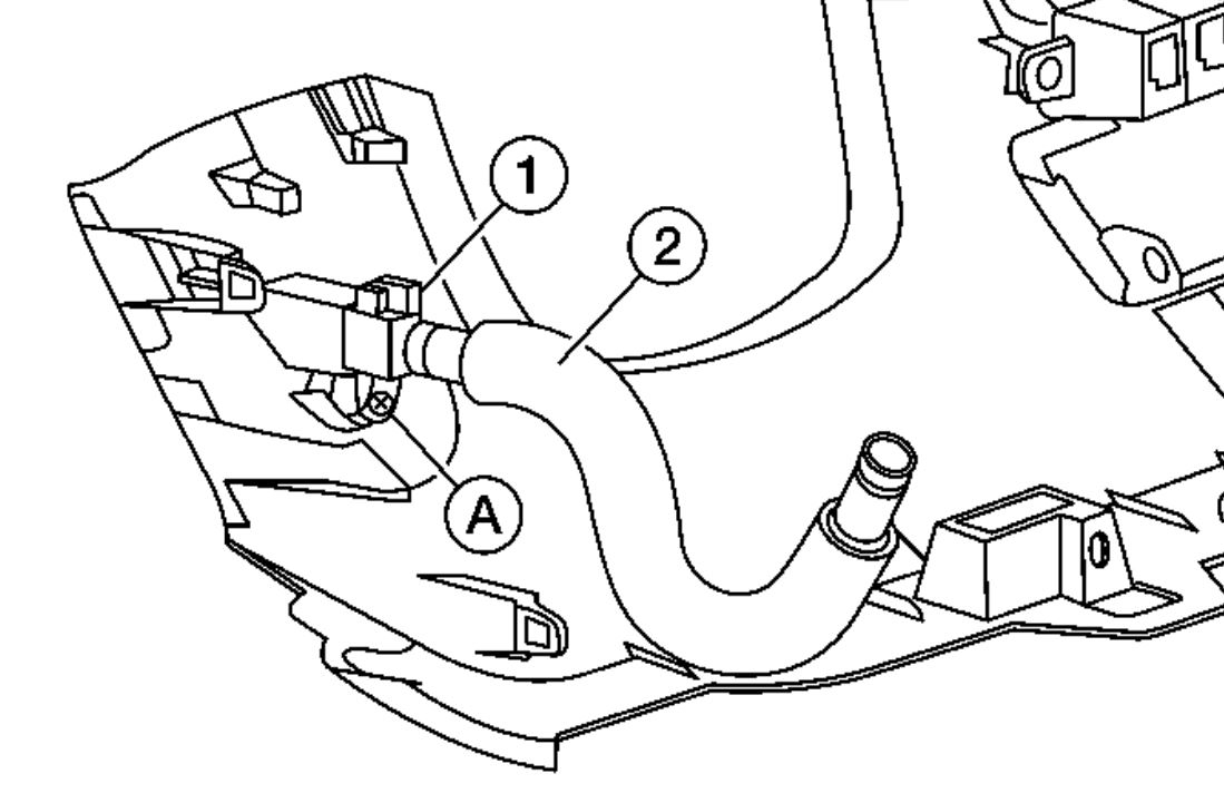

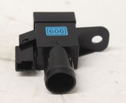

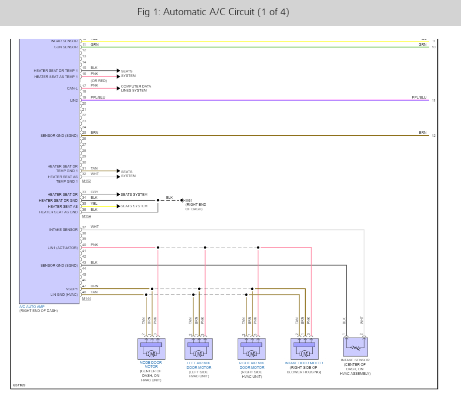

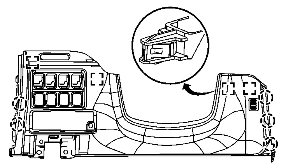

As it works on manual and not automatic makes me think it is related to one of the temperature sensors that tells the system how hot or cold the interior is. If it was the compressor it wouldn't work in either mode. The primary sensor is the one behind the panel under and to the right of the steering column. If it fails the controller thinks that it is cold in the vehicle and will not operate the A/C. There is also a sensor on the intake area of the HVAC case that performs a similar function but detects the air temperature inside the case to keep the system from freezing up if it's humid. In this case I would use a scan tool to verify the issue first and be sure that it isn't one of the other sensors, however if you just wanted to toss a sensor in they run about $20.00 or so which is cheaper than most places will do diagnostics for. That would be your call.
To access it you need to remove the lower panel. To start you remove the instrument side trim panel using a trim stick or plastic putty knife..
The panel is attached with clips and hooks, you use a trim tool to gently pry them loose
Broken square indicates: Metal clip Broken circle indicates: Pawl
Now tip the panel down enough that you can remove the sensor wiring and the sensor from the panel. Reverse the process to reinstall the sensor and panel.
Or have a shop run the diagnostic and see what it shows. As the system operates in manual mode it has to be an issue in the automatic controls, not the mechanical side of the system, something like a bad compressor or low charge would make it stop working completely.

The cabin temperature sensor is the one inside the car that I covered in that post. The ambient temperature sensor tells the system what the exterior temperature is. The cabin sensor is part 277203AA0A and is in the dash as I stated in the post above. It tells the system what the interior temperature is.

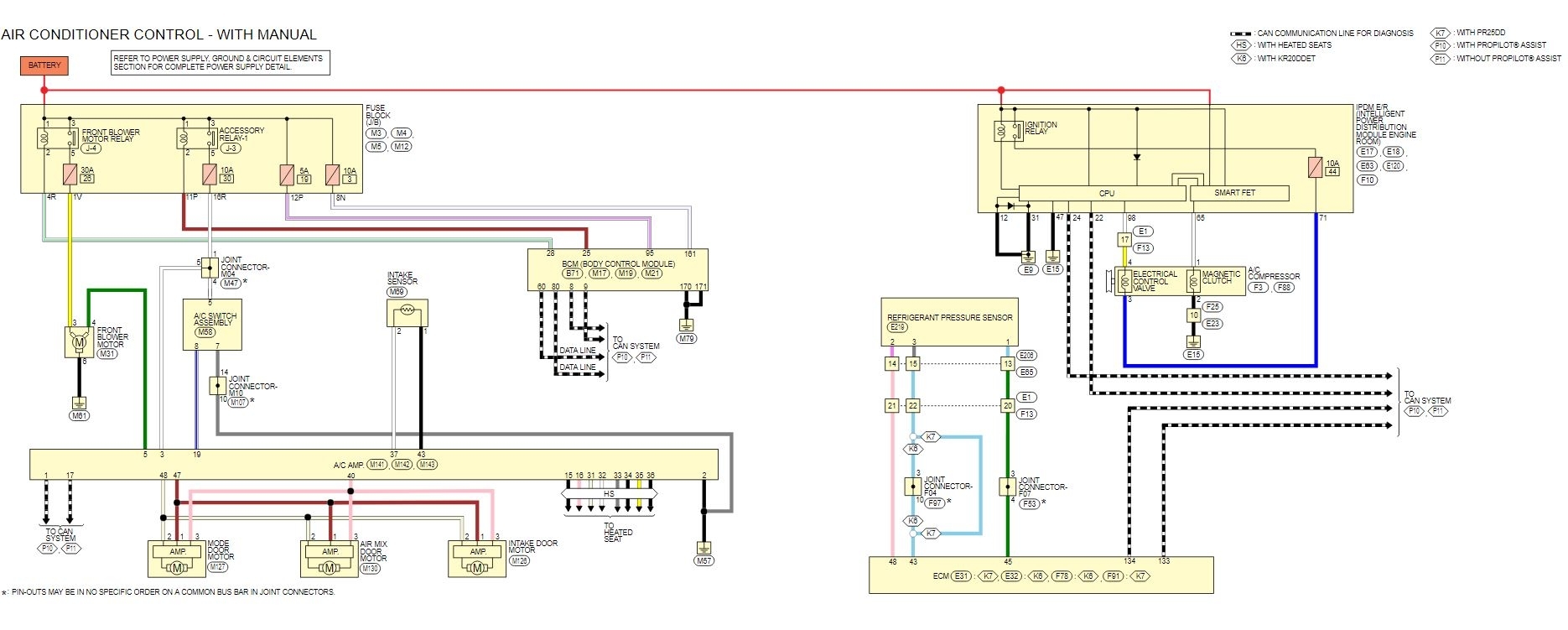

The A/C compressor is not engaging and air does blow, it is not warmer, does not make any noise nor is there a smell. I did take it to a local shop, they advised I take it to a dealer. They stated that the refrigerant is good, fuses are good. No power to the compressor, possible PCM issue. Could this be explained and possible fix I might be facing?

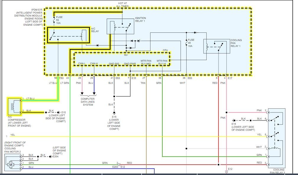

It is doubtful that this is a PCM on this vehicle. If the compressor is not getting power then the more likely cause is a relay so we need to test this and make sure they are checking this properly.
Here is a guide that will help with this:
The PCM is responsible for grounding the control side of the relay which will close the relay and send power to the compressor through the light blue wire shown below on the wiring diagram.
So we need to go to the relay and check for power on the wire coming from the fuse (number 1). If you have it, jump power to the terminal of the relay that leads to the compressor (number 2).
This will apply power to the compressor and prove that it works.
Then we can test the control side by seeing if the PCM is grounding the relay. Put the red lead of your meter on battery positive, the black lead on number 3 terminal of the relay and then turn the AC on. If the PCM is grounding the relay properly you will have 12 volts on your meter.
If it is not, then we need to check pressures again because I doubt this shop actually checked them.
Once we know the pressures we will have a better idea if the PCM is the issue.
Thanks

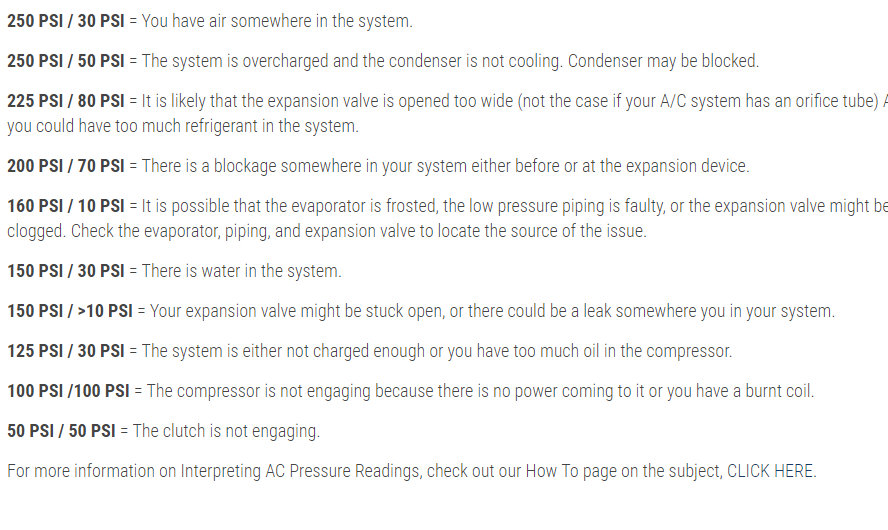

We need to start with what the actual A/C pressures are. You could have a restriction in the system but we can find this out with what the high and low side pressures are and go from there.
If you don't have a gauge set then you can rent those from most parts stores that have a tool rental program. Let's hook that up and see what they are with the compressor on and off.
Let's start here and see what they are telling us. Thanks

Most likely low in Freon but need to check. Is the compressor working when you turn it on? I attached a wiring diagram for to view if it is not working.
You need a set of gauges to see the actual high and low side pressures. Without pressure, it will not work.
https://www.2carpros.com/articles/air-conditioner-leak-detection
As far as the hose, yes, it will be cold when the A/C system is working correctly.

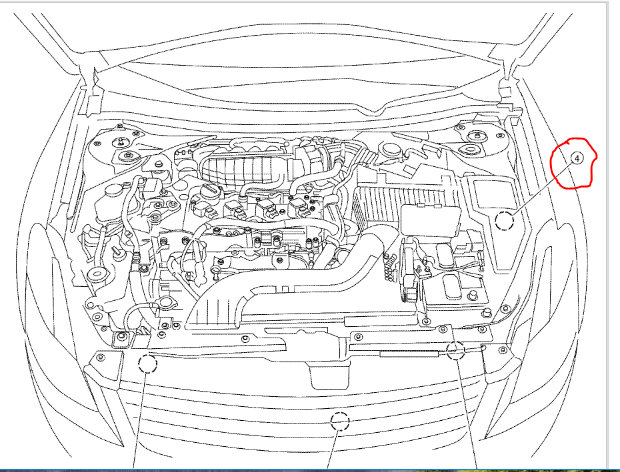

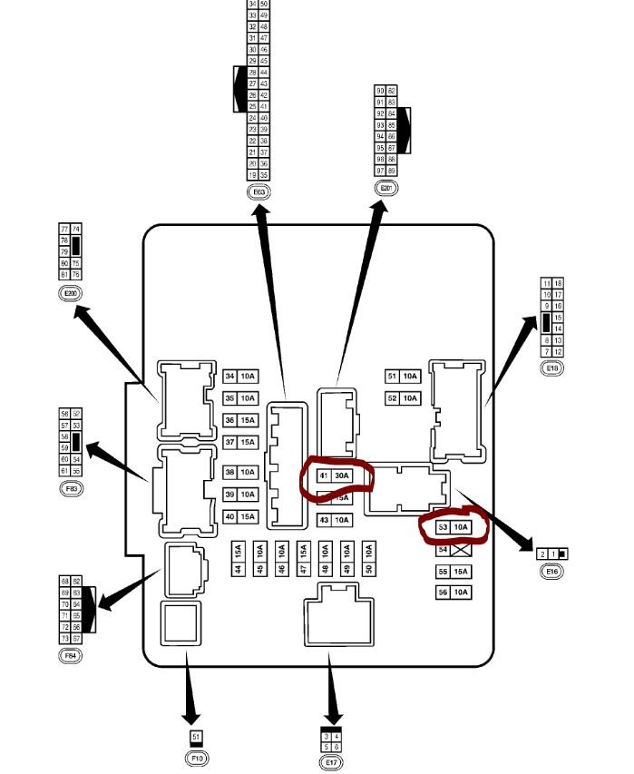

RAYALTIMA2013
The Freon charge test goes red. Clutch does not engage. Blower was checked and found clean and works well.The compressor control valve was replaced with new one.
Nothing happens. No cold air with A/C placed at max.
Dealer diagnostics pointed to the A/C compressor. It has to be replaced. Exorbitant price. Did not bite it.
But what they did not check is the A/C fuse. Based on video online the fuse box near the battery shows the fuse to be Red 10A which is found on top space at 2nd spot. Not sure if indeed this is the aircon fuse. But when we tested it, it was not blown but does not light up when tested.
Questions:
As described were we able to pinpoint exactly the real A/C fuse?
If it is, then where shall we look to make it work? If that is not the A/C fuse, where can we accurately find it?

What are the actual pressures in the system using a set of A/C gauges? Saying the gauge goes red sounds like one of the gauges on a can and if it's in the red the system is likely overcharged.
As for the fuses there are at least 4 different versions of that system. The 4 door manual system where you have a dial to control the temperature uses fuse #53 in the under-hood box. If you have the automatic system where you just set a digital temperature and it does the rest uses fuse #41 If you have the 2 door coupe then both use fuse #41 for the A/C clutch. Fuse 41 will be either a 10 amp or a 30 amp depending on which version of the car you have, Both 41 and 53 are circled in the image of the under-hood fuse block.

Hello, I'm Danny.

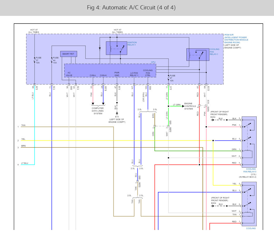

The relay is located in the IPDM (integrated power distribution module) under the hood.Here is a tutorial showing how to test a relay:
Relays are available at any local auto parts sores and generally run about $10.00. I've attached a picture below showing its location.Its location in the IPDM will be marked on the plastic cover.Hope this helps and thanks for using 2CarPros.

Let's start with the AC pressures with the engine off and then with it running. If the Freon is low then it will prevent the compressor from coming on.
If this is okay, then we can move onto the next item which will be making sure there is power to the compressor but let's start with what the pressures are.
