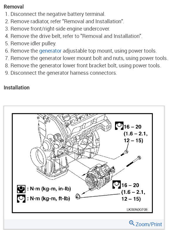

Need help changing alternator. I have changed several on old cars but I am not sure if it comes out the top or bottom. Also, what all has to be loosened/taken off for it to come out?
Jan 13, 2009 at 3:51 PM
GFIMOTORCARS
  • 673 POSTS

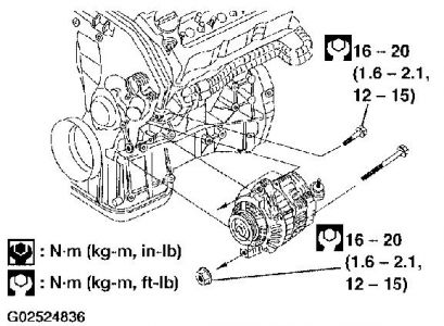

Here is the order in which you will want to remove this alternator: 1. Disconnect the battery 2. Remove the engine undercover 3. Remove the radiator (instructions below) 4. Remove your drive belt (instructions below) 5. Remove your enigne idler pulley 6. Disconnect the alternator wires 7. Remove the alternator adjustable top mount 8. Remove alternator lower bracket 9. Slide the alternator out, you should have plenty of room
https://images.2carpros.com/forum/automotive_pictures/294900_Alternator_1.jpg

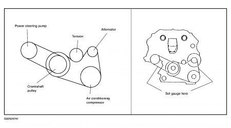

Radiator Removal 1. Drain coolant from radiator 2. Disconnect your upper and lower radiator hoses. 3. Remove your transmission cooler lines from the radiator and plug the lines. 4. Disconnect the reservior tank hose 5. Remove the radiator mounting brackets 6. Remove the radiator and radiator fan assembly Drive Belt Removal 1. Drive belt tension is relieved by using a wrench or ratchet and socket to turn tensioner bolt, see tensioner location in picture.
https://images.2carpros.com/forum/automotive_pictures/294900_Drive_belt_35L_1.jpg

That is correct. The MB symbol is for my repair shop here in California, we specialize in MB vehicles, but work on all makes. But yes this is for an 2005 Altima 3.5L V6. It will be a bit of a job but do not let the radiator removal discourage you. It actually is not terribly difficult and is really only held on by a couple of upper retainers that are easily removed from the upper radiator support. After you disconnect the hoses and transmission lines the radiator and fan will pretty much just slide out. But all in all this will be a good days work if your not familiar with the vehicle.

Hello, Thanks for the donation. To remove your vehicles generator (alternator) perform the following operations. This does require the removal of a few major components such as the radiator, so if you need further assistance with one of the removal procedures for a component such as the radiator, just let me know and I will post guidance. REMOVAL Disconnect negative battery terminal. Remove radiator. Remove front/right-side engine undercover. Remove drive belt. Remove idler pulley. Remove generator adjustable top mount, using power tools. Remove generator lower mount bolt and nuts, using power tools. Remove generator lower front bracket bolt, using power tools. Disconnect generator harness connectors. Slide generator out and remove. INSTALLATION Installation is in the reverse order of removal. Torque bolts to specifications listed on diagram below.
https://images.2carpros.com/forum/automotive_pictures/261618_Noname_131.jpg
Hope this helps.. Thanks for using 2carpros.com!

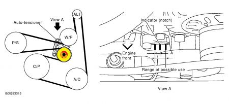

HOW DO I REMOVE BELT SO I CAN REMOVE ALT.
Sep 25, 2019 at 12:30 PM (Merged)
BMRFIXIT
  • 19,053 POSTS
loosing the belt by moving the tensioner pulley away from it

I have a 2.5SL. I have the top engine cover off, all bolts and electrical connections off, but I cannot figure out how to loosen the belt. The middle pully has a nut on the side that I removed, but that didnt do anything.
BLUELIGHTNIN6
  • 16,542 POSTS
CAUTION
Avoid placing hand in a location where pinching may occur if the holding tool accidentally comes off.
CAUTION
Do not loosen the auto-tensioner pulley bolt. (Do not turn it counterclockwise.) If turned counterclockwise, the complete auto-tensioner must be replaced as a unit, including pulley.
While securely holding the hexagonal part in pulley center of drive belt auto-tensioner, move in the direction of arrow (loosening direction of tensioner) using tool.
Insert a rod approximately 6 mm (0.24 in) in diameter through the rear of tensioner into retaining boss to lock tensioner pulley.
Leave tensioner pulley arm locked until belt is installed again.
Loosen auxiliary drive belt from water pump pulley in sequence, and remove it.
CAUTION
When installing, do not loosen the auto-tensioner pulley bolt. (Do not turn it counterclockwise.) If turned counterclockwise, the complete auto-tensioner must be replaced as a unit, including pulley. Avoid placing hand in a location where pinching may occur if the holding tool accidentally comes off. Confirm belts are completely set on the pulleys.
NOTE
Turn crankshaft pulley clockwise several times to equalize tension between each pulley. Confirm tension of drive belt at indicator (notch on fixed side) is within the possible use range.
To install, reverse removal procedure.

  • 75,988 POSTS
Removal
Disconnect the negative battery terminal.
Remove radiator.
Remove front/right-side engine under cover
Remove the drive belt.
Remove the generator adjustable top mount, using power tools
Remove the generator lower mount bolt and nuts, using power tools
Remove the generator lower front bracket bolt, using power tools
Disconnect the generator harness connectors.
Slide the generator out and remove.
Installation
To install, reverse the removal procedure.

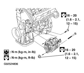

DAVE H
  • 13,383 POSTS
Removal and Installation
QR25DE
Removal
Remove the front/right-side engine undercover, using power tools.
Disconnect the generator harness connector.
Disconnect the engine ground wire from top mount.
Remove the generator upper and lower mounting bolts, using power tools.
Set the generator aside and remove the generator top mount.
Fig. 63: Removing Generator Upper And Lower Mounting Bolts
Courtesy of NISSAN MOTOR CO., U.S.A.
Installation
Fig. 64: Removal Procedure (QR25DE)
