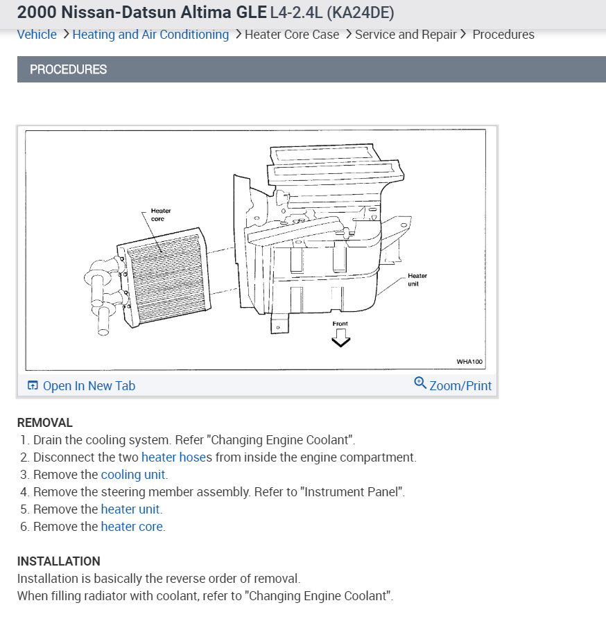

How do I replace the heater core and does the dash pad clip have to be removed? I removed the glove box door and the casing around the core, but there seems to be something holding it from the rear near the fire wall?

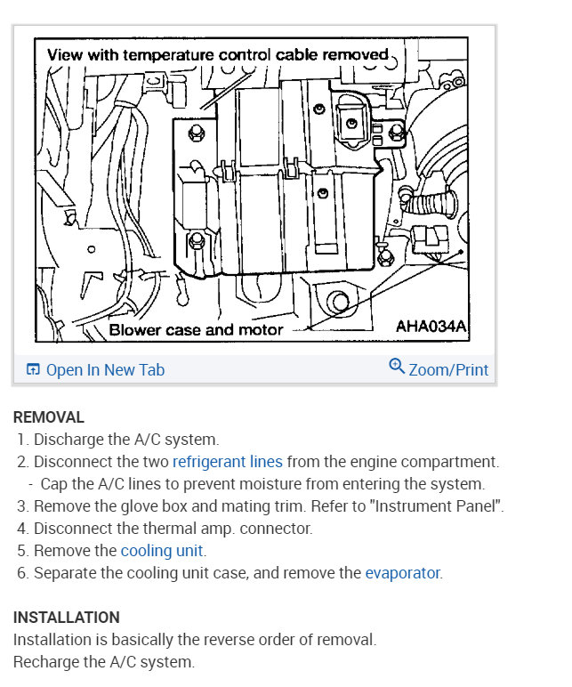

Here is a guide that will walk you through the steps with the heater core replacement instructions in the diagrams below for your car.
https://www.2carpros.com/articles/replace-heater-core
