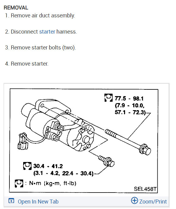

My 94 300zx wont start when you turn the key. The radio turns off and the antenna will lower but all the lights in the dash stay on. The engine will not turn over and the starter wont click. Battery power is good.

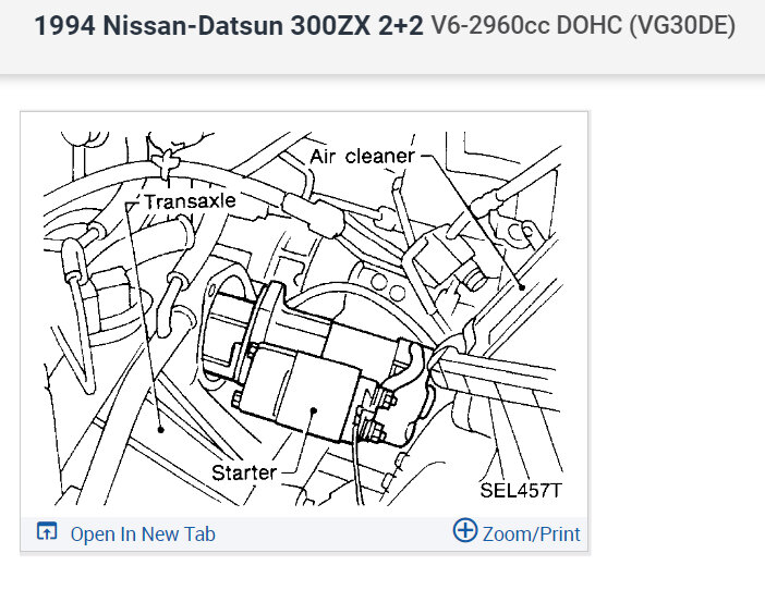

to me it sounds like the starter motor is bad, please go over this video to see what I am talking about.
https://youtu.be/6YRW8fyNudY?si=Bs5NGKfAWRsNv-BL
Also, this guide can how you how to check for power at the trigger wire.
Here is how to change the starter motor out in case you need it. Check out the images (below). Let us know what you find.
