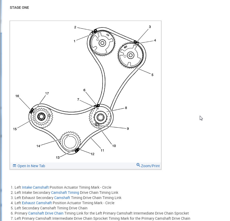

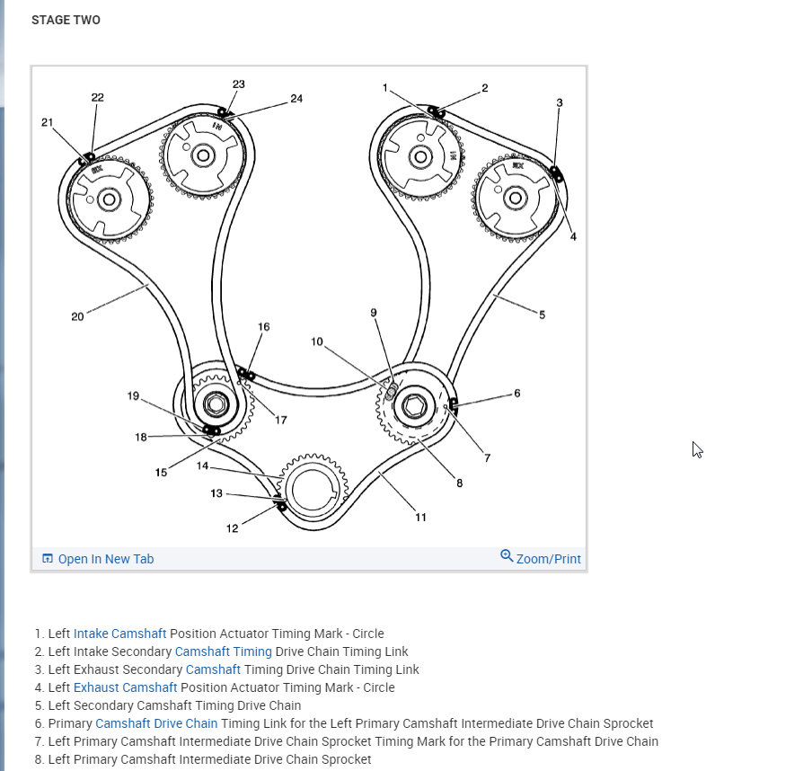

Installed a timing chain kit on the car listed above.
Car starts and has slight misfire 1-3-5 and doesn’t seem to want to idle but if you give it a little gas the idle smooths out. No timing codes or correlation codes
Just 0300, 0301, 0303 and 0305.
Timing marks liner back up after cranking engine a few times. I did stage 1-2 timing when reinstalling to all data specs.

Clearly a safe assumption but you did the timing chain on the right bank (passenger side)?
What was the reason for replacing the timing chain and were there misfires like this before hand?

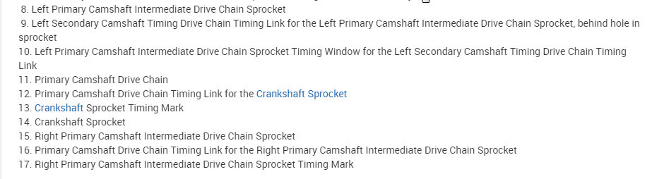

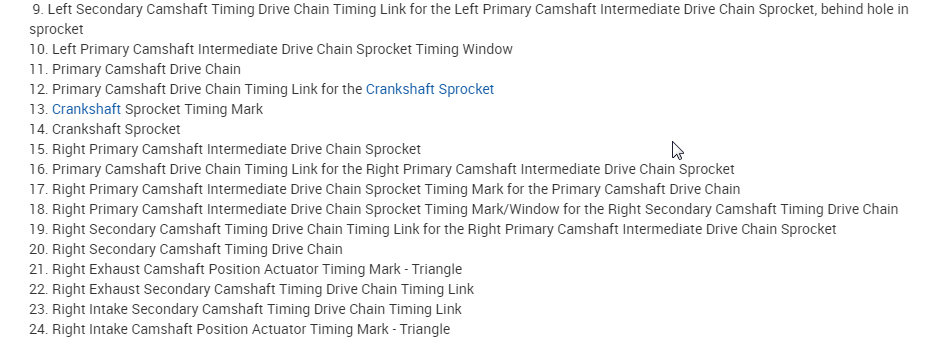

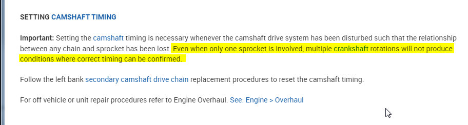

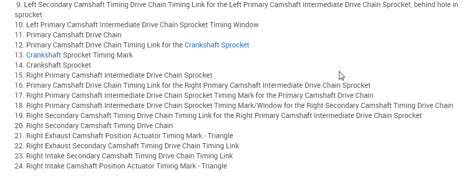

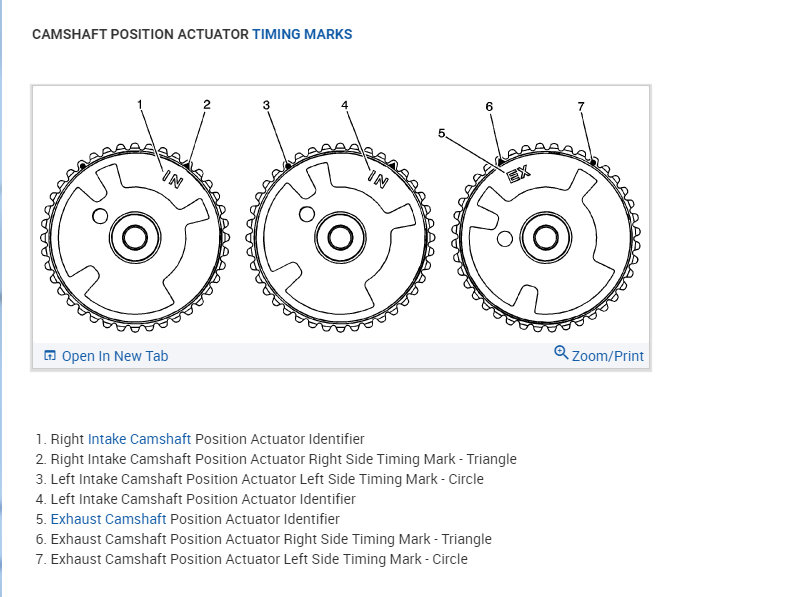

The fact that we have these misfires on all cylinders we need to ensure timing is correct. As you will see from the highlighted portion, just rotating the engine over to see if the marks are aligned is not how we confirm timing.

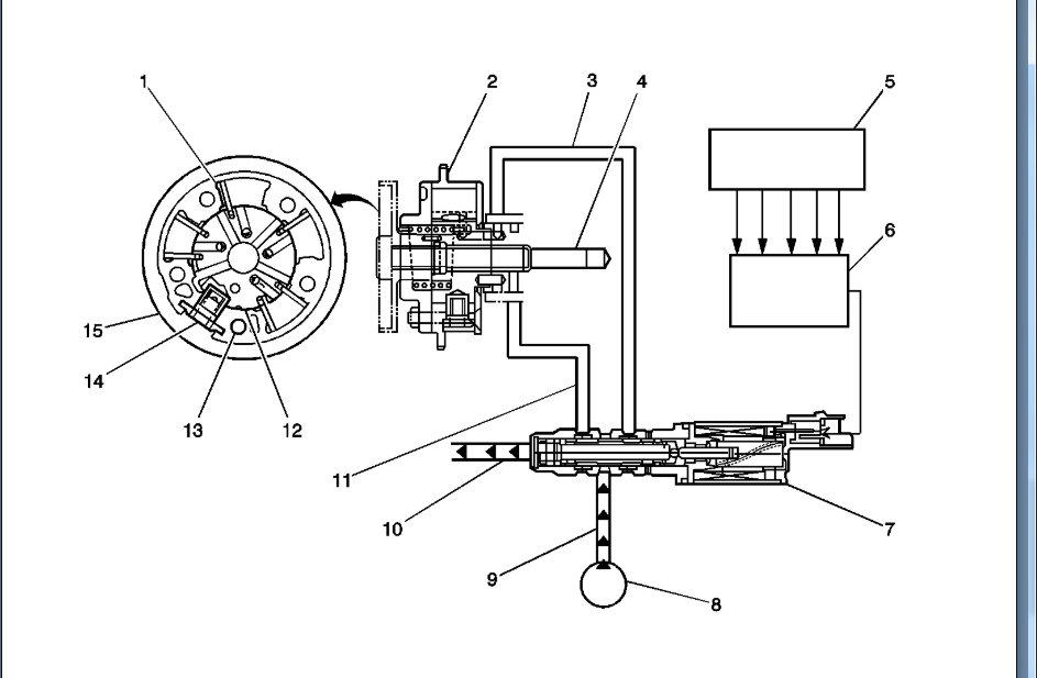

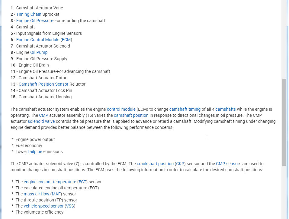

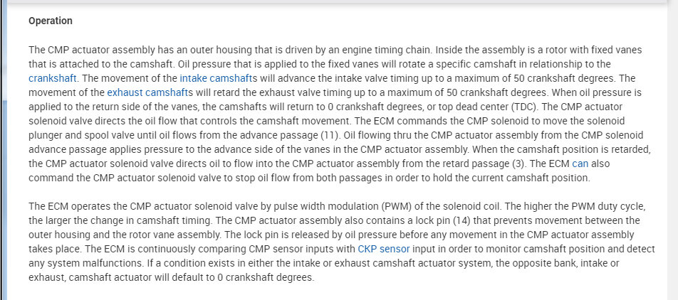

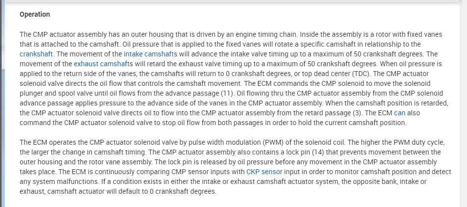

However, before we reset timing we need to remove the OCV and check the screen for metal. If there is metal it will obstruct the operation. The OCV is the center bolt in the front of the camshaft. Also, we need to make sure the phaser is returning to the lock pin when the engine is off.
If this checks out then we need to do a compression check but we will get to that after this.
Let's start with this information and go from there. Thanks
