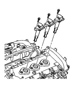

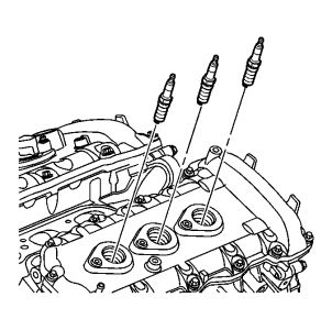

6 cyl All Wheel Drive 100,00 miles
I have a friend who whats me to do a tune up on her car , and its a cts how hard is it to do the tune up on those cars.and where are the spark plugs located,and are they hard to get to.

Hi shaunabay, Tune up nowadays is only checking/replacement of the normal maintenance items, eg. plugs, oil, filters and fluids. Here is a guide that will help you as well. https://www.2carpros.com/articles/how-to-tune-up-a-car-engine
https://images.2carpros.com/forum/automotive_pictures/192750_CAL5E8F4Coil_1.jpg
https://images.2carpros.com/forum/automotive_pictures/192750_CA2JFE87SparkPlugs_1.jpg
