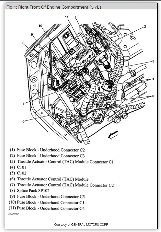

Where is the TAC module located?

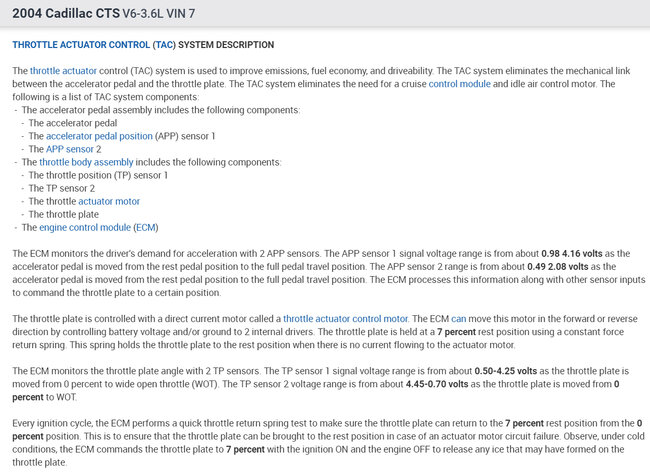

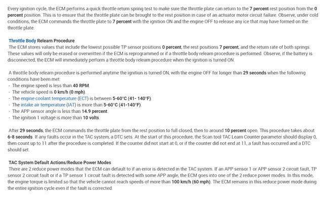

The throttle control module is located under the hood on the right side. Here is a diagram to help you find it (below) Please let us know if you need anything else to get the problem fixed and I have included how the TAC module works
