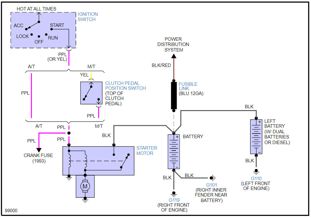

new starter wont turn over
1993 CHEVROLET SILVERADO
150,000 MILES • V8 • 2WD • MANUAL
DROESSLER
New starter wont turn over
Mar 7, 2022 at 3:00 AM
  • 55,273 POSTS
Does it make any noise? Can you please shoot a quick video with your phone so we can hear the noise? That would be great. You can upload it here with your response. Also, here is a guide to help you see what's going on, if no noise is heard use a test light to see if you are getting power to the solenoid:
Here is a wiring diagram so you can see how the system works:
