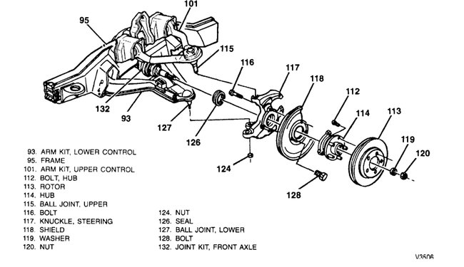

https://www.2carpros.com/articles/how-to-release-a-ball-joint
Lower Ball Joint Replacement
Removal
Tools Required
J 24319-01 Steering Linkage Puller
J 36202 Torsion Bar Unloading Tool
J 29193 Steering Linkage Installer
J 9519-03 Ball Joint Remover and Installer
J 41435 Ball Joint Remover and Installer Kit
Consisting of J41435-1 Remover, J 41435-2 Installer, J 41435-3 Remover/Installer.

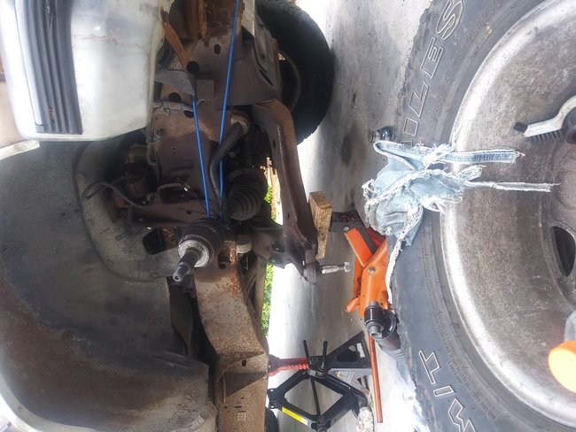

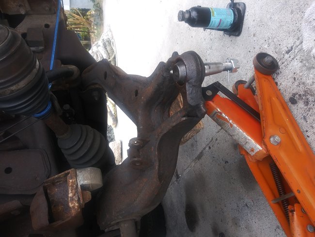

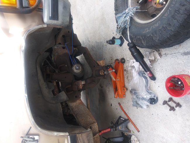

I am using the 67045 kit from the auto O'Reillys. here's the work I've gotten done so far:
Nov 26, 2020 at 5:24 AM
I would suggest releasing the torsion bar and removing the control arm and working on it n the bench to get it in all the way.
Nov 26, 2020 at 7:13 AM
POOPYRYA
  • 17 POSTS
That helped, thank you! Just releasing the torsion bar was all I had to do, didn't have to take off the control arm at all! Lucky me, thank you!
