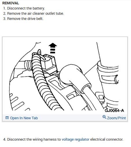

I have the Sport model. I was going down the road and it made this loud click click click noise and shut off. When i tried to start it back it would click and kind of wine but would not turn over. Got it towed home and changed the starter and it still just has a click and kind of wine and will not turn over. And when i do try to turn it over, it also automatically locks the doors. What could the problem be? Has new battery also.

Hello and welcome to 2CarPros. There are more than a couple of things that you could be describing. If I had to guess, I'd say that your battery died, likely due to a failed alternator. Get a jump start and see if that helps any. If so, then the car will probably run for a bit until the battery dies again, and then you'll be back to square one, but armed with some knowledge. If you can't get it to jump start, then please take a good video of the problem, post it here, and we'll try to troubleshoot it that way.
Here's how to do a jump start:
https://www.2carpros.com/articles/how-to-jump-start-car-battery-using-jumper-cables

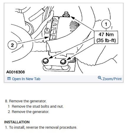

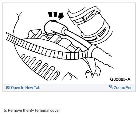

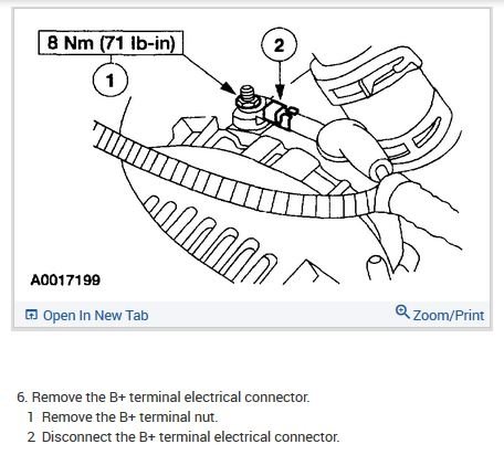

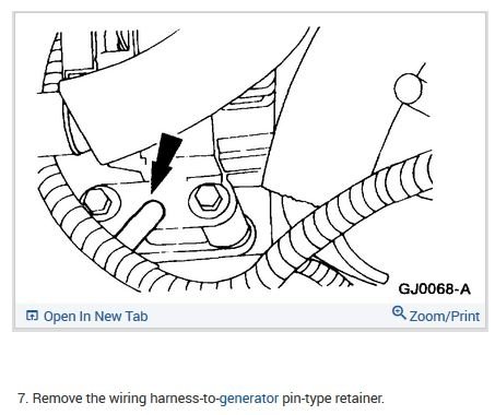

So if that worked, then you'll need to get the alternator tested. There are three ways to do that. The first way is to drive the car to the nearest auto parts store and have them test the alternator. They will do this for free, without any appointment. You'd have to charge the battery for a while in order to do that. Charge it by starting another car and hooking up and jumper cables and just let that car idle for a while (maybe thirty minutes).
If it does start with a charged battery, but you can't or don't want to drive it to the parts shop, then start the car, disconnect any jumper cables, and turn on every single accessory that you can think of. Heat, hazards, wipers, radio, roll the power windows up and down, interior lights, headlights, and so on. The car should die in a hurry if the alternator isn't charging.
The third way (probably the most accurate way) would be to remove the alternator from the car and take it to the parts shop for testing. They'll mount it to a machine and run it to see exactly what it puts out. This rules out the possibility of a major short circuit or a blown fuse if the alternator is the problem. I'm attaching AllData's information on how to remove the alternator in the images below. It's fairly straightforward and should just require some basic mechanic's tools (wrench set, ratchet and socket set, and a screwdriver or two).

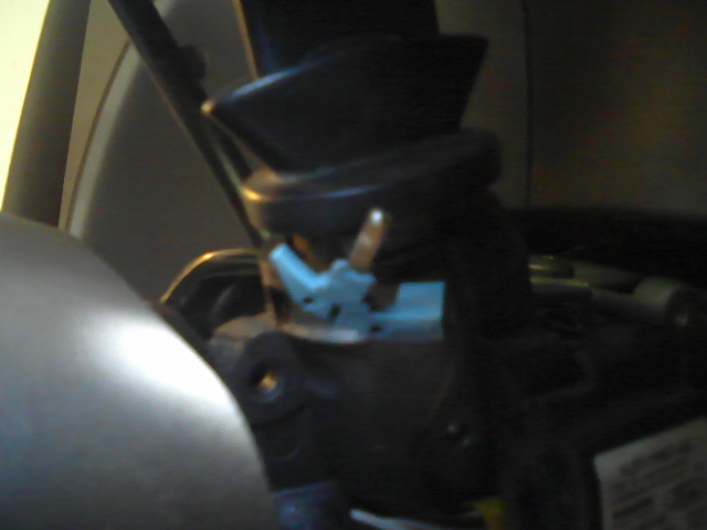

How to put back in the part A11335-D on a ford explorer sport 2002. i pulled it out on accident now my car won't start. the part the i accidentally pulled out is connected to the started where you plug the key into.

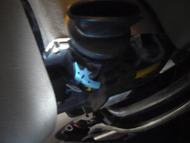

i was trying to fix some lose connections in the column and as i was putting the cover back on an edge grabed and pulled the blck wire that is connected to a light blue part on the started key hole thing. the part number on it is A11335-D. it has something todo with the door because when put back in the general area where it belongs it dings.
Dec 31, 2020 at 12:46 AM (Merged)
it is the warner for the key left in the ignition when you turn the car off and open the door. it looks like it may have broken.
you can leave this out of the loop as it will not effect the running of the car. it looks like the end piece needs to be replaced as well.
can you post more pictures a little larger??

DLUD
Sure but when my camera is too close to it, it becomes very blurry...
