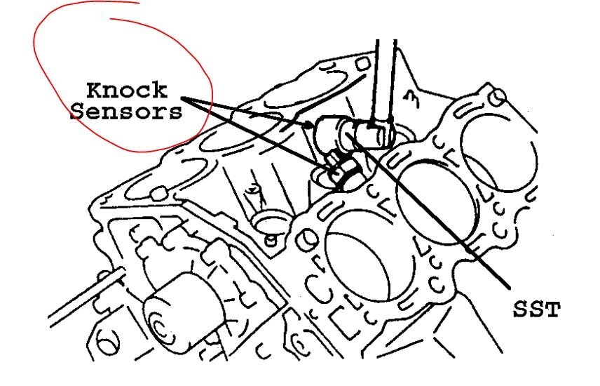

Code p0330, need knock sensor location
1996 TOYOTA 4RUNNER
292,000 MILES • 3.4L • V6 • 4WD • AUTOMATIC
LGILBERT79
It is showing a code p0330. Thank you for all of your help. Lisa
Nov 8, 2019 at 5:44 PM
  • 110,190 POSTS
Hi:
I attached a picture of sensor location. I hate to say this, but you need to remove the intake to access them. Note that the P0330 is specific to the left bank, but I would replace both.
