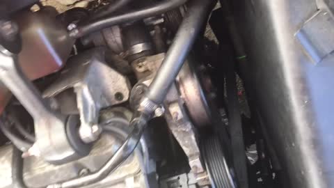

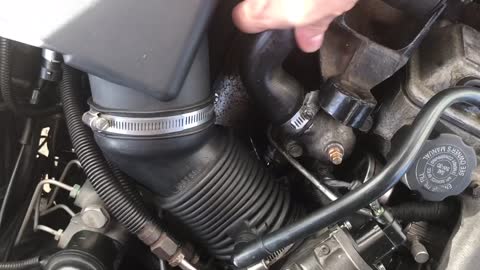

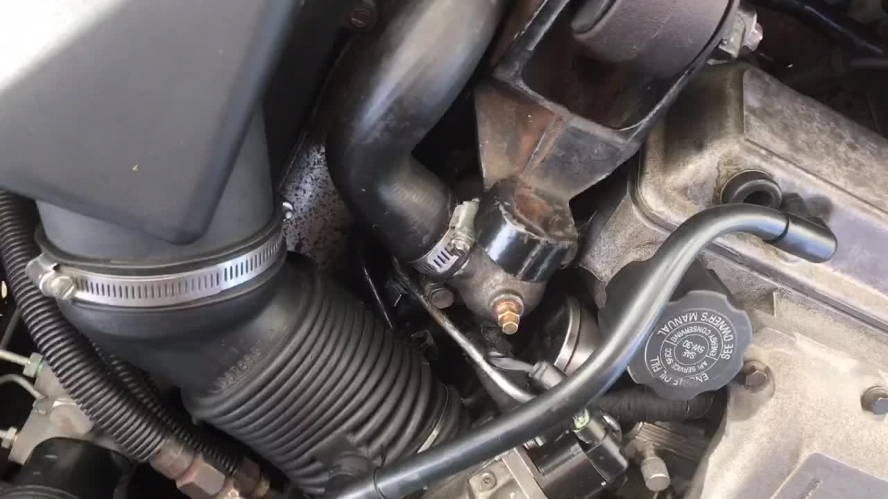

I just replaced a thermostat and coolant temperature sensor. I did a complete coolant flush of the entire system. I also just replaced the intake manifold gasket. So I know I had to drain all the coolant out of the system.
Intake manifold is leak free. But as soon as I started the car after adding coolant, I noticed along side the thermostat housing started overheating. I use rtv on the thermostat housing after putting the new thermostat in to seal for leaks. I am thinking maybe it’s overheating because I used concentrated coolant. I did mix water and used more coolant. I did some research and read that concentrated coolant is known to make an engine overheat if it’s not mixed properly. Many people recommended using straight coolant without adding water. Many had better results and increased the life of the coolant system parts in their cars lasting longer.
I am thinking it’s overheating because I used concentrated. I attempted to flush the coolant again today thinking maybe there was still air in the system somewhere. But when the engine started warming up it began to overheat in the same area again. I am lost. I know my heater core is okay because I have heat. It’s got to be something simple I did wrong for it to overheat like this. I hope it’s just the concentrated coolant. Let me know what I should do. I don’t want to drive it like this. Plus I am a beginner mechanic. If I can fix it myself without paying money I would appreciate how to correct this.

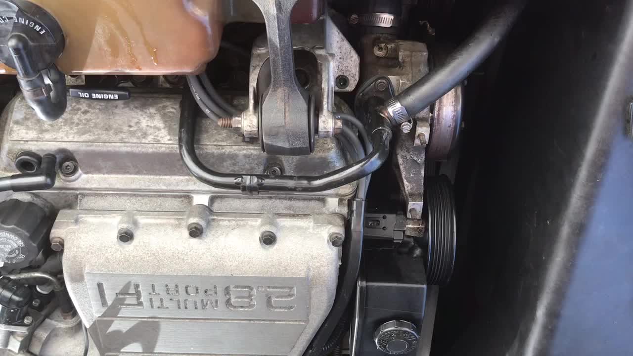

Here are some videos of where it’s exactly overheating at and water pump inspection:

The engine wasn’t overheating before. I only replaces the thermostat and the coolant temperature sensor because I had to remove the intake manifold to replace the gasket. Every time I do a job with coolant I replace thermostat and coolant temperature sensor to maintain the cooling system. There isn’t any head gasket leak, there isn’t any milky wet shown in the oil and no white smoke is entering the tail pipe. It is just overheating near the thermostat housing. Like I said in the videos you couldn't see, is the water pump pulley has some play in it and makes noises when I freely spin it without the belt on. Also a symptom of a bad water pump seal would be coolant leaking out of the hole. This is doing so on mine. But if I were going to replace the gasket I rather replace the whole pump because it wasn’t a new one. It was a re-manufactured part.
I mention the water pump because the engine is overheating. I want to make sure if the water pump relates to the over heating issue I am having. Like I said, the only thing that is over heating is the thermostat housing. I do have a bleeder screw, but the screw isn’t bleeding when I open it. I don’t know if there is air trapped in the system somewhere or the pump went out. I don’t want to spend money buying more parts before I know what is it. That’s why I asked for help how to fix it.

Pop a sensor out to bleed any air out. A lot of cars don't even have bleeder screws, so we can work around that.
It doesn't make sense to say only the thermostat housing is overheating. It can only do that if the entire engine is overheating. Did you feel the radiator to see if coolant is circulating?

The only place air will become trapped is right under the thermostat, and as I mentioned, that will prevent it from opening. If you remove a sensor near the thermostat hosing, then add coolant until it's about to run out, that should be sufficient. Sloshing hot coolant will hit the thermostat and cause it to open, then any remaining air will flow to the radiator, then into the reservoir as the coolant expands. That air isn't going to keep circulating through the system because it always floats back up to the top.
Understand no heat is generated near the thermostat or housing. The only heat is generated in the cylinders and passes through the cylinder walls into the coolant. If anything is too hot, the heat is getting there through the circulating coolant. Besides feeling the radiator, you can feel the upper radiator hose too, but do that near the radiator. Even when coolant is not circulating, that hose will feel hot near the engine end. That hose should be too hot to hold onto for very long.
An '89 model is going to have two coolant temperature sensors. The sensor with one wire is for the dash gauge or warning light. The sensor with two wires is for the Engine Computer. If you unplug that one with the engine running, the radiator fan should turn on. That's a fail safe design because the computer can't know if the engine is overheating, so it turns the fan on just in case. On most cars that will turn on the Check Engine light and set a fault code. Don't worry about that. On most models, once the sensor is reconnected, the light will go off the next time the ignition switch is turned on, and usually the fault code will self-erase after a certain number of engine starts. That's a quick test on most models to determine if the fan circuit is working.
Take a look at this article:
https://www.2carpros.com/articles/engine-overheating-or-running-hot
to see if it gives you more ideas. Is it possible you installed the thermostat backward? The spring and pellet goes toward the source where the heat is generated, usually meaning the other end is pointing toward the upper radiator hose. Usually you can't fit the thermostat into the housing the wrong way, but every now and then the engineers pull something to mess with us.

To be on the safe side and probably will save me more time than having to remove the sensor because it’s hard to take off with throttle body and air box there. I was told, you can jack the front side of the vehicle where the radiator cap is at, with the cap off and the air will escape out of the system faster forcing it out the coolant system because the front of the car or side will be in the air rushing air trap in coolant system out. The air in the system will start to gargle and when it reaches operate temp the air will be out of the system and I will just have to add more coolant to the correct level.
I already drained coolant system again and I squeezed the hose of the thermostat housing. It still felt like there was a lot of air trapped because coolant bubbles was just coming out of the bleed valve and the way it works is the coolant should be shooting out telling you the system is full and hose isn’t spongy anymore. I kept adding coolant, the radiator kept overflowing so it was full, but the bleed valve on the thermostat just kept having bubbles come out and was barely shooting coolant out like it’s supposed to when you know the system is full.
I already replaced the intake manifold gaskets, coolant temp sensor, thermostat, water pump, and radiator cap. I know when replacing parts in the coolant system it opens the coolant system and traps a lot of air in there. So I found out this is why it’s overheating in the first place.
I want to make sure I can still run the engine to operate temp preventing damaging head gaskets ect. I take good care of the coolant system and always drain and clean the system putting fresh coolant because this isn’t my daily driver and it sits a lot.

The first paragraph is totally incorrect. The air is not trapped in the radiator; it's trapped under the thermostat. A lot of GM cars don't even have radiator caps any more. Any air that finds its way there goes to the high point, then gets pushed into the reservoir. When the engine cools down, the coolant contracts and draws liquid back in from the reservoir.
From what you described, it sounds like a cylinder head gasket is leaking. You might be able to see a steady stream of very small air bubbles if you remove the radiator cap, but the better test is described in this article starting with step 4:
