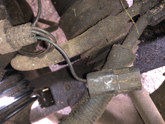

I was swapping out the power steering pump on my car and I saw down by the left side tie rod (if looking from front of the car) a plug that is unhooked. It looks to be two-prong and attached to a wire harness.
I can't find any good diagrams of the wiring that show what this could be, I was wondering if anyone here had an ideas? I can post a picture if needed but it's dark outside right now.

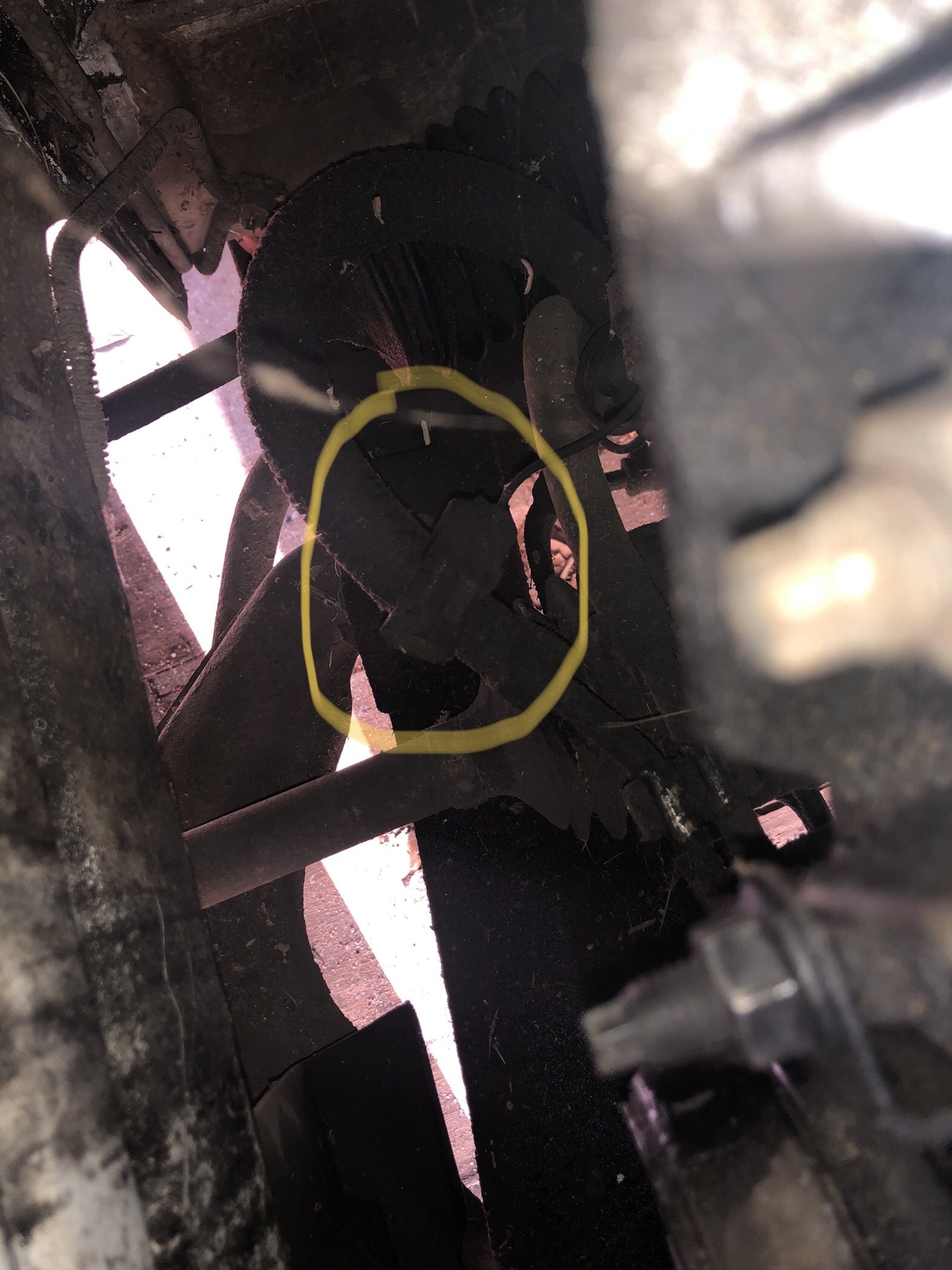

Sorry for the quality this is the best I can get it’s kind of cramped. I used the flash on my phone to try to make it better and circled the plug in question. Also, upon further inspection, it is a two prong plug but only one wire (the other prong is not used).
As I said, it on the passenger front side by the tie rod.

What is the wire wrapped around? Is that a battery cable or AC line? Can we get a better picture please?
Jan 16, 2021 at 6:56 AM
ETERNALARIANNE
  • 240 POSTS

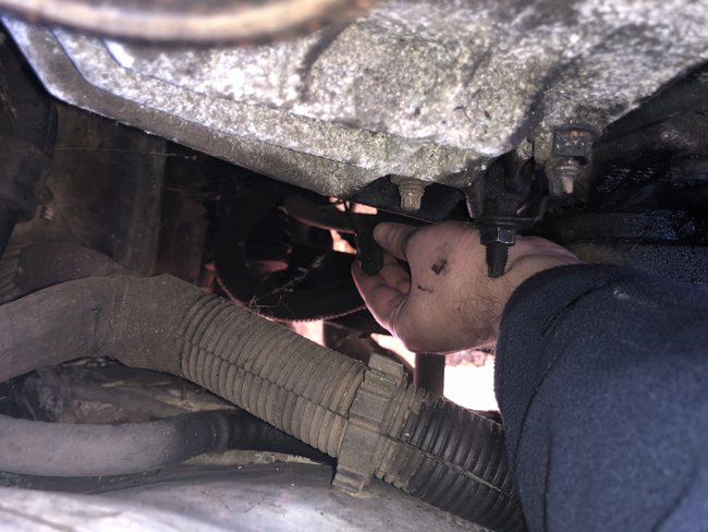

It isn’t wrapped around anything, the harness it just really short. This is about a good a pic I can get. I was wrong it is near the passenger CV axle, the tie rod is further back. It does look like the same harness is plugged into something around where the CV axle connects to the transmission, as well as a single wire going to the back of the motor near the exhaust. Hope that helps.

Hello, was there any type of cap on the plug of that wire? And it looks dark green, can you clean it off alittle so we can see the color abit better.
It looks like there are 2 different options for automatic transmission. It might be an optional thermo element that can be added for the Hydra-matic 4T60 and THM F-7 transaxle. If you're not having any problems with the transmission, you might just want to cover the connector end. It might have had a cover on it at one point.

That's the only conclusion I can come up with, I went through the wiring diagrams pretty thoroughly and I don't see any extra places it would go. If there's no open missing plug ports on the transmission, it must be for a different optional transmission. Plus it can only stretch so far, if nothing is within reach of it, I'd cover it with something and try not to worry too much. There definitely is 2 or 3 different transmissions that can be in that model/year. It's only 1 wire so it's not like the 2 pins inside are going to short out or anything. Unless you see a wire hanging down that could go to it, but that doesn't seem to be the case. Hope this helps. Of course let us know if you have any problems, but it was wise of you to ask about it. Cheers.

It’s the TCC solenoid for the overdrive lock up. I noticed mine was unplugged I plugged it in and couldn’t go over 40 without violent shaking but car drives excellent with it unplugged.
