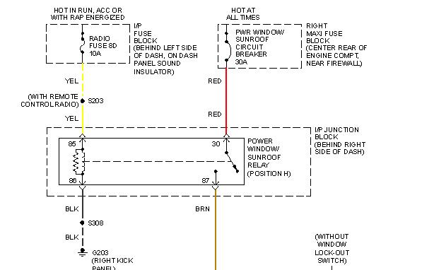

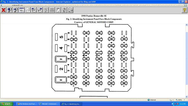

I have a 1998 Pontiac Bonneville you can hear the radio come on but the face plate does come on and aslo none of my power windows work I check all of the fuses under the dash but I do not know which fuse is for the power windows.

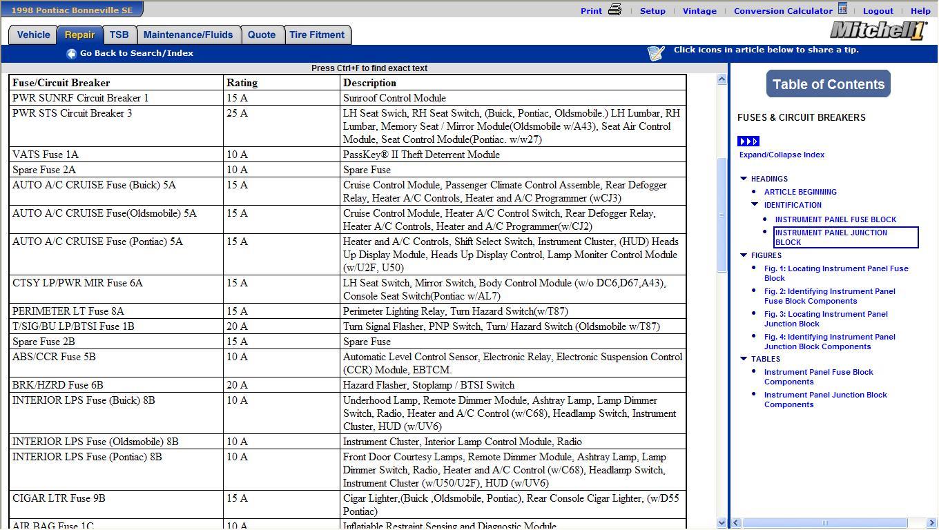

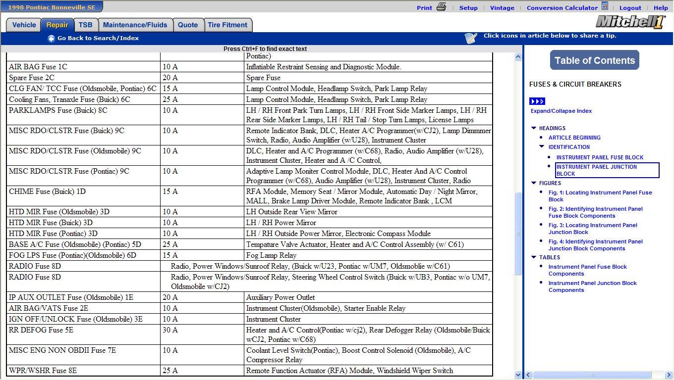

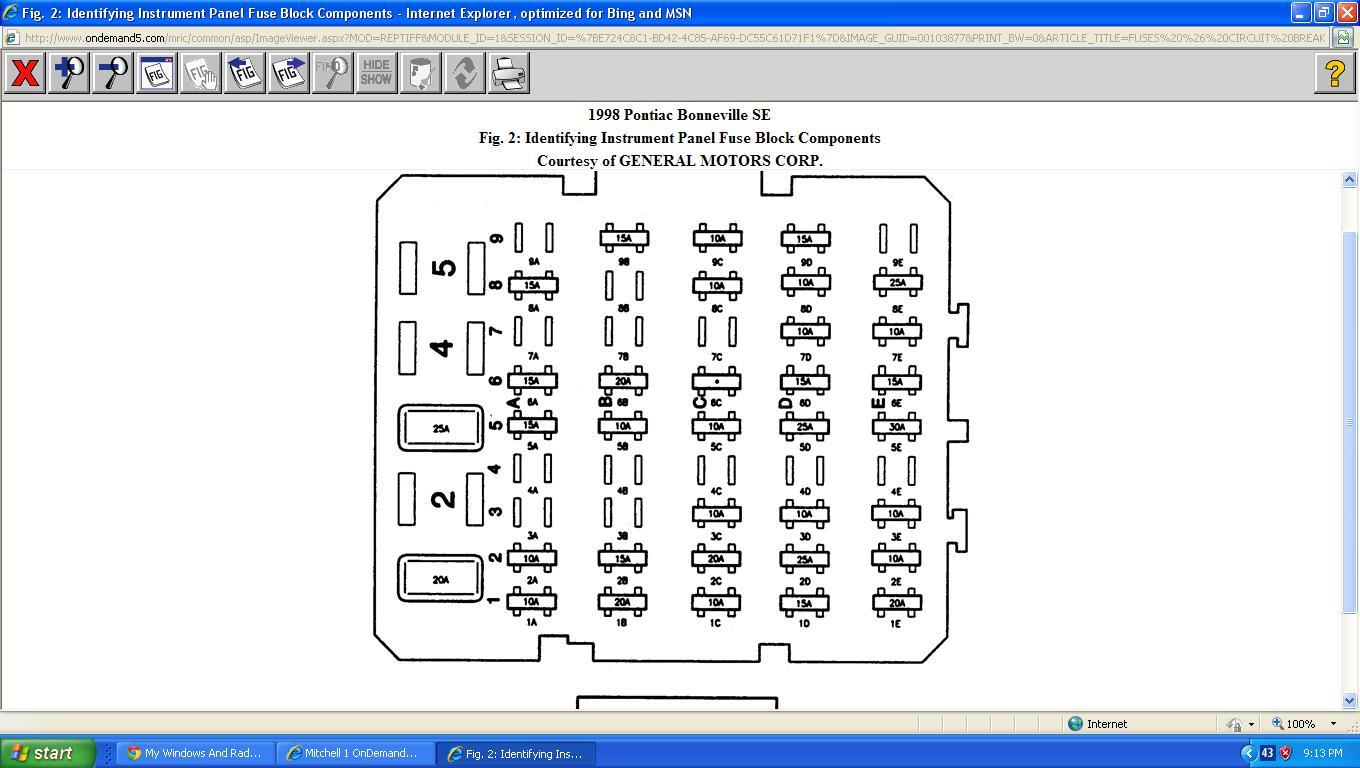

OK....SO LIKE I WENT INTO "MITCHELL I" AND GRABBED YOU .....RATHER MADE YOU 3 SCREENSHOTS
LEMME KNOW IF THEY HELP

check all three in pic........
