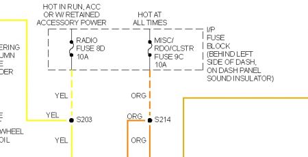

My clock and radio/cassette player system stopped working. I replaced the antennae a few months ago.
Maybe a fuse went out? Which one would it be?
I am thinking that I could replace the whole radio system. How do I remove the front plastic cover to access the radio?

Not
https://images.2carpros.com/forum/automotive_pictures/170934_bonneville_radio_bose_system_1.jpg
only check the fuse, use a voltage tester where the fuse plugs in, check for voltage. One fuse is hot all the time, the other goes hot with the key on. Bose system.
