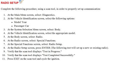

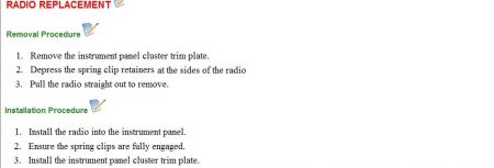

I need to know how to remove the radio from my car. the led lights have gone out and I have to replace the whole radio. Is there any codes I need to know about?

https://images.2carpros.com/forum/automotive_pictures/261618_Noname_2845.jpg
https://images.2carpros.com/forum/automotive_pictures/261618_Noname2_932.jpg
https://images.2carpros.com/forum/automotive_pictures/261618_Noname3_337.jpg
