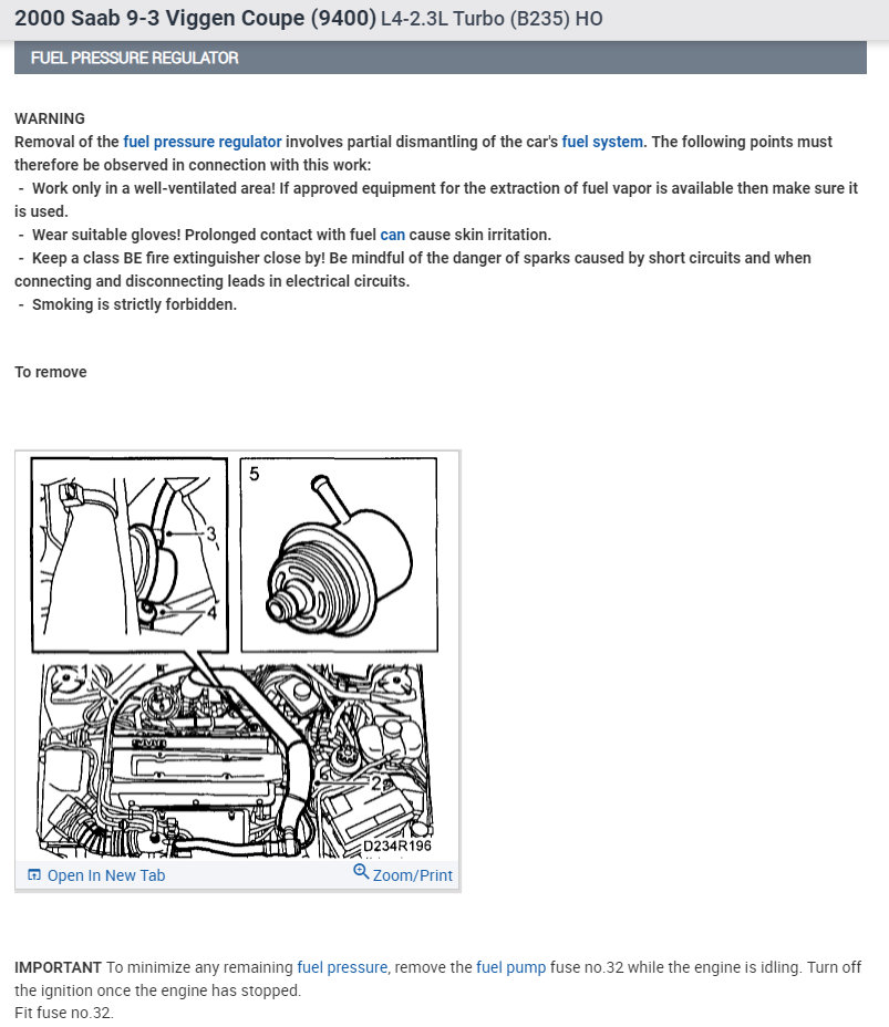

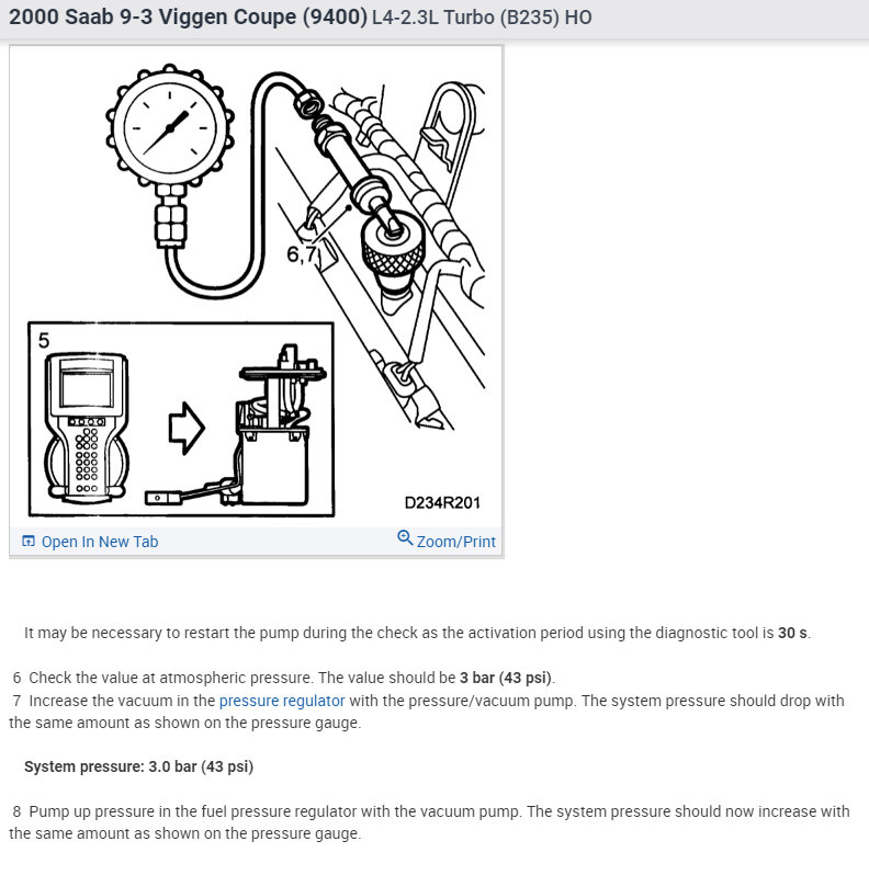

My Viggen just stopped running and I can't get it started. It will run on starter fluid, but not on the normal fuel delivery system. I replaced the fuel pump and filter. When I turn the key, I think I can hear the pump running. The pump fuse is okay, and I changed the fuel relay under the dash. The part was in another Viggen that was running. The battery is fully charged. Could it be an airlock in my high-pressure fuel line? I do not have the plastic tool to release the fuel line up by the fuel rail.
I appreciate your help as I am stranded without a car! Peter
My Viggen runs on ether but not on the fuel delivery system.

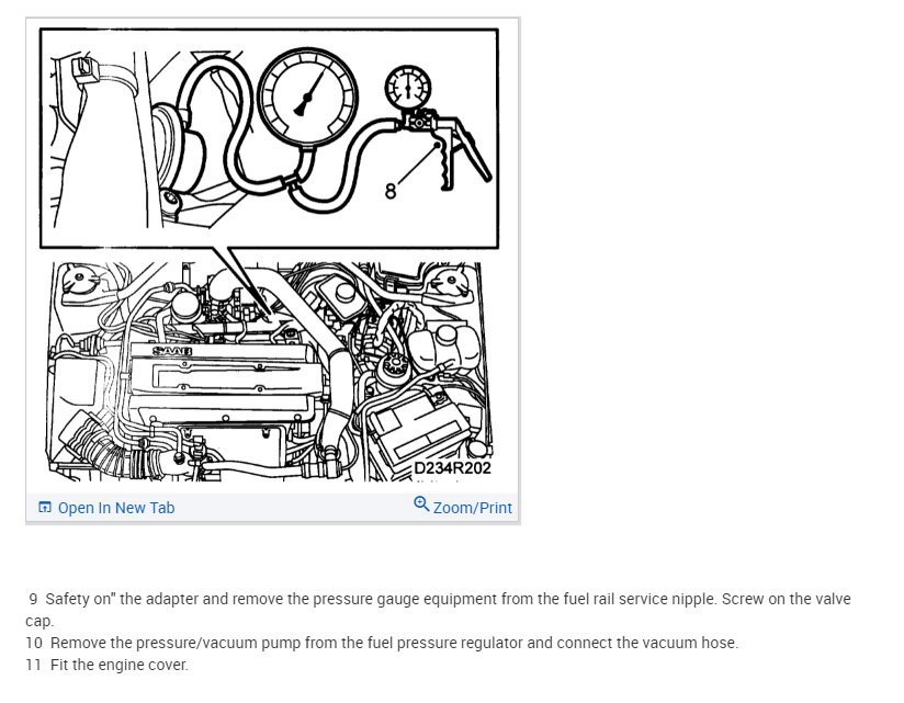

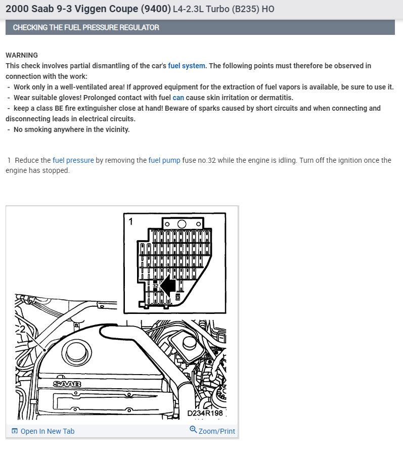

It sounds like the issue is fuel delivery to the injectors.

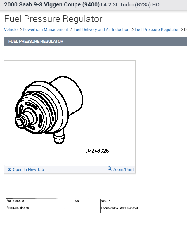

It could be caused due to a restriction in the fuel line, could be a clogged fuel filter or a bad fuel pressure regulator.

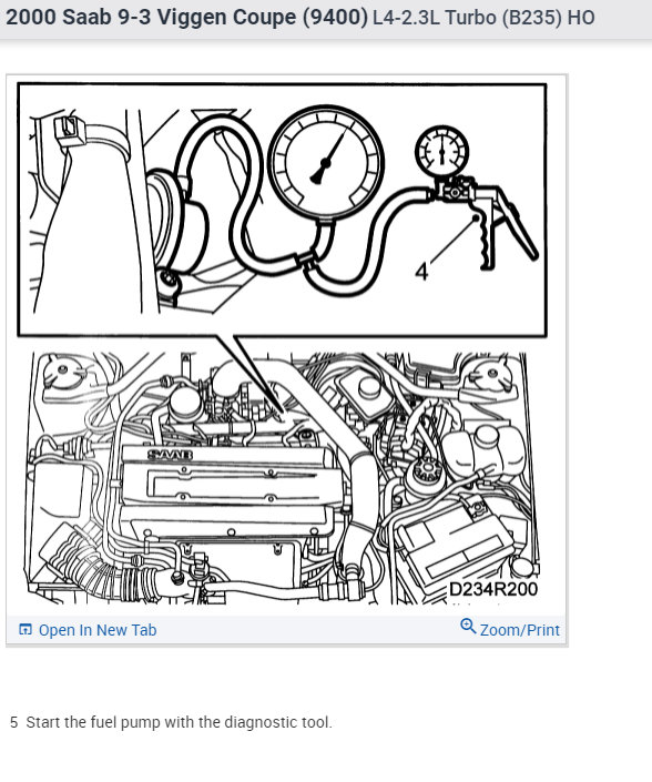

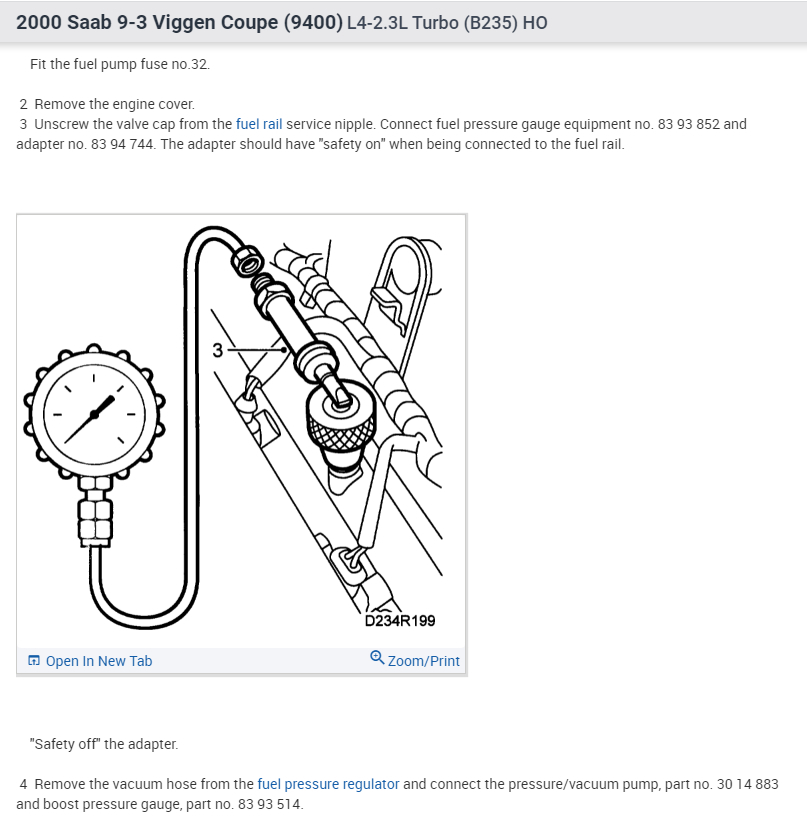

A good first step would be to check the fuel pressure. The fuel pressure can be tested using a pressure gauge. Typically, those tools are available at your local auto parts store to rent.
This vehicle should have 43 PSI of fuel pressure.
Here is a helpful guide:
I have attached the fuel pressure test procedure below.

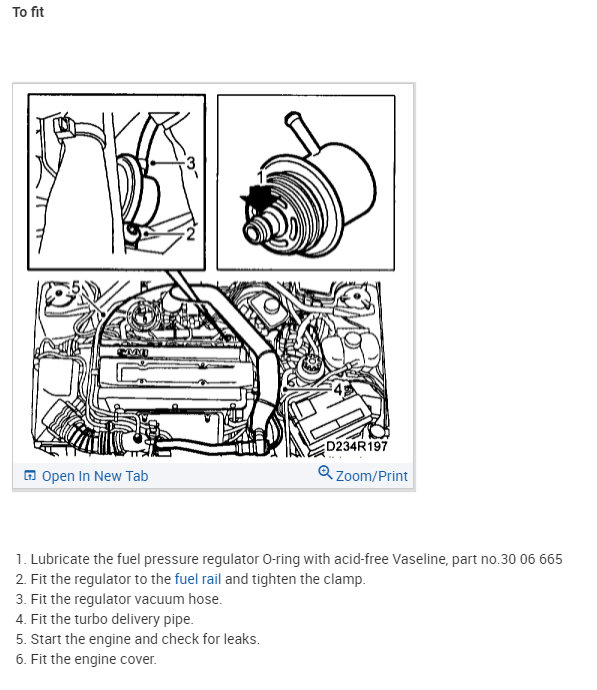

I will replace the fuel pressure regulator. Before the car stopped running, I got a service security warning. I also noticed that my remote unlock key battery drained out. Could it be that I need to replace the battery? The manual says to turn the car to on and then press a button to unlock a door. Could this be the problem?
