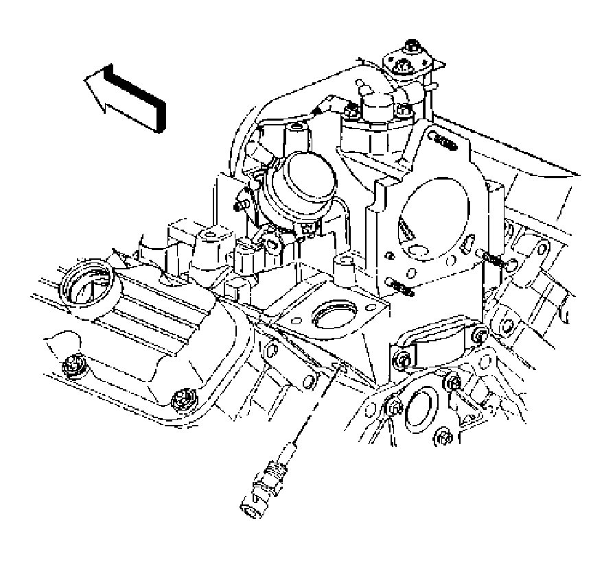

The wiring harness connecting to sensor was corroded so got that fixed. then when plugged back up the gauge inside car dashboard area was not reading the temperature of the car rather hot, or if it’s not. Just reads the car temperature is cold all the time. so I figured since it's no bad fuses this would be the problem. Plus the thermostat was also replace already. Need help figuring this out.

It is likely the sensor, but here is how you check. You will need a general multimeter to perform this.
1) First, you need to check for power at the connector which is attached to the sensor. If you look at pic 1, it shows the connector. Pin A is the ground and pin B is the power supply. First, check to see if there is power to pin B. It should be around 5 volts.
2) If there is power, you need to check for continuity to ground. Set the multimeter to ohms and probe pin A with one of the red prong on the meter and ground the other to check for continuity.
3) If that checks good, next check the sensor for resistance. Again, with the multimeter on the ohms setting, touch each pin on the sensor You should be around 1.5 to 2.0 ohms of resistance at ambient temp. If it shows 0, replace the sensor.

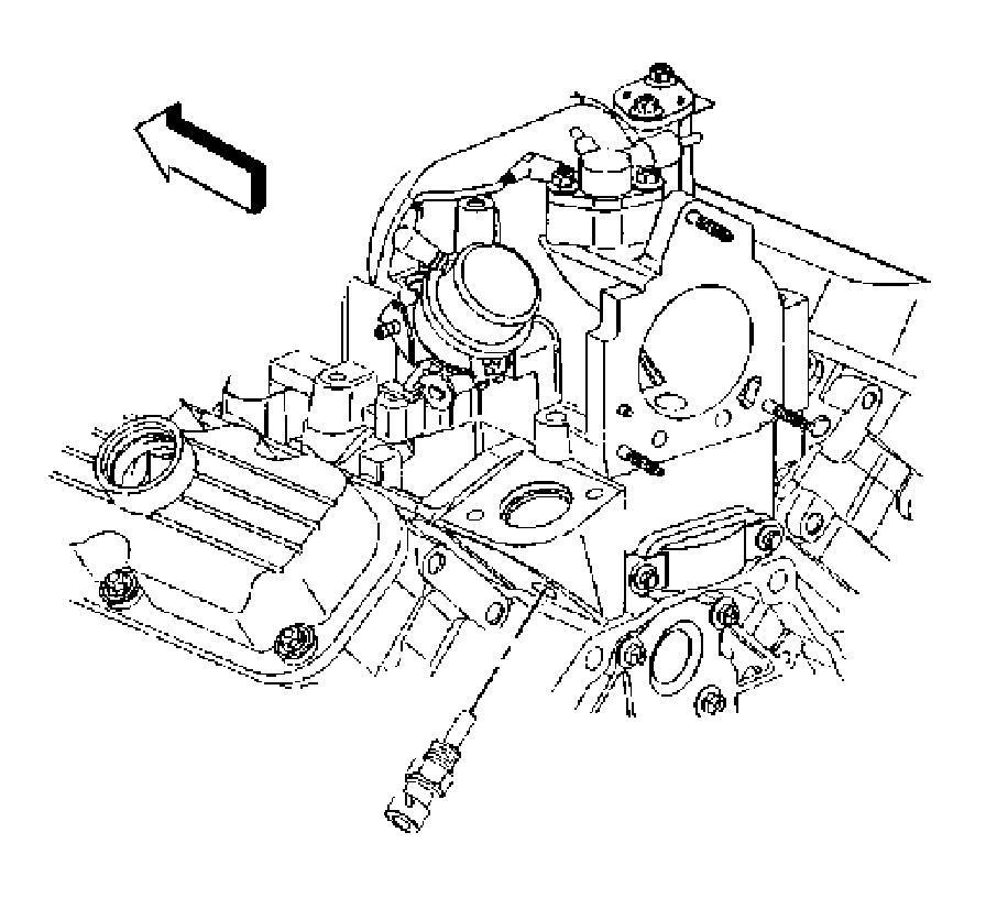

Here are the directions for replacing the sensor. Pics 2 and 3 correlate with the directions.
2005 Chevrolet Impala V6-3.8L SC VIN 1
Procedures
Vehicle Powertrain Management Sensors and Switches - Powertrain Management Sensors and Switches - Computers and Control Systems Coolant Temperature Sensor/Switch (For Computer) Service and Repair Procedures
PROCEDURES
ENGINE COOLANT TEMPERATURE (ECT) SENSOR REPLACEMENT
REMOVAL PROCEDURE
NOTE: Use care when handling the coolant sensor. Damage to the coolant sensor will affect the operation of the fuel control system.
1. Partially drain the cooling system. Refer to Draining and Filling Cooling System in Cooling System.
2. Remove the thermostat housing.
3. Disconnect the ECT sensor electrical connector.
pic 2
4. Remove the ECT sensor.
