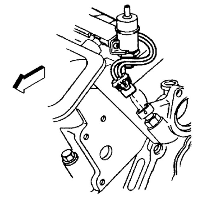

My temp gauge not working and the fan is running what can cause this?
Please help

It sounds like you have an engine coolant temperature sensor that is shorted. Here is a guide and some diagrams (below) to help you get the problem fixed. This guide gives you an idea.
https://www.2carpros.com/articles/coolant-temperature-sensor-cts-replacement
Here is what it is like on your car.
Cheers

That work perfect nice work guys! I love this site
