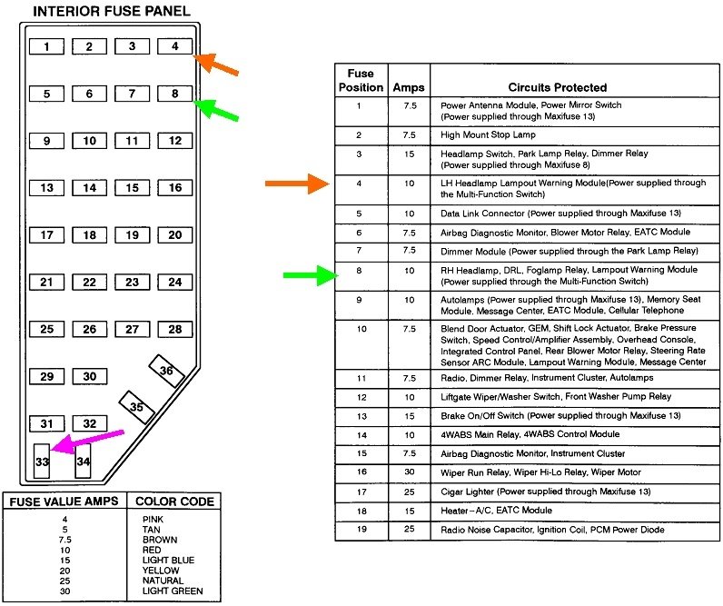

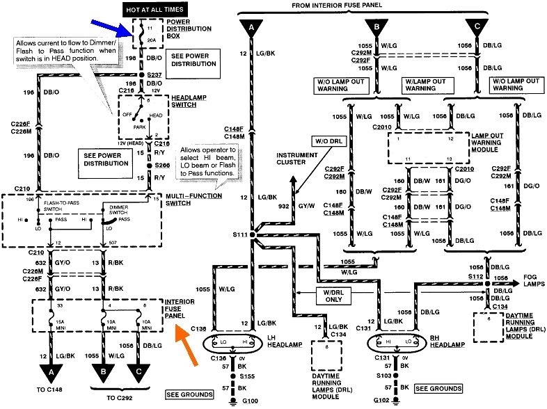

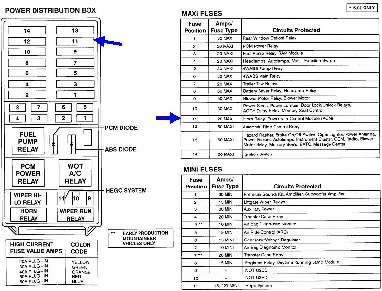

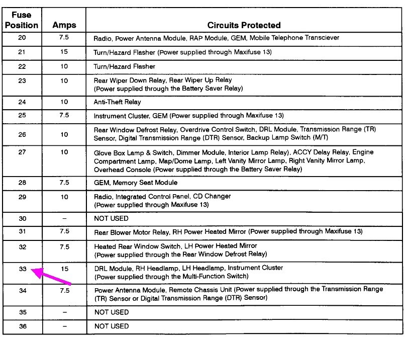

Here's the entire head lamp diagram without automatic lights. The 20-amp fuse is shown as number 11, but on the chart, head lamps isn't listed for that fuse, so there is already some confusion.
