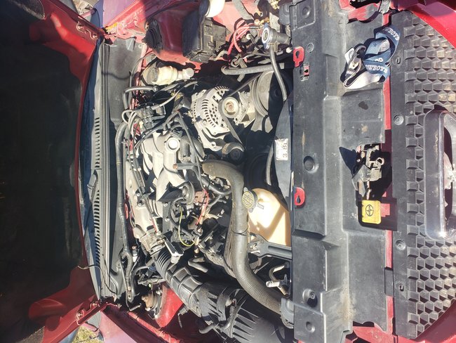

I'm really not sure what they all did, they just told me the radiator was cracked and there are metal shavings in the oil. So, I know that's not a good sign, but it still could be fixable probably, but it might just be cheaper to get another engine. I don't know. We will have to see.

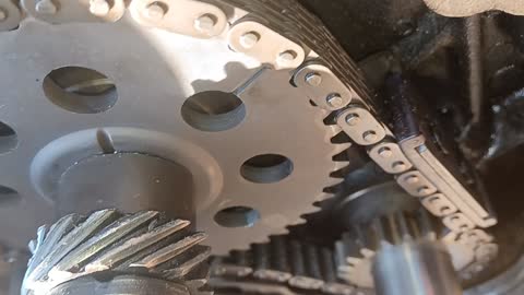

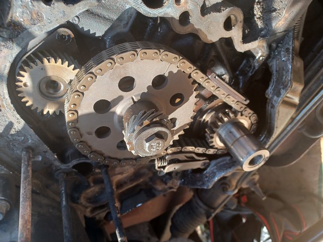

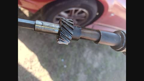

Hey man, I'm sorry I took everything apart already before I got back to reading your reply. So, I finally got the timing cover off and it was a pain to do so, lol. But the timing chain looks fine but there is a gear that needs to be changed. I believe it is the camshaft drive gear that's attached to the timing chain but I'm not sure that's what AutoZone said it was. But it is in really bad shape also the Camshaft Synchronizer that goes into the oil pump to turn it the gear on that is in bad shape too. So, I'm pretty sure that's what is wrong the gears are just old and need to be replaced, but I thought maybe the oil pump sized up and maybe that's why it caused the gears to grind together. So, I put the camshaft synchronizer back into the oil pump and it turned the oil pump. So, my oil pump is good. I don't know what caused this to happen, like I said, I'm not a mechanic. So, I'm sorry if you get confused if you need any more info just let me know. I will be adding a video and pictures so you can see what I'm talking about. Thanks man

Wow, there are a lot of metal shavings. Does it appear it came from the gears you mentioned?
If the timing is correct, we may need to dig further into this. I'm not happy with what I see. I don't know what you have done yet, but you may need to take the oil pan off to see what is in it. It looks like bearing material. I wish I had heard it crank so I could have determined if it sounded like compression-related issues.
Sunday, March 27th, 2022 AT 1:31 PM

Hey man, I believe the metal shaving is from the gears. I will be pulling the oil pan tomorrow to see what's in it. I bought the camshaft synchronizer Monday, but I'm having trouble finding the other gear that's on the timing chain. I really don't know what the name of it is. AutoZone said it was camshaft drive gear, but I looked that up and couldn't find it. Then my buddy said it is the distributor gear and I looked that up and I found one that looked like it, but it said it was sold out. So, I really don't know the name of it and I was just going to buy a timing chain kit, but it doesn't come with that gear. I don't think anyways but AutoZone said I probably would have to go to the Ford house to get that gear. So, I am going to try that tomorrow. I'm not happy either man because it doesn't make any sense why this happened, to be honest and I'm sorry I wished I would have seen you're reply before I started taking everything apart; hopefully this is all that's wrong with it cause like I said the timing chain looks good.

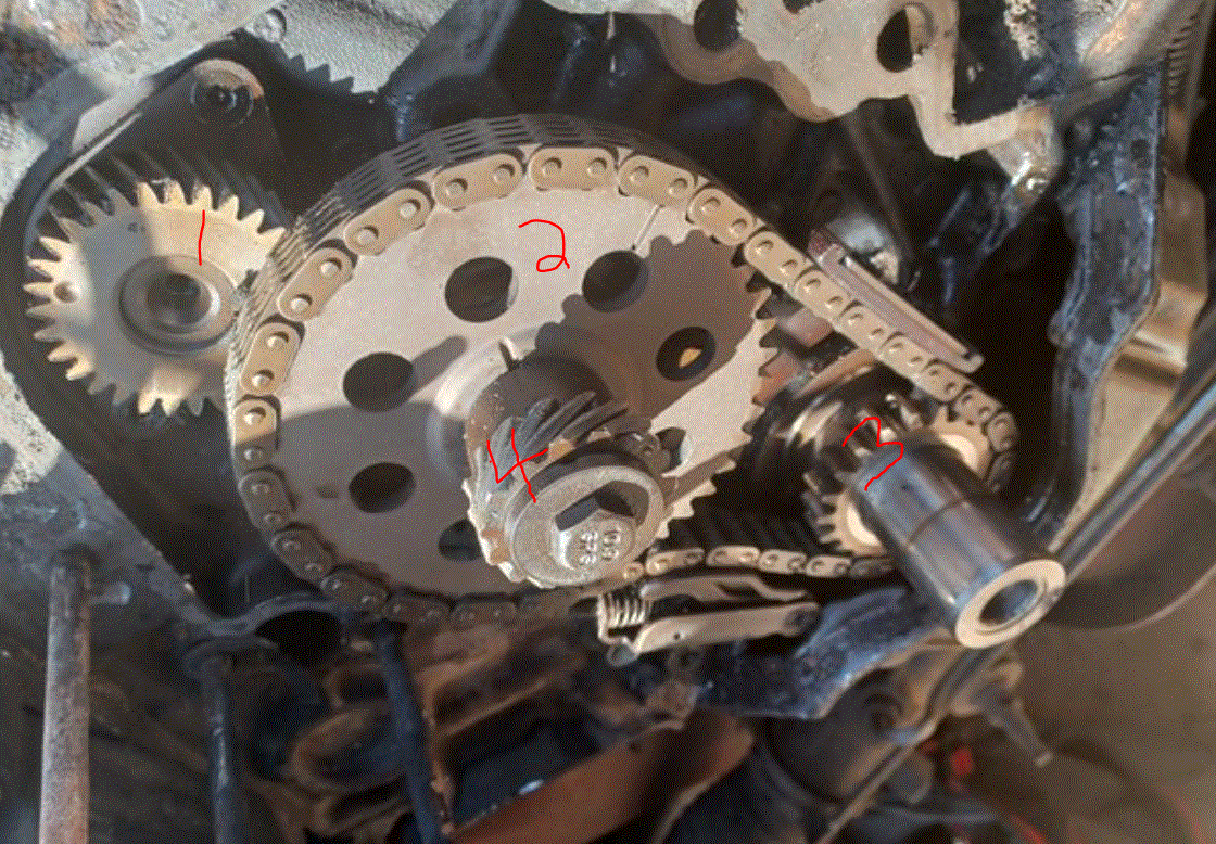

The car doesn't have a distributor, so no to that. I made a copy of your picture above and numbered each gear. Here is what each one is:
1) Balance shaft gear
2) Camshaft timing gear
3) Crankshaft timing gear
4) Camshaft position sensor drive gear
Let me know which one you are looking for, and I'll see what I can find. It may be nothing, but I'll give it a shot.

Thanks for doing that, I really do appreciate it. If you can help me, find one, it's the Camshaft position sensor drive gear.

We have two choices for that part. You will need to see if a Ford dealership can get it, or you will need to find one at a salvage yard. There are no aftermarket manufacturers that produce it.
I wish I had a better answer, but I've exhausted my resources and found nothing.
Let me know if you are able to find one. See if there are any of these engines in salvage yards.

Quick question, do I have to remove the timing chain to get the camshaft position sensor drive gear off? Because I took the bolt out and it didn't come off.
Friday, April 1st, 2022 AT 7:30 AM
  • 109,901 POSTS
No, the chain shouldn't need to be removed. If you have a plastic hammer, tap on it. There could be corrosion holding it in place. Also, if it's bad, you have nothing to worry about. IF that still doesn't work, you may need to get a puller.
