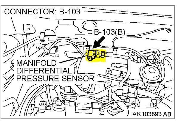

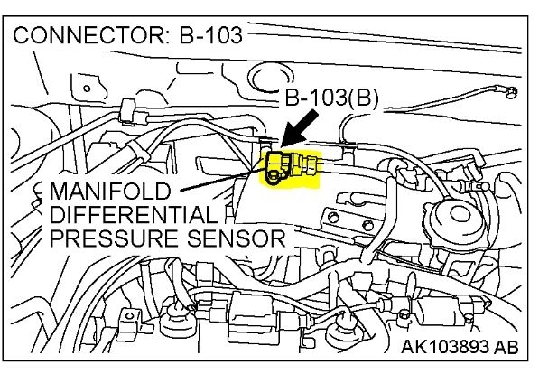

The P1400 is my biggest concern. Have you checked the wiring to and condition of the manifold differential pressure sensor? It can cause all of the codes you identified.
I attached a pic below to help locate it.

Yes, my husband says we replaced it. He says the resistance and voltage check are good also.

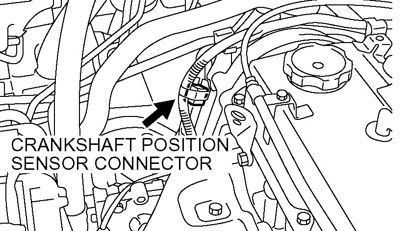

4. Disconnect the crankshaft position sensor connector.
NOTE: Doing this will prevent the engine control module from carrying out ignition and fuel injection.

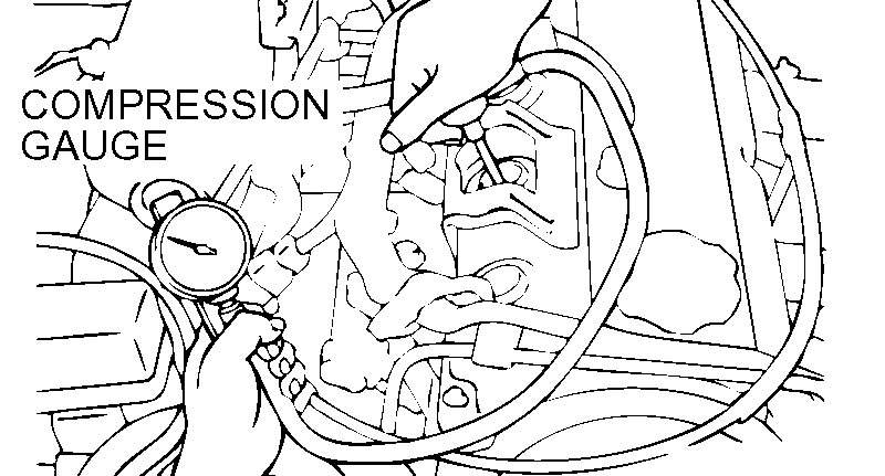

WARNING: Keep your distance from the spark plug hole when cranking. Oil, fuel, etc., may spray out from the spark plug hole and may cause serious injury.
5. Cover the spark plug hole with a shop towel etc., during cranking. After the engine has been cranked, check for foreign material adhering to the shop towel.
pic 2
6. Set a compression gauge to one of the spark plug holes.
7. Crank the engine with the throttle valve fully open and measure the compression pressure.
