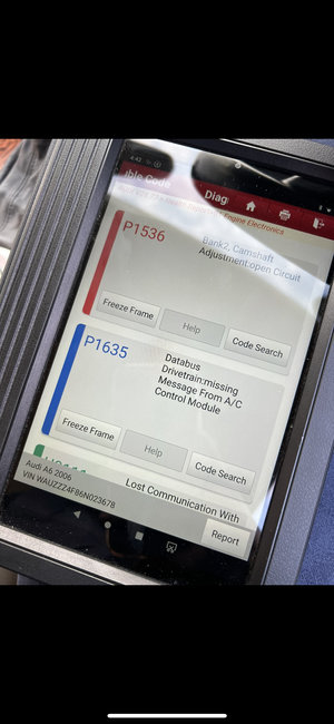

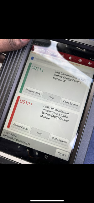

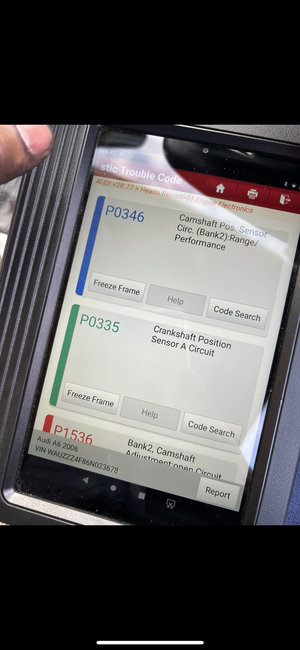

I ran a diagnostic tool and here are some things I got back from it.
please be aware my battery is not good, and I have a spare car to charge it while i run these diagnostics, so some codes are due to battery.

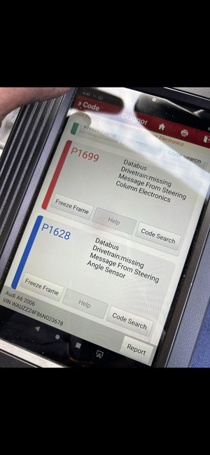

The scanner I used is worth £1000s I’m sure it will have that. What is a can bus is there an option for that?

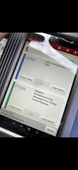

Below are some codes it gave.
Mar 11, 2022 at 6:47 PM
  • 110,244 POSTS
The pics above indicate CAN-related codes. Specifically, the U codes and ones indicating "Databus".
Basically, the acronym CAN stands for controller area network. In other words, it is a few wires that connect the different computers/modules together via a few wires.

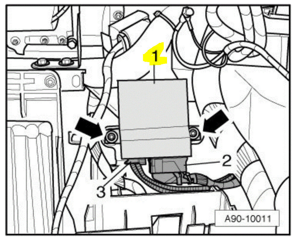

You have codes indicating several modules are unable to communicate. My first reaction to this is the CAN interface has failed and is causing an inability for the modules to communicate. If it was one specific module, for example, the U0111 battery energy module A, that module would be my first suspect. However, this vehicle has communication loss with several different modules. I don't feel all would have failed at the same time.

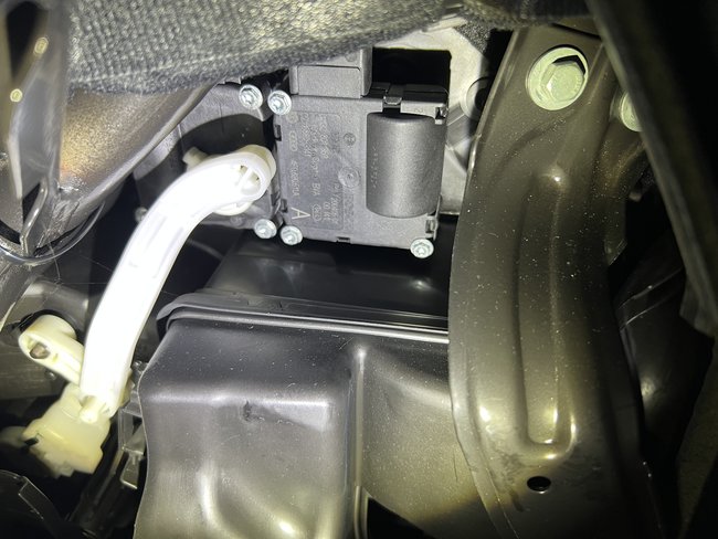

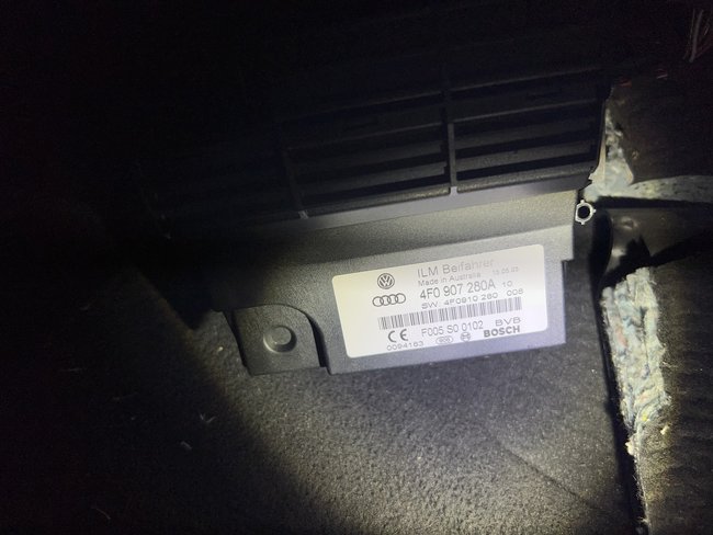

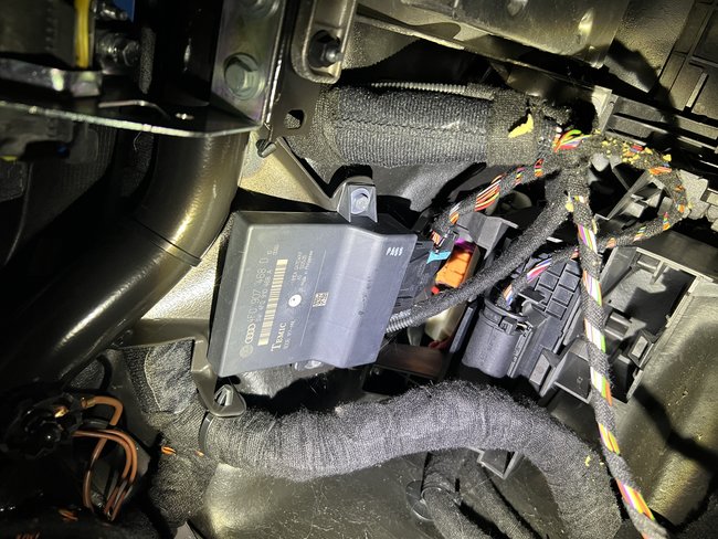

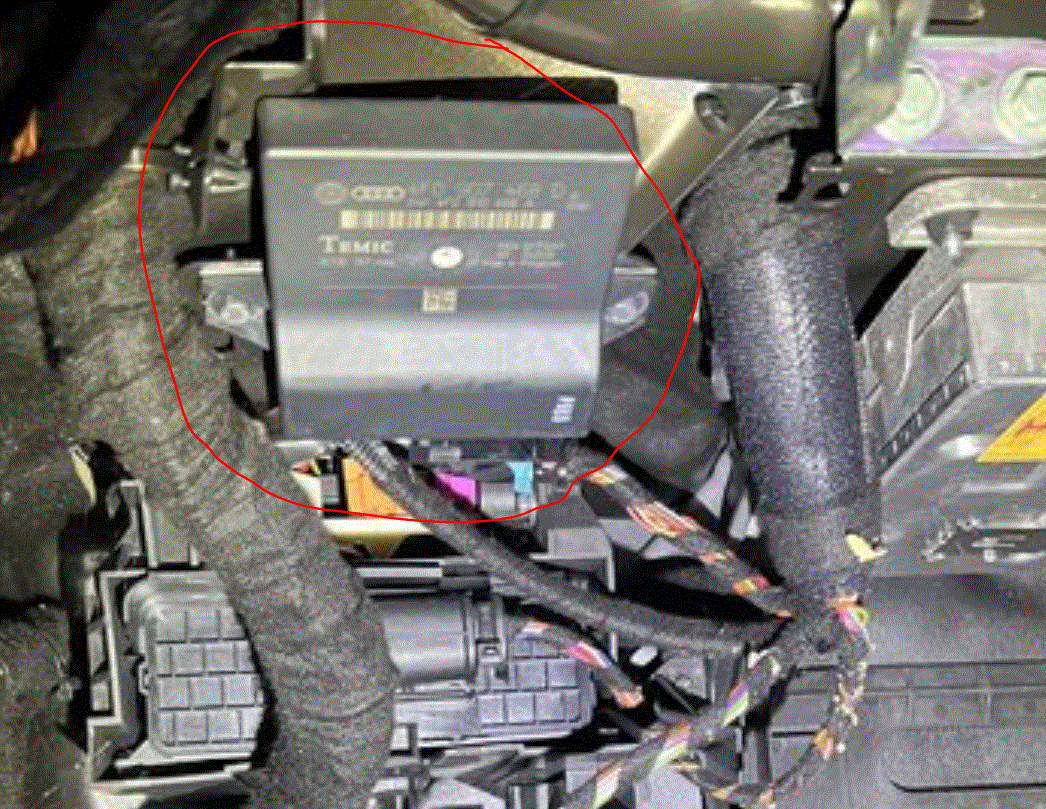

The controller is located under the dash on the passenger side and not easily reached. I attached the only pic I could find below.
You may want to locate it and inspect wiring and connectors for any damage or corrosion. However, make sure the battery is disconnected prior to unplugging it.
Please understand, I could be wrong when saying this is the issue. However, I am basing it on a few past experiences that were similar to what you are dealing with. The start and stall issue is the one thing that stood out to me.
Let me know if this helps.
See pic.

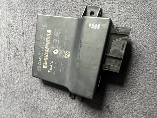

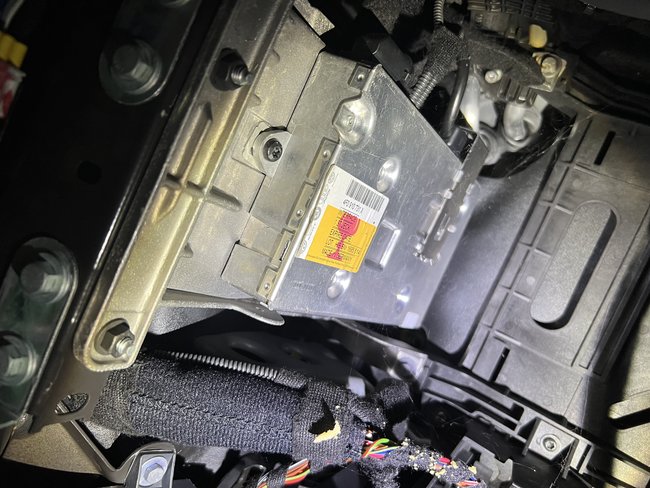

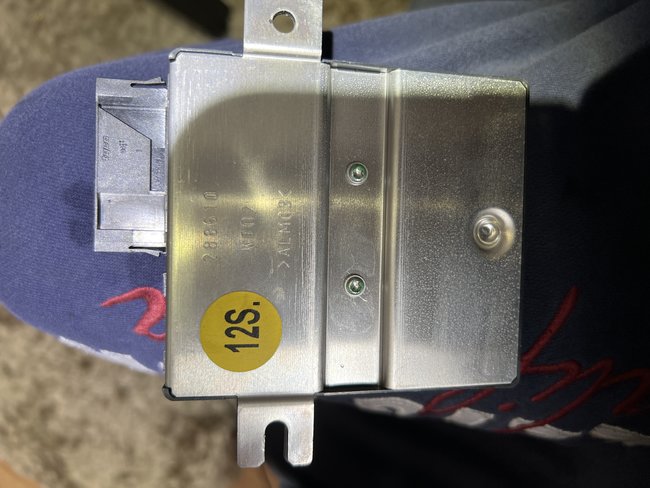

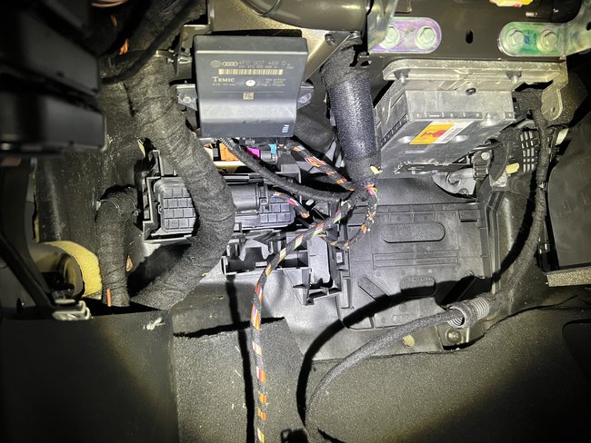

Which one is the part I’m looking for? this is all at the passenger's side. I’ve removed the glovebox and made it easier to access.
Mar 12, 2022 at 9:02 AM
  • 110,244 POSTS
See pic below. If you get me the part number from it, I can confirm for you. However, that appears to be it.
Mar 12, 2022 at 9:09 AM
BOSSD1
  • 15 POSTS
Part Number: 4f0907468D.
Mar 12, 2022 at 9:11 AM
  • 110,244 POSTS

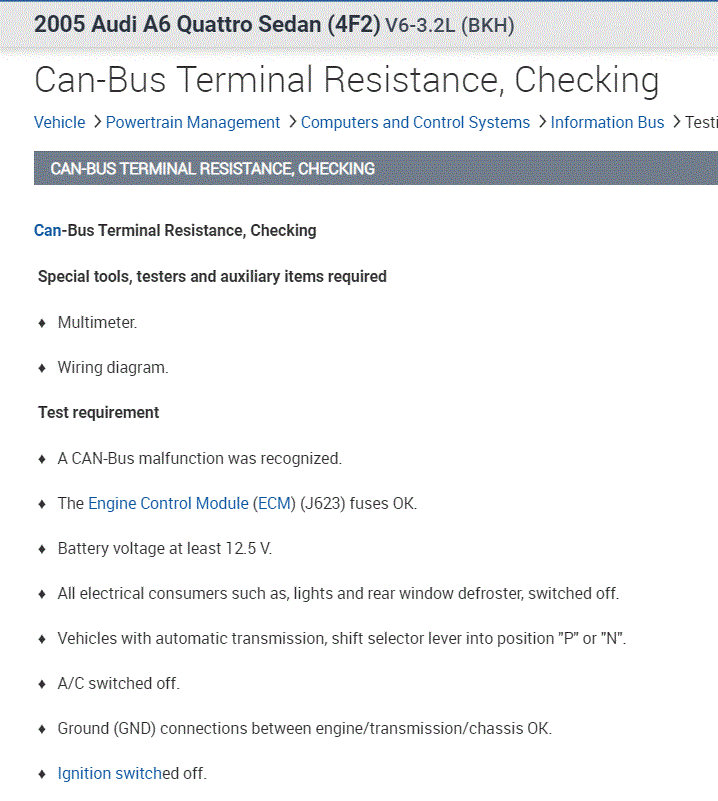

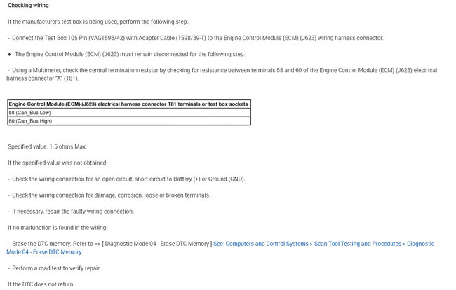

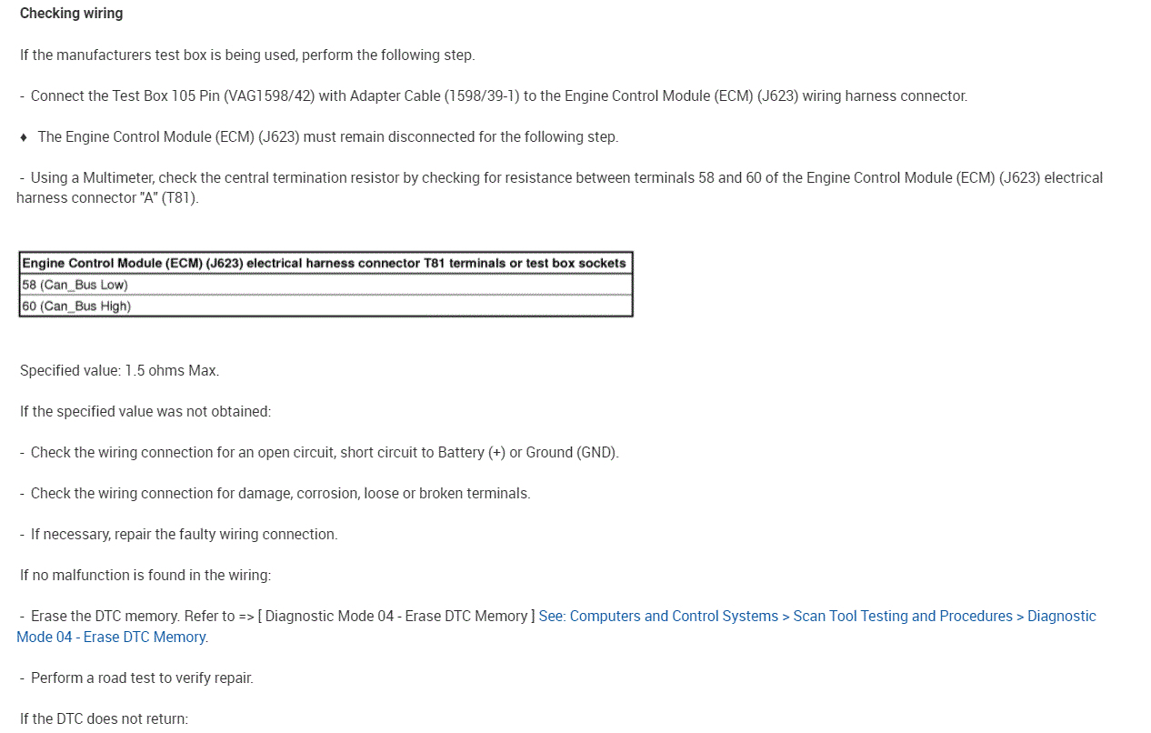

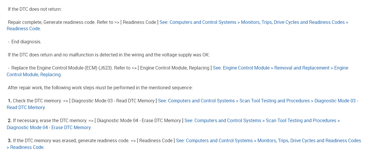

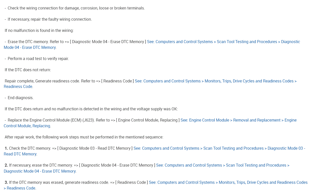

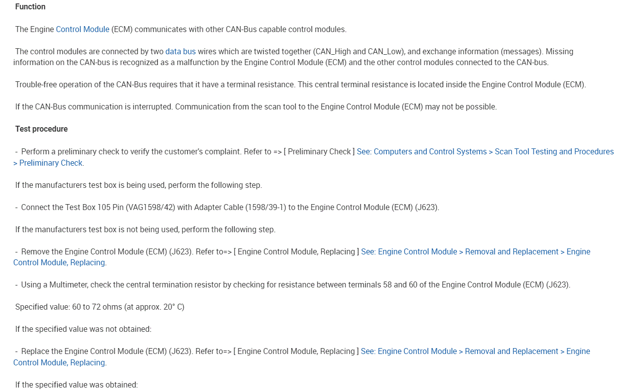

That's it. Take a look through the attachments below. They are the description and test procedures for it. Let me know if you are comfortable doing it
Mar 12, 2022 at 2:06 PM
BOSSD1
  • 15 POSTS

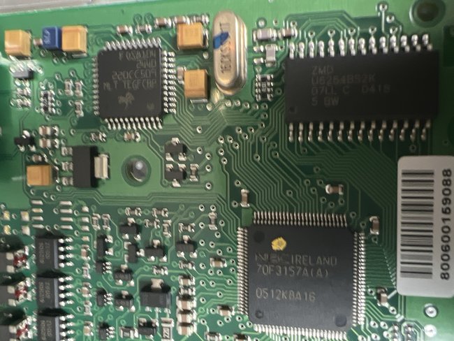

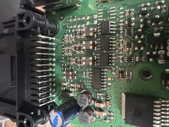

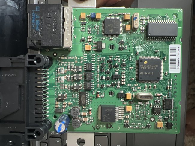

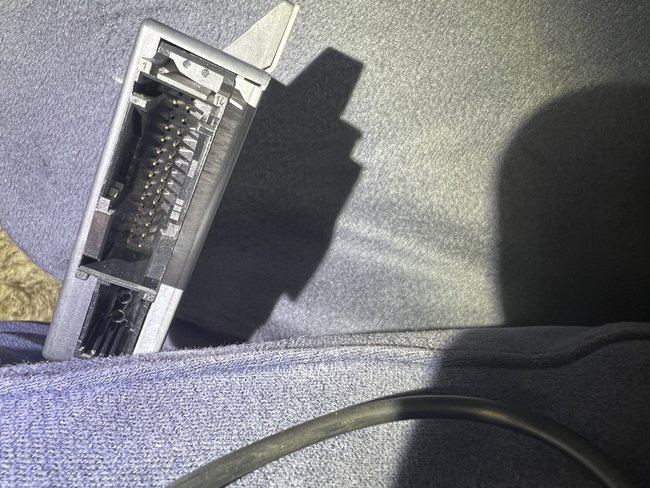

How do I locate central termination resistor ? Is it the pins? There is only 26 pins do I have to open it up?
Mar 12, 2022 at 10:53 PM
BOSSD1
  • 15 POSTS

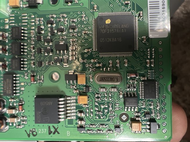

I have opened it up.
Mar 12, 2022 at 11:09 PM
  • 110,244 POSTS

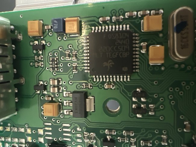

I have no schematics for the circuit board. As far as the termination resister inside it, I have no way to locate it. I'm sorry about that.
Mar 13, 2022 at 8:43 AM
BOSSD1
  • 15 POSTS
Not sure what I'm looking at, could you point out from the images what needs to be tested? or do i just go and purchase a new part?
Thanks
Mar 13, 2022 at 8:45 AM
  • 110,244 POSTS
The test procedures I listed above are what a shop would use for testing. That's what I have. Take a look at them and let me know if you understand them.
Mar 13, 2022 at 9:22 AM
BOSSD1
  • 15 POSTS
i do not understand them unfortunately.
Mar 13, 2022 at 9:23 AM
  • 110,244 POSTS
Basically, they explain what to test for excessive resistance. It's hard for me to explain via the internet, without being there.
