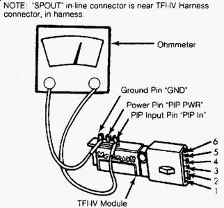

AGENTUNO
  • 1995 FORD MUSTANG
Electrical problem
1995 Ford Mustang V8 Two Wheel Drive Automatic 123, ++ miles
This Vehicle dies at any time idle. Warm, cooled at any rpm it has no spark no one could get codes. I worked on it for hrs. Finely got some codes (212) SPOUT look it up. ( Ground between EEC lV and TFI lV my question is where is the TFI lV and what is a TFI lV thank you for any help you can give
Friday, June 26th, 2020 AT 11:19 AM (Merged)
MERLIN2021
  • 17,250 POSTS
TFI is the thick film ignition module, it's attached to the distributor, it's the part the harness plugs into, and it is probably the faulty part, remove it, take it to the parts stor, they can test it befroe you buy a new one. It looks like this:
https://www.2carpros.com/forum/automotive_pictures/62217_ec_2.jpg
