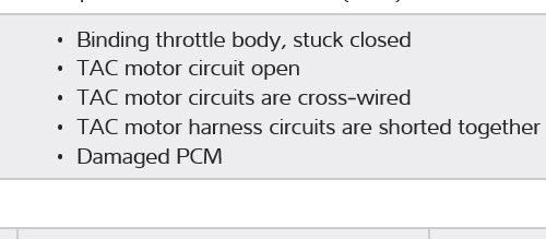

I have the car listed above with an Edelbrock supercharger. I slipped a rod put a hole in the engine block and had to replace the engine. I did so, and now when I attempt to start the car it will not stay running for longer than two or three seconds. My engine light is on and keeps giving me codes.
My codes are:
P0223
P2104
P2111
P2112
P2135
Can anyone help me to resolve this issue?
Dec 27, 2016 at 12:58 AM
HMAC300
  • 48,601 POSTS
these codes all deal with throttle position sensor and throttle actuator control. one says stuck open and the other says stuck closed. try cleaning throttle plate on both sides with choke cleaner. it may be due to you blowing engine up partly or throttle plate is binding or wired wrong somehow. see picture for causes. you might try erasing codes and see if it straightens out.

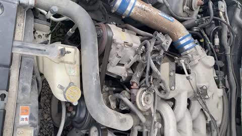

Does the security light flash while you are cranking the engine over? Can you please shoot a quick video with your phone so we can see what's going on? that would be great. You can upload it here with your response.
This guide will help us get started fixing it:
https://www.2carpros.com/articles/engine-stalls
Jun 26, 2020 at 4:17 AM (Merged)

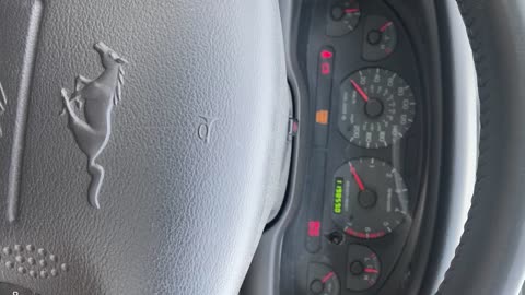

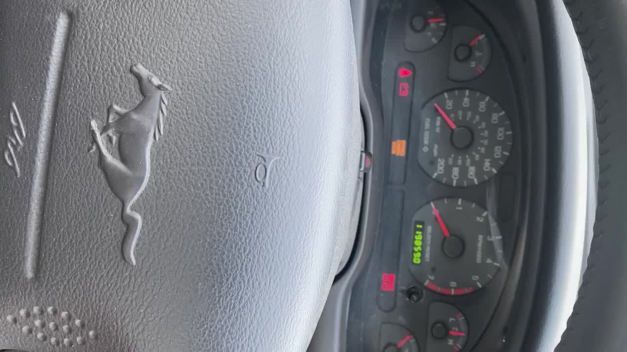

JW MUSTANG02
  • 7 POSTS
No the security light does not flash. I have uploaded a video of me starting it.

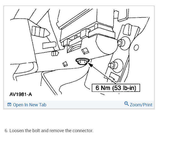

  • 55,423 POSTS

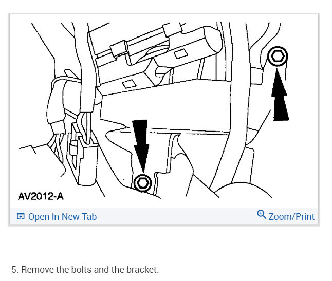

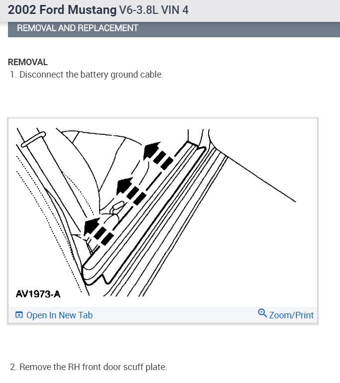

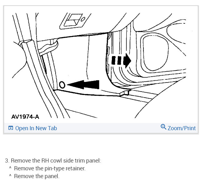

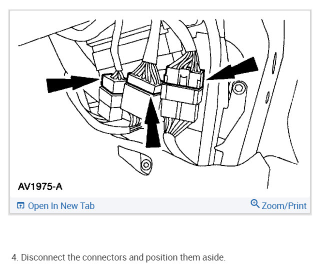

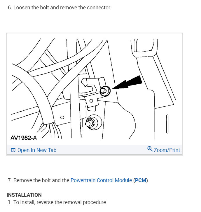

If there are no codes it sounds like the PCM is bad. When it shuts off can you turn the key off and then it starts again and does the same thing? Also can you here the fuel pump running when the engine stalls? if so I would try a used PCM here is the location and how to change it out. Check out the diagrams (below). Please let us know what happens.

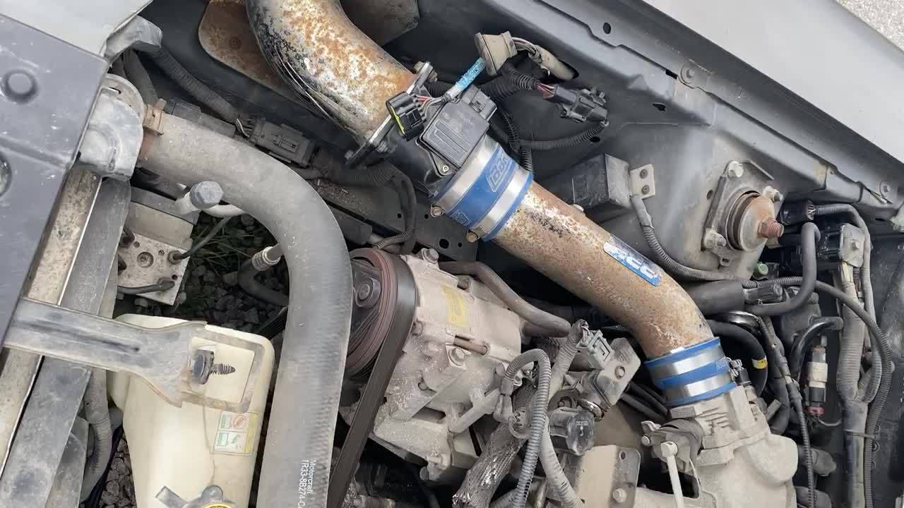

JW MUSTANG02
  • 7 POSTS
I unplugged the airflow sensor now it purrs. I just cleaned the reusable filter last fall. Do you have any ideas as to what else would cause these problems. Now that I have unplugged it I have the engine light on and my code reader is picking it up as well. Codes P0113 and P0109. However I got nothing with it plugged in. Could it be just a bad sensor?

STEVE W.
  • 15,348 POSTS
MAF being bad would usually cause it to revert to stored settings like it does when you unplugged it. However it could be shorted and dropping the 12 volt power out so the PCM shuts down to protect itself. You can check that with a voltmeter and a couple of connections. First go to the EVAP purge valve in the engine compartment, it should have light green with black stripe and red with yellow striped wires. Unplug it and probe the red w yellow wire. With the key on it should have battery voltage as it is a power feed for this and other components including the PCM. Plug the MAF in and see if the voltage drops. Next find the TPS on the throttle body, it should have Brown w white, Gray w white and a Gray w Red wires. With the MAF unplugged probe the Gray w Red wire. This is the sensor return AKA ground. It should have very close to zero volts on it with the key on, does it change when the MAF is plugged in?

STEVE W.
  • 15,348 POSTS
MAF rate 0 g/s isn't a good sign. If you shut it off, then restart does that change? How about if you rev it up? If no or very marginal change it is likely a bad MAF.
JW MUSTANG02
  • 7 POSTS
I replaced the MAF now she starts up and runs just fine. Thank you for your help.

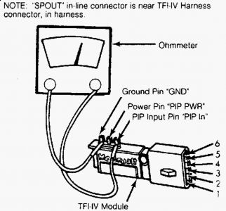

AGENTUNO
Electrical problem
1995 Ford Mustang V8 Two Wheel Drive Automatic 123,++ miles
This Vehicle dies at any time idle.warm,cooled at any rpm it has no spark no one could get codes . I worked on it for hrs. finely got some codes (212) SPOUT look it up. ( ground between EEC lV and TFI lV my question is where is the TFI lV and what is a TFI lV thank you for any help you can give
Jun 26, 2020 at 4:19 AM (Merged)
MERLIN2021
  • 17,250 POSTS
TFI is the thick film ignition module, it's attached to the distributor, it's the part the harness plugs into, and it is probably the faulty part, remove it, take it to the parts stor, they can test it befroe you buy a new one. It looks like this:
