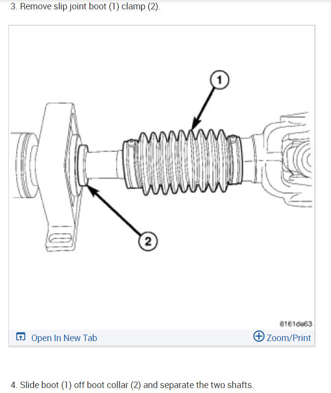

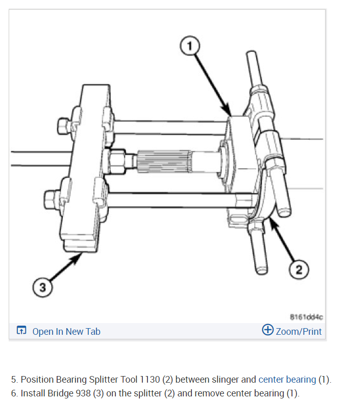

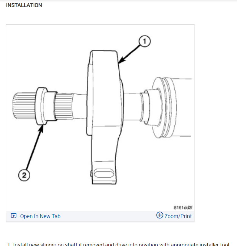

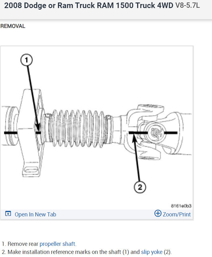

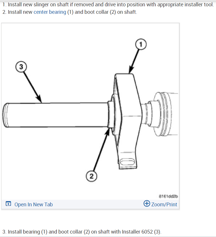

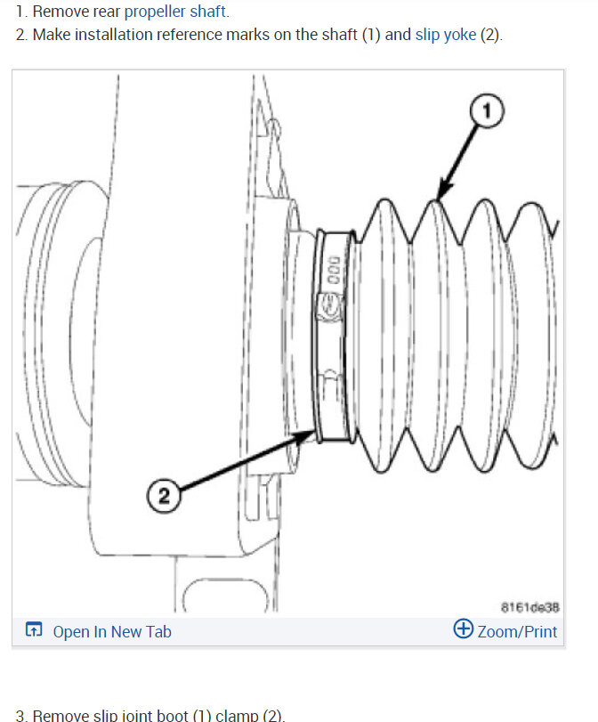

Yep, the carriage or center support bearing can make this noise. Here is how to replace it in case you need it. Check out the images (below). Please let us know what happens.

We do not have a carrier bearing . Its a one piece drive shaft.
Oct 22, 2024 at 4:02 AM
  • 55,721 POSTS
Okay, I guess that was for the long bed. What did you mean by the "carriage bearing" ?
