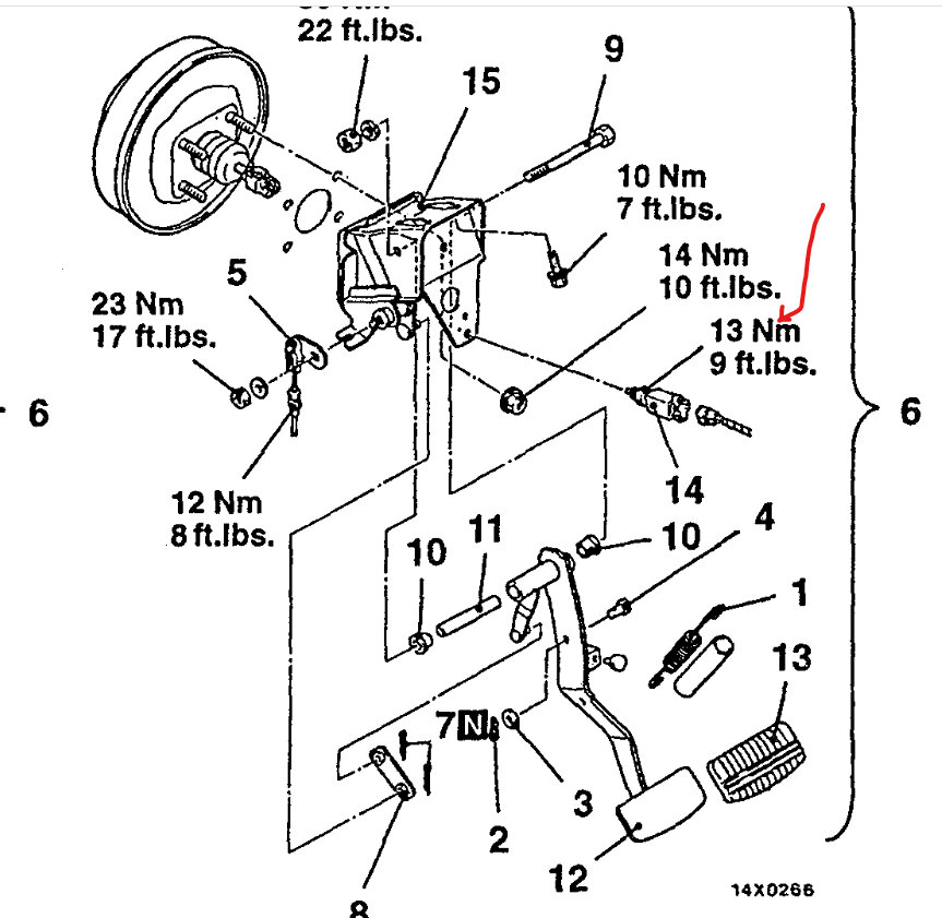

Mitsubishi Eclipse 97 - 165000 miles - Break lights are always on, even when I turn off the car. What do I do?
Saturday, September 8th, 2007 AT 6:25 PM
MERLIN2021
  • 17,250 POSTS
Follow the brake pedal to the switch, push the switch in some then pull up on the pedal to set. Here is the location of the switch. Check out the images (below). Let us know how it goes
