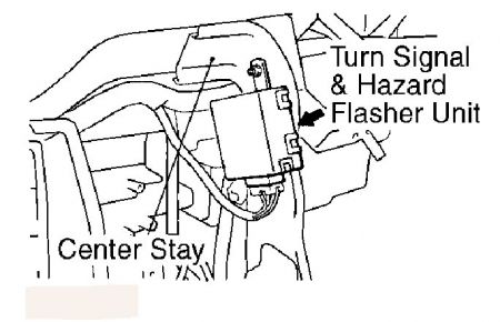

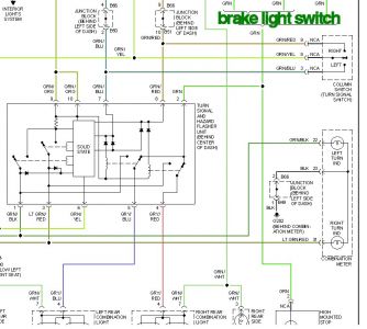

Behind the center of the dash is a flasher unit that the power branches off from the brake light switch. One branch continues to the 3rd brake light that works, and the two "combination" lights are powered off the second branch that goes through the flasher unit. Based on this I would be most suspicious of the flasher unit, but you can test for power to prove it or try the flasher.

Tha Hazard lights do Blink.
But I will check the unit with my volt meter.
I will let you know what I find.

Looking at your diagram and the Hazard unit under the dash.
The unit under the dash has 1- black wire(Ground),
1- Green/Orange strip wire that shows 12 volts only when the Hazard switch or the turn signal switch is turned ON. and 1- green/Yellow strip wire that only shows 12 volts as the unit clicks.
There is only the 3 wires. Your diagram shows ten wires pluged in to it. Is this the same as mine.
Plus if the Hazard unit is clicking and producing power, Isn't it OK???
I'm stumped with this issue of the brake lights not working and I appreciate you taking the time to help me.

This diagram "should" be yours. Experience tells me "should" is not always "is". Being a service writer, I research and provide info. Sometimes it makes sense to me and other times I feel as though I should be able to logic it out. This is one of those that I wish I could go to the next step. Electrical is not my strength. I see what your saying, but can't provide the answer.
There are some excellent Mods that may be able to jump in on this. If not, browse through the staff site and send a PM to one of them. My guess is that 2carproJack or Razmataz may join it. Both can take you further.
The clicking means the relay is switching. The green/yellow does come from the turn signal switch and the ground is also common on this. I wish I could provide more help.
