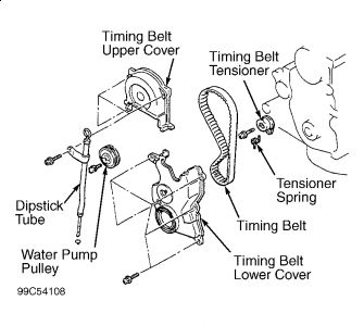

Have you checked to see if the timing belt isn't broke? If not then first remove the distributor cap and see if the rotor turns if not then pull the upper cover to the cam and see if the belt is broke. Here is a pic to help with belt inspection.
https://www.2carpros.com/forum/automotive_pictures/249564_Graphic_172.jpg

I think I covered the timing belt in my question when I said timing was good.

No it isn't covered now. It may have been when it was running but now it isn't so you must go back to basics first so you don't miss anything. Now I need to know if the distributor is turning. So if you would remove the distibutor cap and see if the rotor is turning. I never assume anything without making sure. So please check and let me know ok. If the distibutor is turning then put the cap back on and remove a spark plug wire and put a screwdriver in the end of it and put it near metal and see if there is spark. Let me know what find. Thanks.

I removed the timing belt cover and checked the timing and belt all was good or maybe I should say (is) good. The Distributor is turning and when I installed I double checked TDC rotor button location too. So I know all of that is correct.
